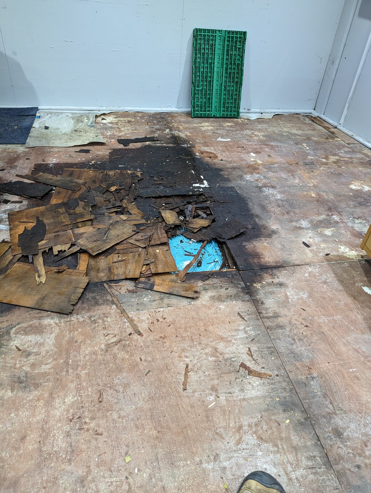

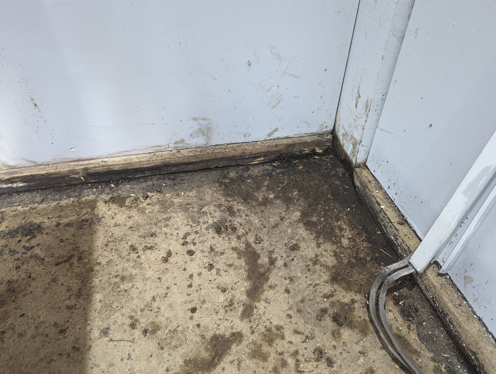

The time has now come after 18 months! On moving all the furniture out of the area and removal of the lino, I discovered that the whole floor area was rotten:

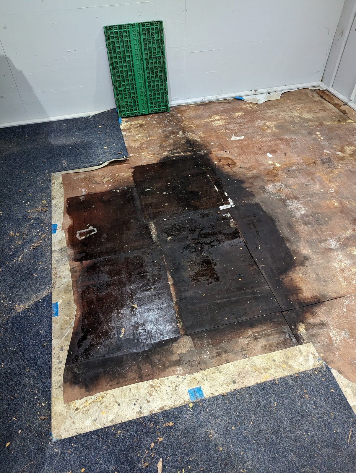

I have now removed half the overall floor are down to the concrete:
This has revealed the following:
  • A concrete base with unknown construction underneath on the natural clay. It is substantial as on the outside I can see about 400 mm of depth, and it looks like the base have been used to take out the gradient of the sloping garden. The slab is level on the surface.
  • The shed has been constructed straight off the concrete with four substantial uprights (look 6” x 6”) straight onto the concrete (rested) with 6” x 2” frame between directly on the concrete. Externally the frame is cladded and internally finished with plywood boarding. I was told that there is insulation, but I haven’t confirmed this. The roof is a large plastic type of structure in good condition with a good fall to rear guttering and a large overhang all round. There is a large set of bifold doors on the front with an integrated door to the side.

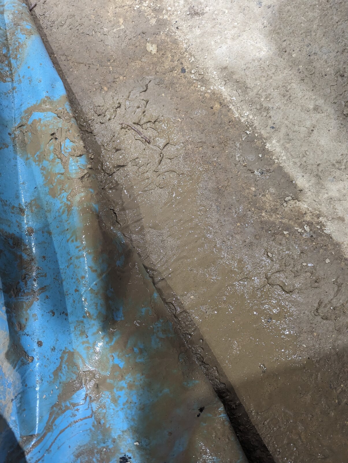

  • A blue plastic DPM layer laid on top of the concrete. Underneath was soaking wet with water and network of roots across the whole floor probably coming from the two large mature Maple trees about 500 mm from the external side wall and the other at the front corner.
  • Previously applied bitumen paint around the edges, looks like an attempt to stop water ingress.
  • 1” x 2” wood battens had been screwed into the concrete floor through the DPM layer to provide a base for the 18mm plywood flooring.
  • A layer of lino was on top of the plywood followed by my tiles.

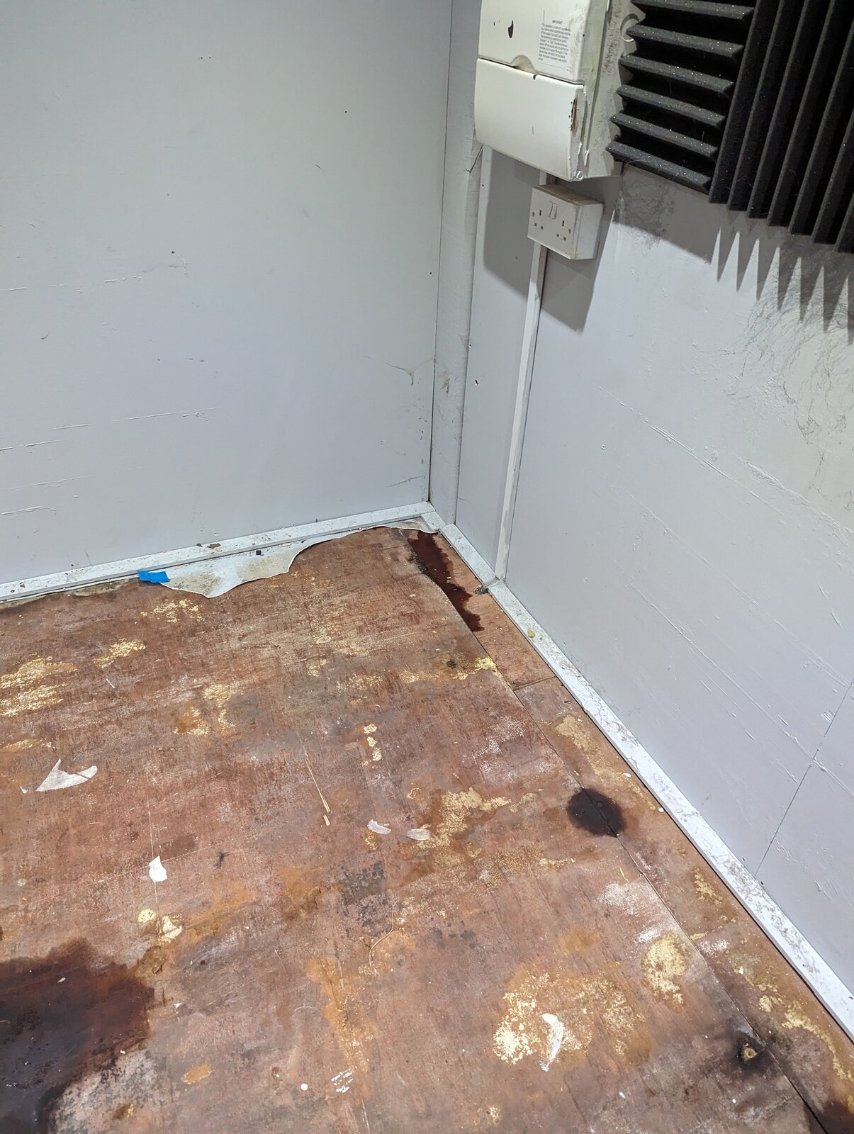

  • The water seems to be worse in the corner pictured may because of a slight fall on the concrete to this corner rather than an entry point for external water. Water has then entered the battens through the screw holes and from the edges of the DPM.

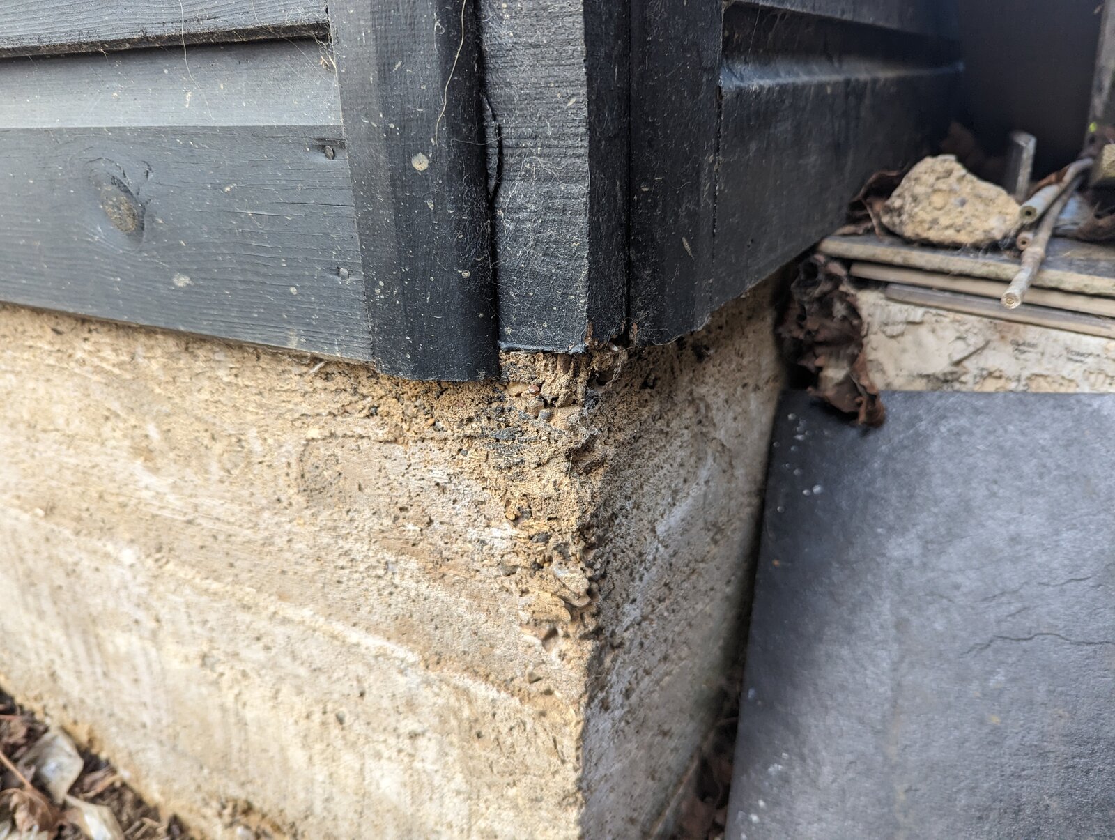

  • The floor battens and plywood are all damaged by rot. The building frame is damaged along the wall and the corner upright is significantly rotted.
Obviously, I need to find out where the water has come from. My guess is a combination of slab sweating and condensation plus maybe some ingress from outside? Then what do I do to fix it. My main worry is whatever I do I am constrained by the structure being built directly on the concrete. Thoughts so far are:
  • Use resin to repair the rotted upright base and the worst of the rot in the frame along the outside floor.

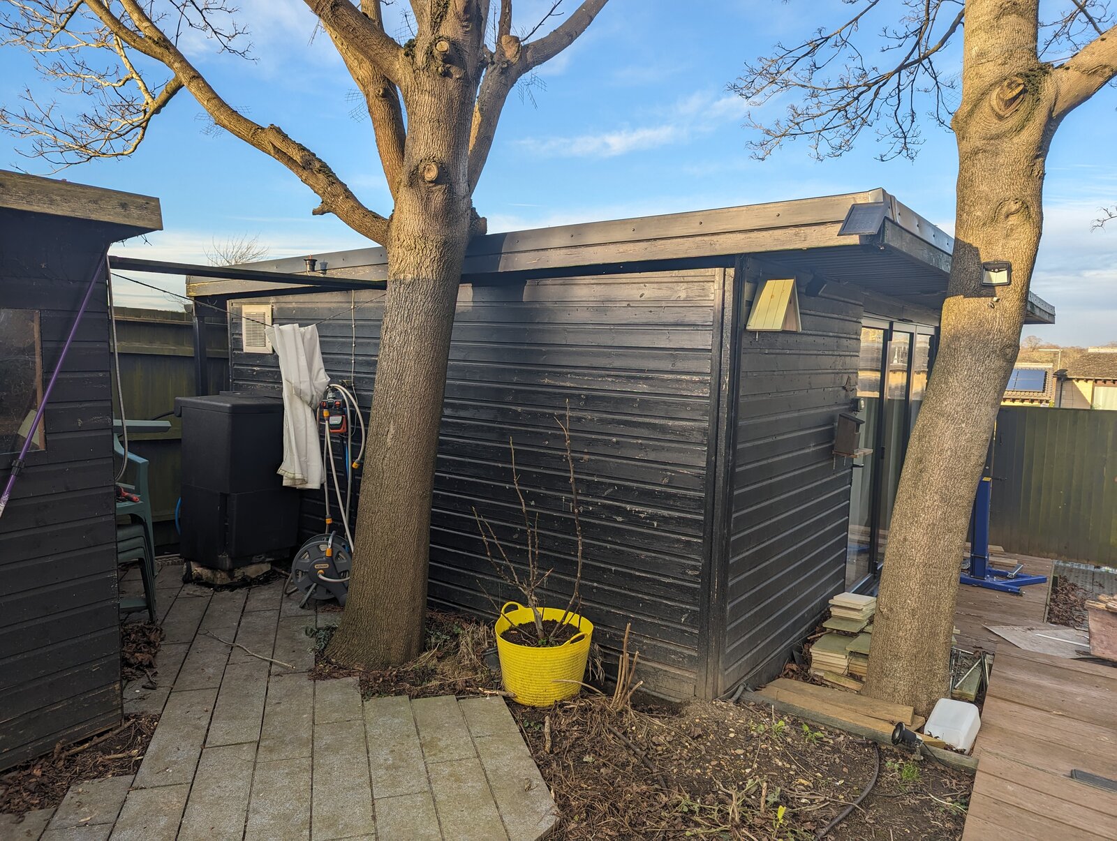

if you have a few outside pictures from further back showing the whole structure that would be very informative.
Personally I would say if the concrete floor slab is solid, level and not cracked you could clean it up, lay self level to get it perfect if needed, put down a DPM or paint a liquid one on, put down 50mm celetex, tape all joints then fit chipboard flooring waterproof grade.
the frame can be cut out and repaired where required, but you need to solve the damp ingress so will need to know the existing detailing to suggest a way forward

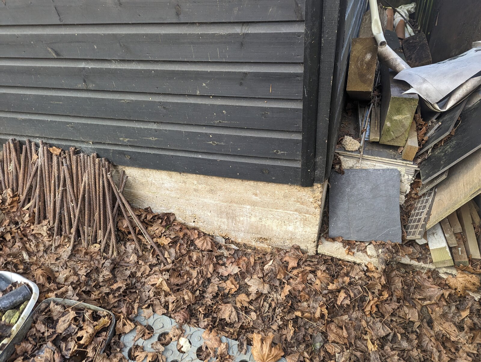

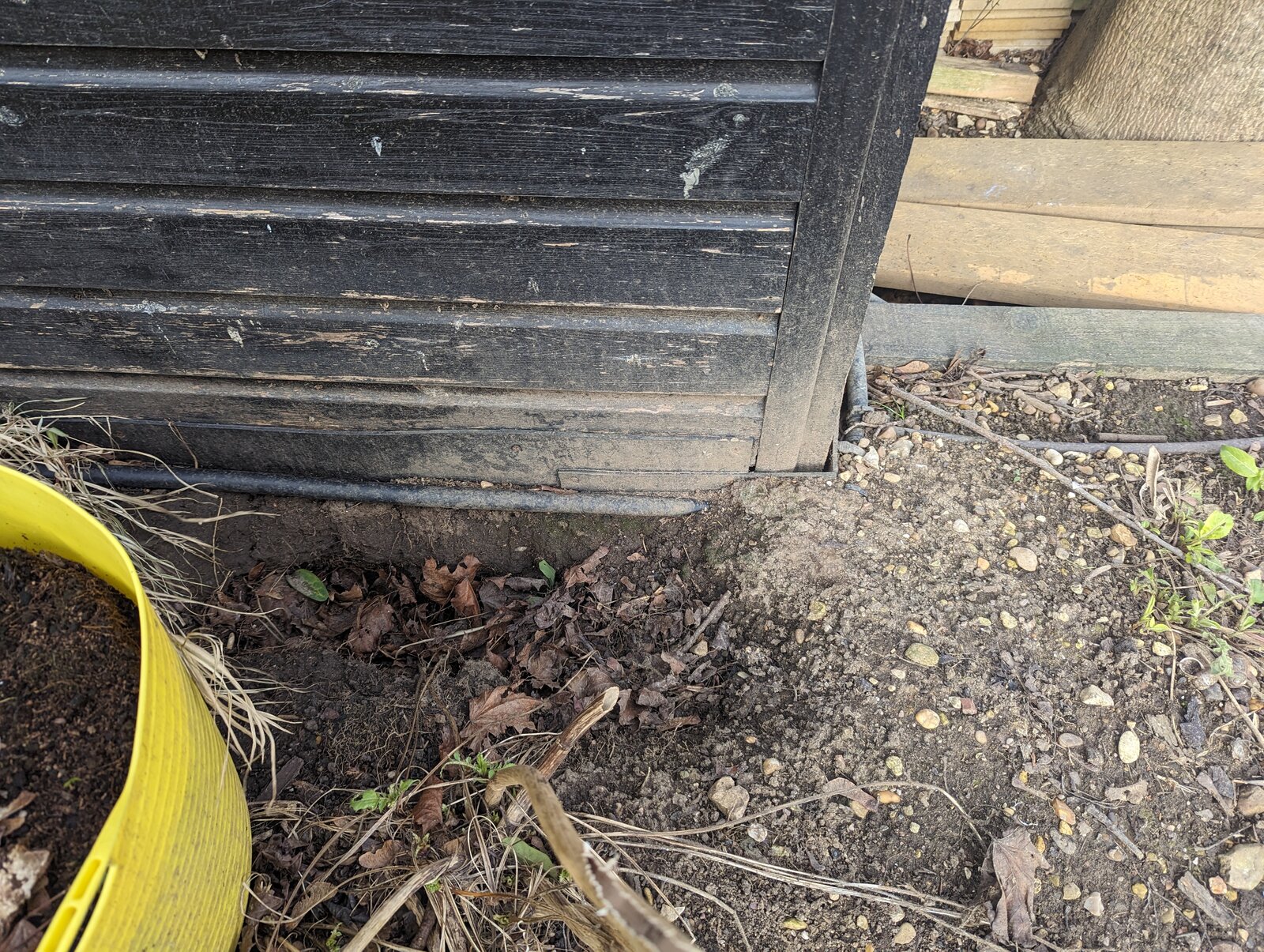

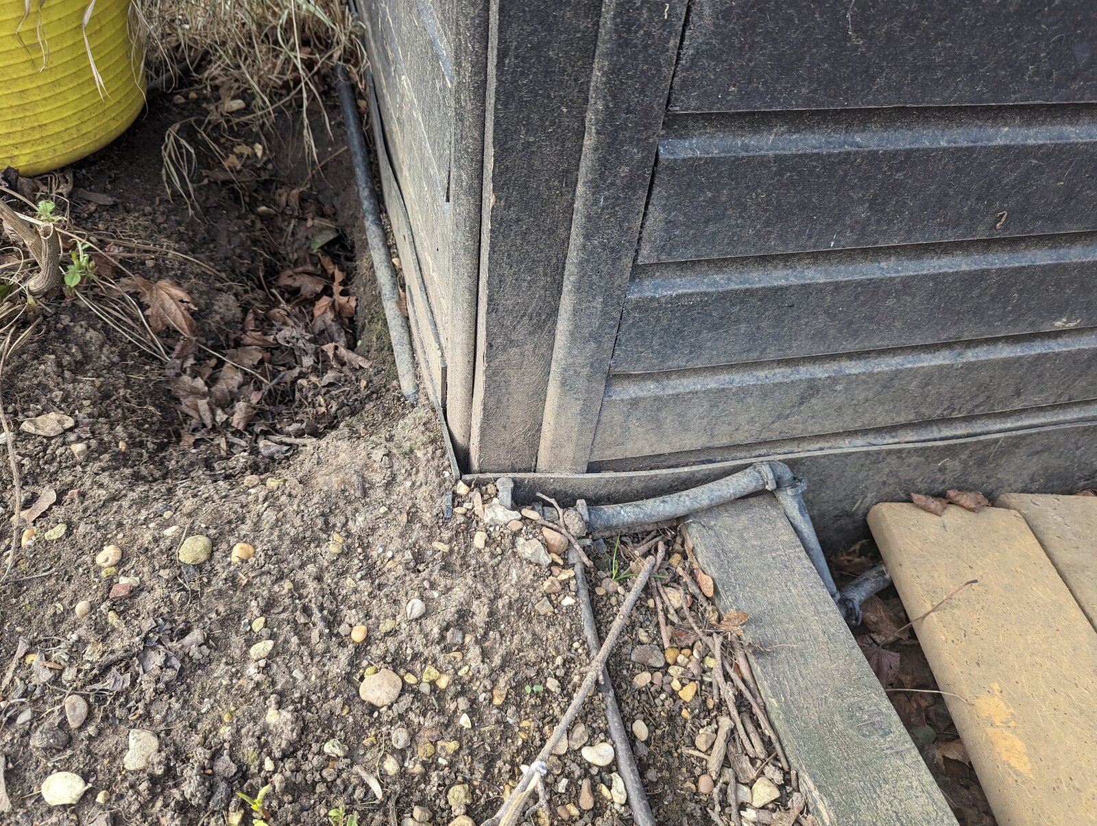

Cheers. Added some more pictures below. From what I can see the frame is just resting (or screwed) directly on the concrete base. There is a cavity between the exteral and internal walls but I am not sure whether it is filled or not.
The punctured DPM is the likely culprit, but the detailing around the edges might not be helping.
Follow the suggestions above.
Also check the fall on the roof and that the guttering is working as it should, make sure the water butt isn't full and overflowing onto the structure.
Might be worth digging out all the way around and putting down shingle, just increase the gap between the ground level and the cladding, so that it looks more like the last picture and less like the middle two pictures.
