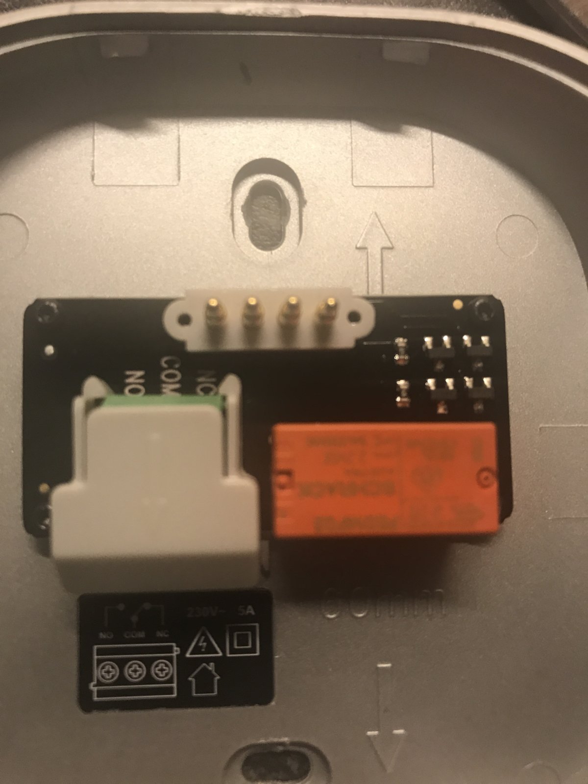

I am trying to replace the thermostat but I am struggled with the wiring I need to know which is NC, NO and COM. Fitting a smart thermostat. Here are is a Picture of my old one. wire is going into 1 and 3
I am try to fit a Somfy connected wired thermostat.Here is a pic of the new one inside.

1 should be com and 3 should be no, it wont make any difference to your new stat id they are the other way round as your new stat just connects them both.
