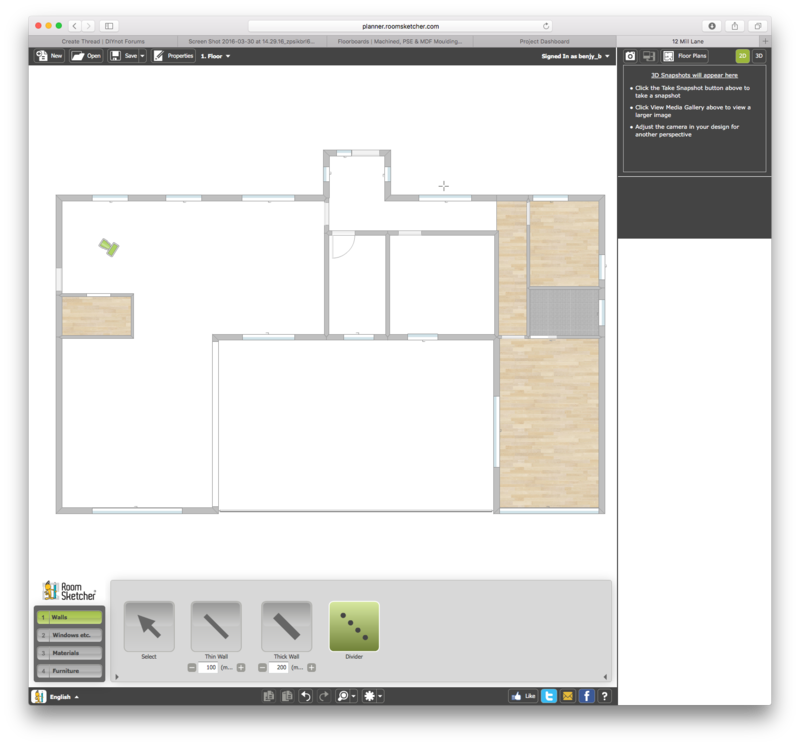

My girlfriend and I are carrying out a substantial renovation to the "west wing" of our bungalow. This will involve insulating below the floor and replacing the chipboard subfloor.

We're considering using Softwood, but with an intention to lay a floating wood/laminate/engineered wood floor over the top. However, my girlfriend has her doubts about the high cost considering it would be something that will not be seen.
The size of the area is 30.79 sqm.
Our joists are 75x220mm with 400-450mm centres.
Here is a picture of our floor plan. You can see the "west wing" on the right. We plan to fit our en-suite/wet room (the grey tiled room) with aqua board at the same time.
With regards to insulation, we like the idea of sheepswool suspended in a netting.
How would I go about calculating the optimum thickness to achieve a U value of 0.25?
