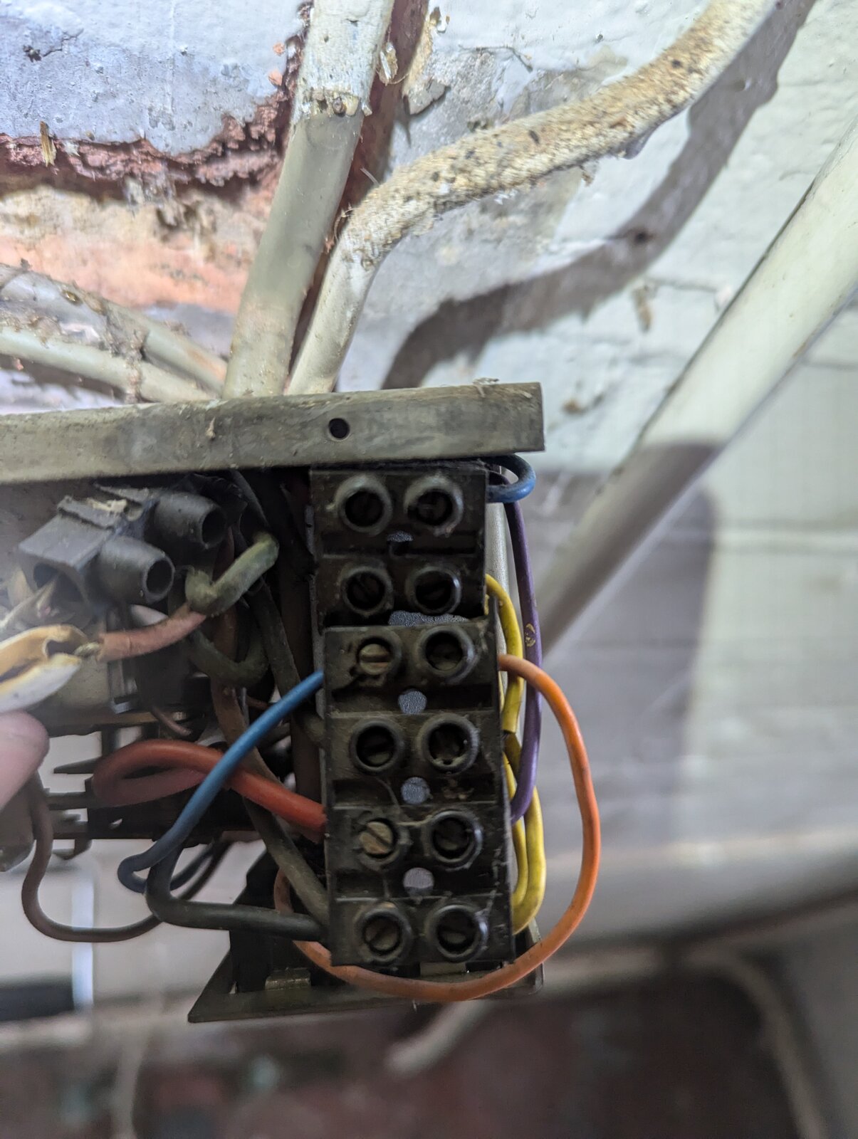

Hi,
I am trying to install a hive receiver & thermostat to replace an old mechanical timer connected to an old trianco redfyre 28/32 oil boiler.
Upon untangling the mass of wires contained in the old timer I am left with the following:
[FONT=arial]Mains feed from switch[/FONT]
Feed to boiler - twin and earth
Feed to pump - twin and earth
Feed from tank thermostat - twin and earth feed
from old thermostat - hopefully now redundant.
I don't suppose anyone could assist with how I can wire all this together into the hive two channel receiver please. Also note there are no motorised valves.

As they say, a picture is worth a thousand words.
Can you show us the wiring behind the old timer and thermostat, and let us know what models they are?

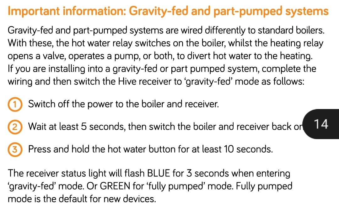

It sounds as if you have an old 'gravity' heating system. Did the hot water also come on when heating was selected?
If so the Hive receiver should be put into 'Gravity' mode.

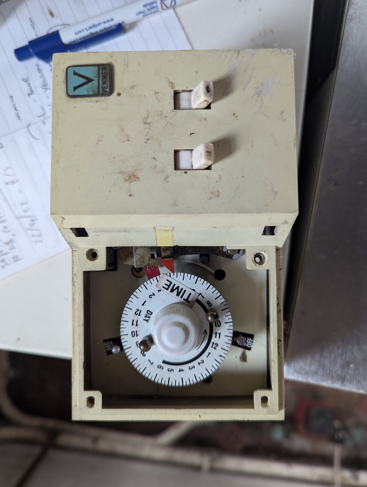

Hi,
Please see below for thermostats and timer, not sure on models.
Yes I believe it is a gravity system as the water had to be on to run the heating.
Steve

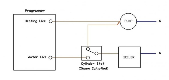

Usually it is possible to find information on the previous programmer and simply map the wires over to the new one.
In your case it appears that you have an AMF Venner programmer, and the wiring information that I've found doesn't seem to match yours...
However, I believe a gravity system with a tank stat should be wired something like this (from a post by @stem )
If this maps out to your existing wiring, A dual channel Hive receiver should be a straightforward swap - just ignore the room stat connection and connect terminal 4 of the Hive to the pump L and tank stat satisfied.
Not forgetting to put the Hive into Gravity mode...
It may also be worth checking the power of your pump - the Hive is capable of switching 3A resistive load, or 1A inductive - a pump motor is usually an inductive load.

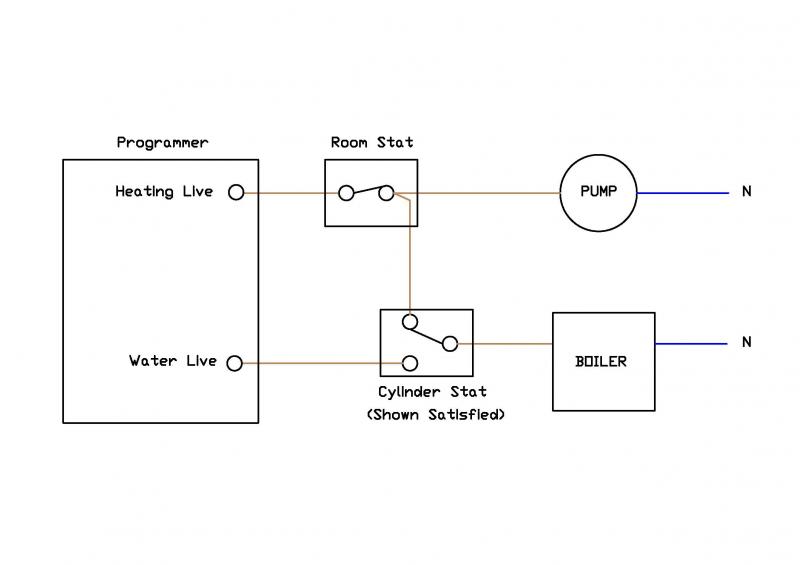

Based on the diagram below:
Hive terminal 3 "Hot Water ON" corresponds to - Programmer "Water Live"
Hive terminal 4 "Heating ON" corresponds to - Programmer "Heating Live"
You will also need to provide a N & L to the Hive from the 'Main Feed' to provide the Hive with operating power.
As you are replacing the room thermostat with Hive, the wires originally shown below going to the Room Stat, would simply be joined together.
However, you have incorrectly shown this:

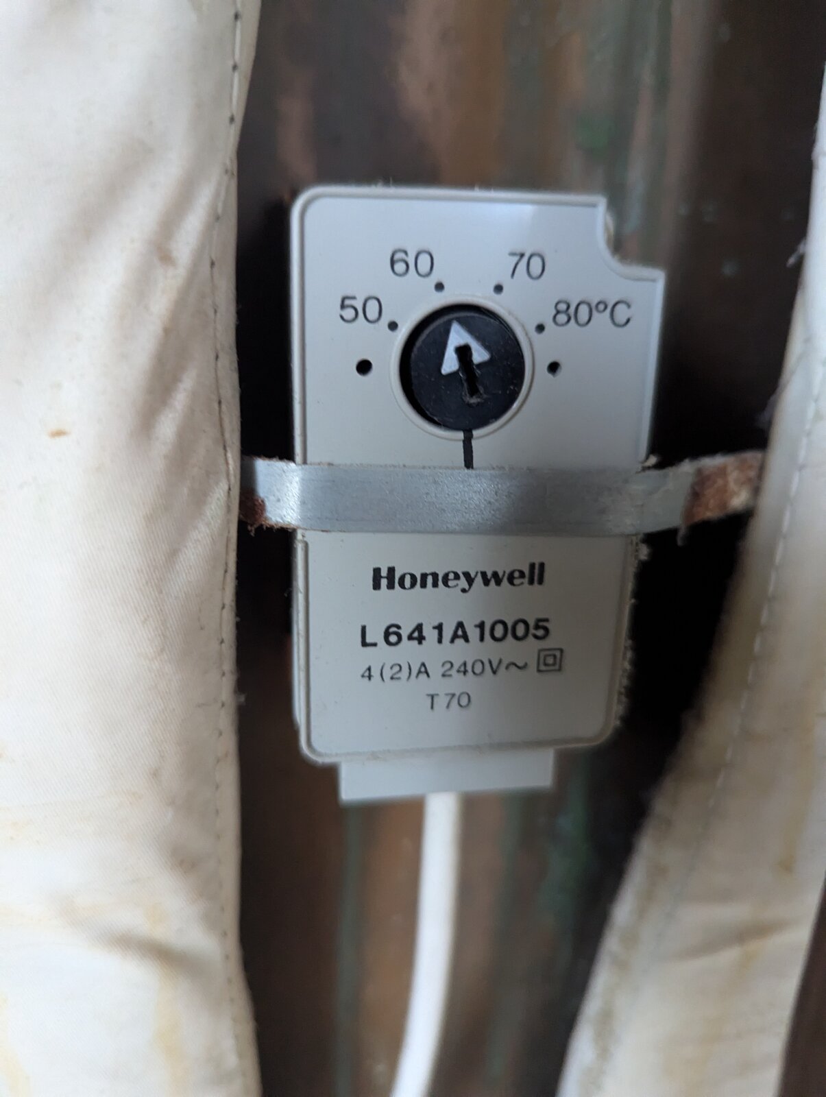

A Hot Water Cylinder Thermostat is a switch and does not have E L N connections
I believe it will correspond to the below:
If it does:
C Goes to the boiler L
2 Goes to the pump L
1 Goes to Hive 3 Hot Water ON
If it doesn't, post details of the thermostat wiring terminals.
