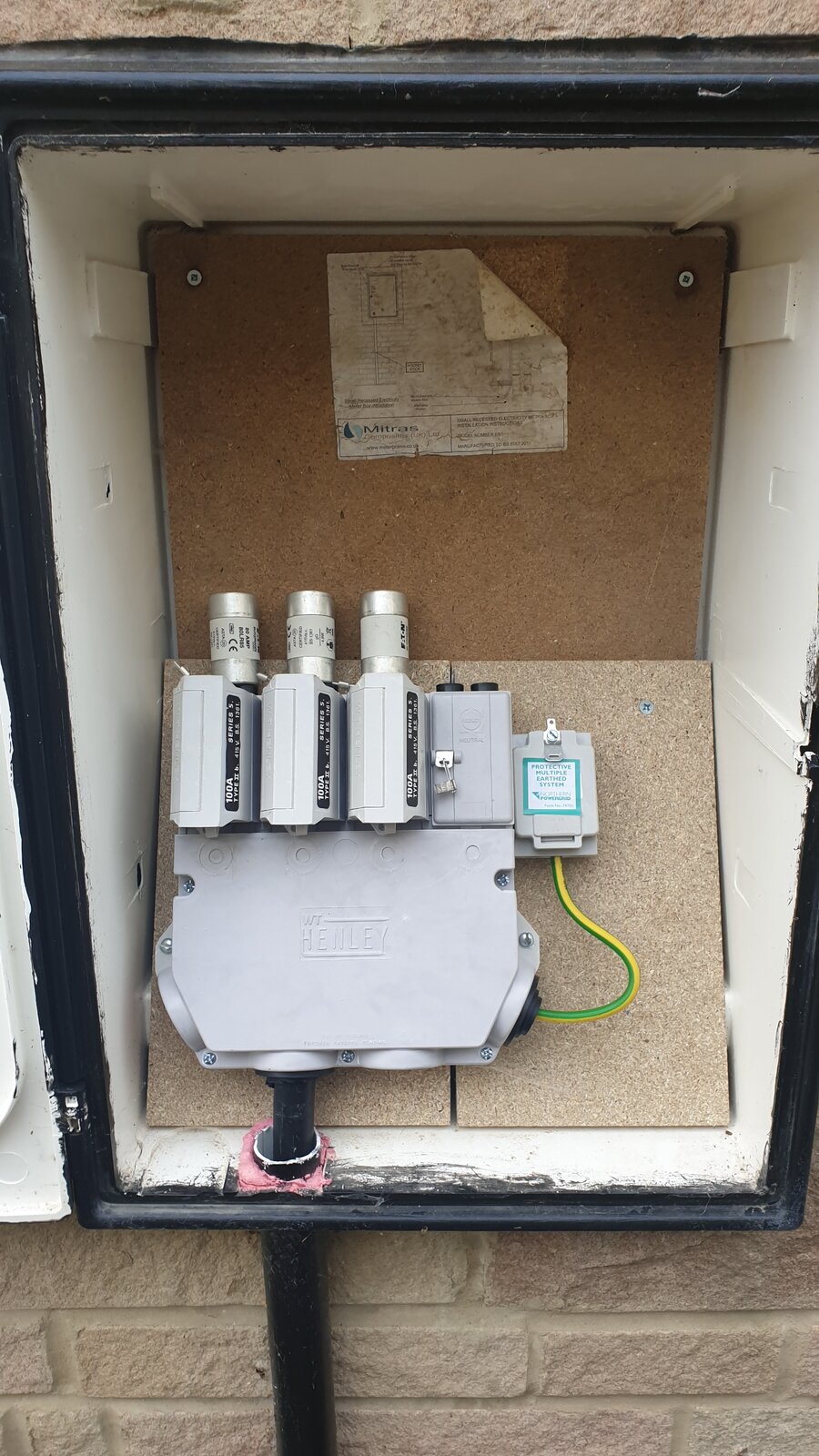

Sorry to hijack the thread :LOL: but thought I would update on my OP...
EON came out today to fit the 3 phase smart meter only to tell me they could not fit into a single phase box.
This is after both Northern Power Grid and EON had told me it should not be a problem.
Also after me discussing on numerous occasions with EON over the last month including sending them photo's and measurements etc.
They also refused to fit the meter on the other side of the wall stating is was against the rules to have the cut out in a different location to the meter.
When I told Northern Power Grid they said that that was rubbish and they had other meter fitters who did it and if I wanted the cut out moving it would cost in the region of £600.
I then spoke to a technical guy at EON who said fitting the meter on the opposite side of the wall to the cut out was a definite no no and that NPG should not have fitted the 3 phase cut out into a single phase box and that NPG should be correcting the issue FOC.
These are the options that have been suggested.
1. Have the supply disconnected and remove the recessed single phase meter box and replace with a 3 phase box at great expense to myself.
2. Disconnect the supply and replace the cable with a longer one that will go up into the current single phase box and then through the wall into the garage into the cut out.
3. Take tails from the NPG cut out through the wall into a red link cut out and then EON will fit the meter.
The latter seems the easiest option?
Has anyone had any experience of something similar or any independent thoughts on this issue?
Mark.

My first reaction, without thinking too deeply, was that it seemed daft that they (EON) would be prepared to do that (given what they are not prepared to do) but, on reflection, it's probably a safety issue - since it means that people working on the meter can see the cutout (a cutout) and therefore be sure that no-one has re-energised the installation whilst they were working.
However, I presume that NPF would have to "take tails from the NPG cut out through the wall into a red link cut out" - and, if so, are they prepared to do so, and at what cost?
I'm a bit confused by ...
... followed by ...
How do "FOC and "at great expense to yourself" fit with one another\?
EON guy said it was changed due to historical flats having all cut outs in the one place and as you stated people re-energising the system accidentally while the engineer was working in a different room. You would have thought they would just introduce a locked system so it was impossible to re-energise without the key / code.
Not sure yet as I have yet to put this option to them.
Option 1 was what NPG initially proposed and they said it would cost approx. £600, this conversation happened before I spoke to the EON technical guy.
Option 3 is what the EON guy suggested and he said NPG should be sorting it out for free as what they have done is not legally serviceable.
He was not very complimentary about NPG in general and said they were working to outdated regulations which were causing issues on many sites and he did seem to know his stuff.
I'm just really frustrated as I raised my concerns to numerous people at NPG before they fitted the cut out and also to EON before they agreed to fit the meter and now they are both blaming each other with me in the middle.
However the EON guy has offered to speak directly to NPG if I have any problem getting them to sort it out so I am grateful for that.
I'm just hoping NPG agree that they have messed up and it does not drag on as I was hoping to have some electricity for light and heating now that winter is on its way.:(
However the EON guy has offered to speak directly to NPG if I have any problem getting them to sort it out so I am grateful for that. ... I'm just hoping NPG agree that they have messed up and it does not drag on ...
Such a conversation between E.ON and NPG might help. I have to say that I'm not sure that I necessarily understand what is being said about "putting (or not!) a 3-phase meter into a 'single phase box' " ...
.... a technical guy at EON who said fitting the meter on the opposite side of the wall to the cut out was a definite no no and that NPG should not have fitted the 3 phase cut out into a single phase box and that NPG should be correcting the issue FOC.
.... a single-phase cutout wouldn't be any less tall than your 3-phase one, and I can't see any sort of meter fitting 'beside' it, so even a single-phase meter would probably have to go above the cutout - and I don't see any fundamental reason why a 3-phase meter necessarily has to be any taller than a single-phase one (although there will obviously be variations between makes/models).
Kind Regards, John
Kind Regards, John
I think I have to stick my oar in here and say in my experience 3ph meters used tend to be taller than single phase. However I've seen a number of 3ph cutout/meter combos fitted in 'standard meter boxes' without problems, including rotating wheel versions.
One has also to consider the position of the cutout in the meter box, I've seen them right up near the top, effecticely using up half of the available width
I think that 3-phase ones generally tend to be taller than single=-phase ones (my 3-ph one is certainly fairly 'tall'), although I'm not sure why. However, I've certainly seen some 3-phase ones which aren't very tall at all. Maybe E.ON are only prepared to use 'their usual' one?
True, but in the OP's case we know (pic with post#21) that the cutout is about as near to the bottom as it could be, hence leaving all of the top half of the box for a meter.
Kind Regards, John
Just to clarify it was not that EON refused to fit the 3 phase into the box, it was that it would not physically fit above the cut out.
The installer from EON tried to place the smart 3 phase meter that they fit into the meter box but it was simply too tall due to the extra bit at the top that contains all the "smart" stuff.
He even showed me what I believe was a standard "shorter" 3 phase meter and although this fit above the cut out it only left minimal room for the cables.
However I can't remember if he tried to fit it above and to the right of the cut out so I'll have to investigate this.
I'll add looking for a different meter to my list of possible options as EON may be willing to fit even if I have to supply it. (y)
Upon looking at my photo (re-attached to this post) it looks to me that they could have placed the cut out lower by 50mm or so?
The actual space available is 340mm wide by 250mm high which makes me wonder if they could fit the meter on it's side?
I'll be adding both of those to the list of potential options.
Thanks JohnW2 and SUNRAY for your help.
Mark.
