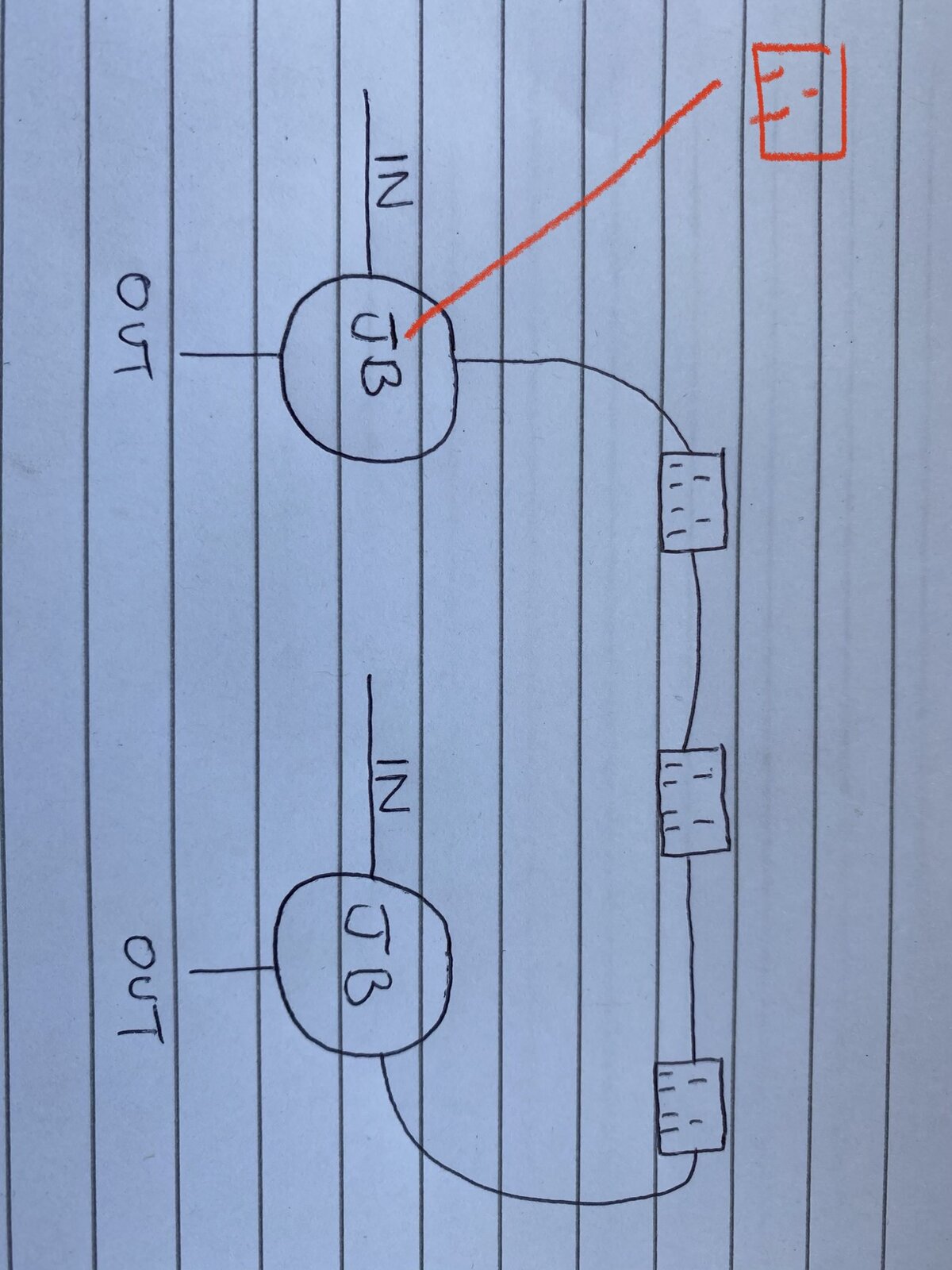

Hi,
Attached is how my socket circuit is mapped in our master bedroom.
I need to add another socket but access to the existing sockets is a challenge.
Is it acceptable by today’s standards to run a spur (2.5mm single cable) from one of the existing junction boxes to a new socket?
The existing wiring, if correctly described by your drawing, appears to show a figure of 8 topology, which is not compliant with the regs. There should be a single in, on one JB only, and a single out on the other JB. Where do those "ins" and "outs" go?
Photos of the wiring inside the JBs will help inform our comments.

Perhaps the OP could update his drawing with his proposed additions in a different colour?
Thanks for the feedback, and I completely agree that testing needs to be carried out before any amendments are made.
For clarity, here is what I’m trying to achieve.

Figure of 8 topology regs compliance issues aside, wired in 2.5mm² (min) cable that's fine.

In this particular instance then, where would you spur from? I would have thought a socket ideally, however, would going from one of the junction boxes cause a problem?

Whatever is most convenient - though you might find the terminals in the junction boxes are too full to take another wire as they already have 3, so back of a socket would be easier.

Thanks Dave. Typically the room has been plastered so the junction boxes are my best bet. I’ll redo all the cables and throw them in a Wago XL box with 222’s?!
Attached is how my socket circuit is mapped in our master bedroom. I need to add another socket but access to the existing sockets is a challenge. Is it acceptable by today’s standards to run a spur (2.5mm single cable) from one of the existing junction boxes to a new socket?
As has been asked, could you explain where the "In"s and "Out"s from the two JBs go?

...and how you determined which was 'in' and which was 'out'.
If in fact they are the ring circuit then aren't they both 'ins'? :)
