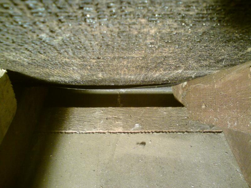

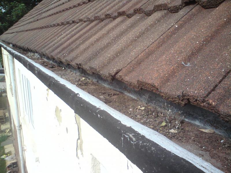

after reading loads on insulating between roof purlins, leaving air gaps and eaves clear of woolly dog, my predicament is;
the house is ex metro with concrete gutters (pics lower down) and there isnt an air gap in the soffit to start with. the felt thats in place, i cant tell if its breathable or not, and there is no vents to the ridge.
plan is to insulate and board, and i i am scratching my head now whether to fill between the purlins with rockwool and board over (no airgap) or to cut 50mm kingspan to fit between them (purlins 50x75) and have a 25mm air gap. if i do it this way, ridge vents wont be too much of a problem, but do i need to sort a soffit vent? this would be the harder part, or can you get vented tiles?

a general view of the concy gutter

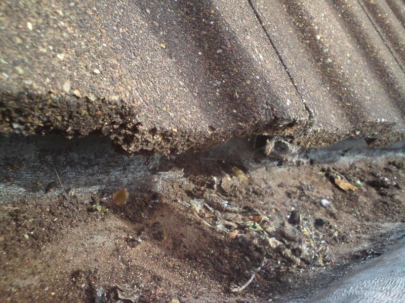

a close up of the gutter membrane
(with hole that i need to sort out as well)
looking from inside at the purlins and other half of concy gutter.
the bottom plastic sheet goes all round gutter to outside, as
previous image.
can anyone tell if the felt's breathable or not?

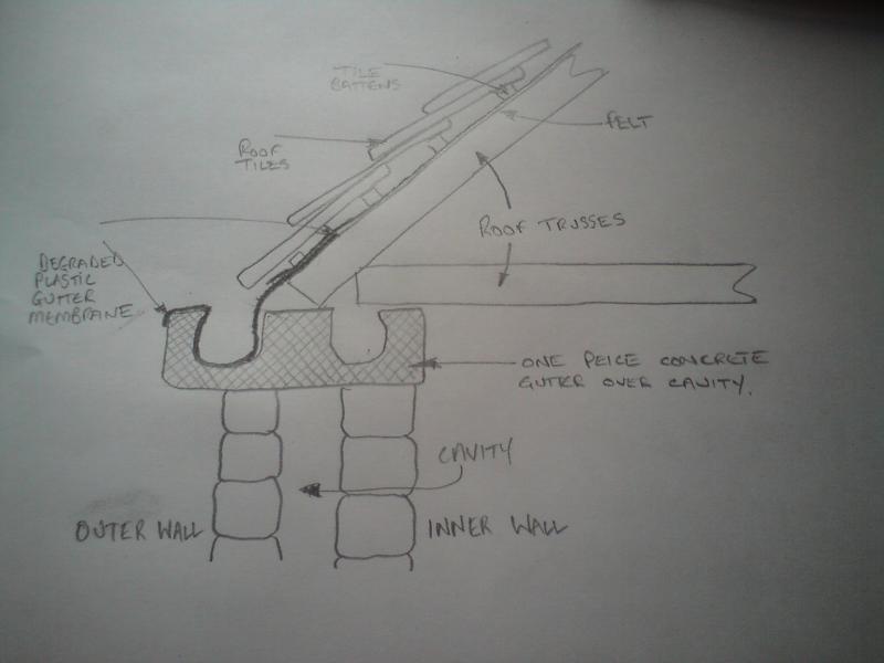

cross section sketch of how its set out.

Yes you can get tile vents, place a few each side of the roof as low as possible but above any insulation. Or have i missunderstood and you are planning to plasterboard over the refaters? In which case you need ridge vents aswell and a min gap of 50mm.
Looks like trad felt to me so not breathable.
ace, cheers for the reply!
yes, planning to board, just to answer the misunderstood bit.
kingspan it be then, with top and bottom vents.
