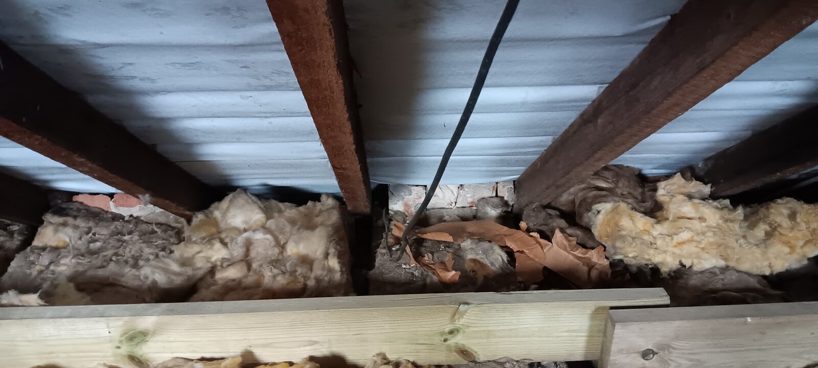

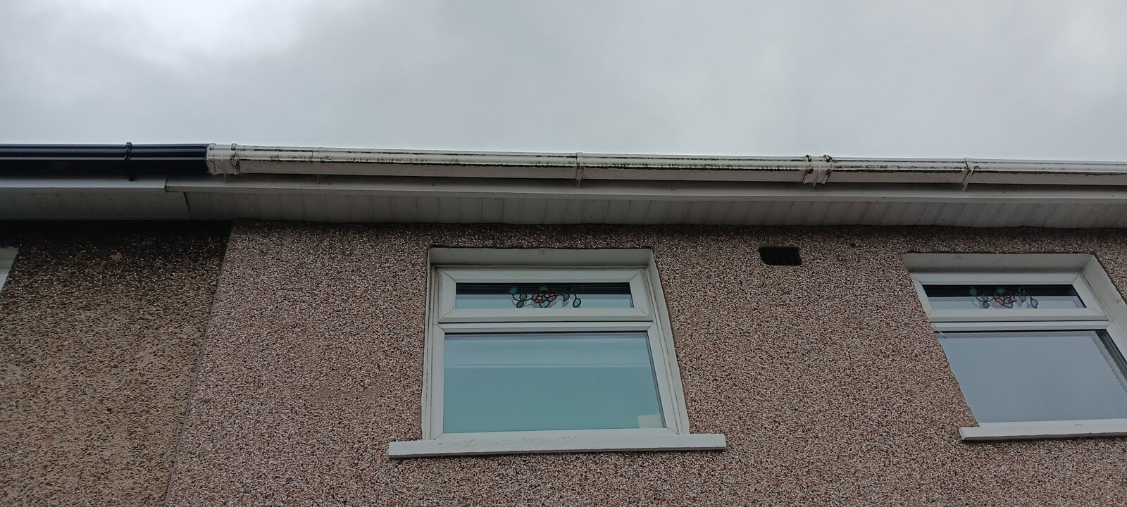

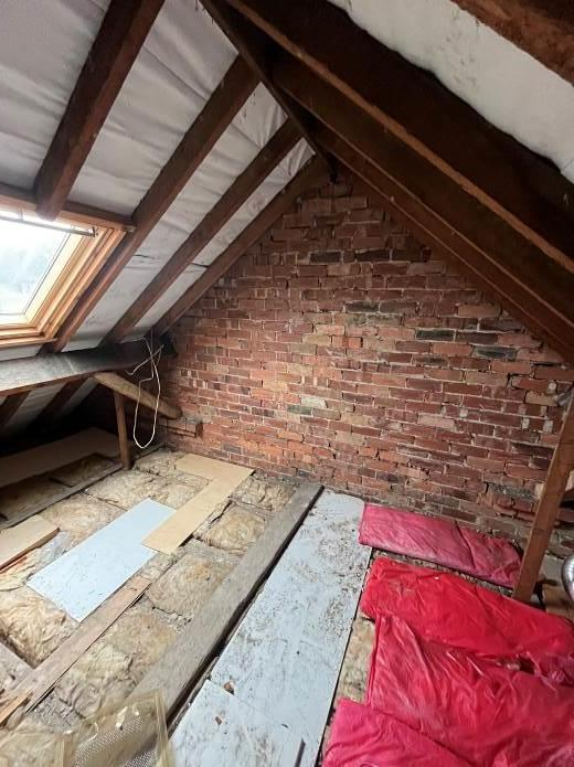

So, moved in about half a year ago, boarding the loft right now. I plan on putting Kingspan in between the rafters, and I wonder... do I need ventilation, and if so which one. Here's a pic of the loft:

Now to say this straight ahead, AT THE MOMENT we have no problem with condensation at all. All roofers attested that it's a pretty good breathable membrane. There's two Velux windows in there which we can obviously set to ventilate if needed, I have a decent dehumidifier and smart sensors if humidity should crop up. The plan is to turn the loft into mostly storage, maybe "hobby room" where I can put my tools and do some stuff on a rainy day, and that's probably about it. There's proper insulation on the floor (there were typical 1960s tiny 2x4 ceiling joists in there with a 100mm-ish or a bit more rock wool, I've added proper 6x2 joists mounted on wall plates/load-bearing walls, an inch above the ceiling joists, with 170mm rock wool which takes me up to a good 270mm according to regs). The rafters are 100mm so I'll put 50mm of Kingspan in between to leave 50mm air gap between insulation and membrane.

- One didn't even come over and just sent a quote for 260 quid to put in soffit vents (which I kind of suggested in my enquiry for the quote, and there's a chance they know the area as most contractors I contact do).
- One came over and basically said "don't bother". He said he wouldn't put in tile vents or anything like that as the air flow wouldn't go sideways, so not between all rafters anyways, it could just make everything more subjective to water ingress, and the most he'd suggest is soffit vents. But he said because my soffits aren't siliconed to the wall there's enough air gaps between/around them to allow, together with the roof's breathable membrane, for some air flow, and if there ever was any condensation it would drip to the bottom and I would see it on the soffits/wall and could put in soffit vents THEN. But for now, don't do anything.
- One came over and said soffit vents won't work because there's not enough space above the eaves for air flow, there would have to be eaves vents, and he suggested 3 tile vents on either side and a ridge vent across the top.

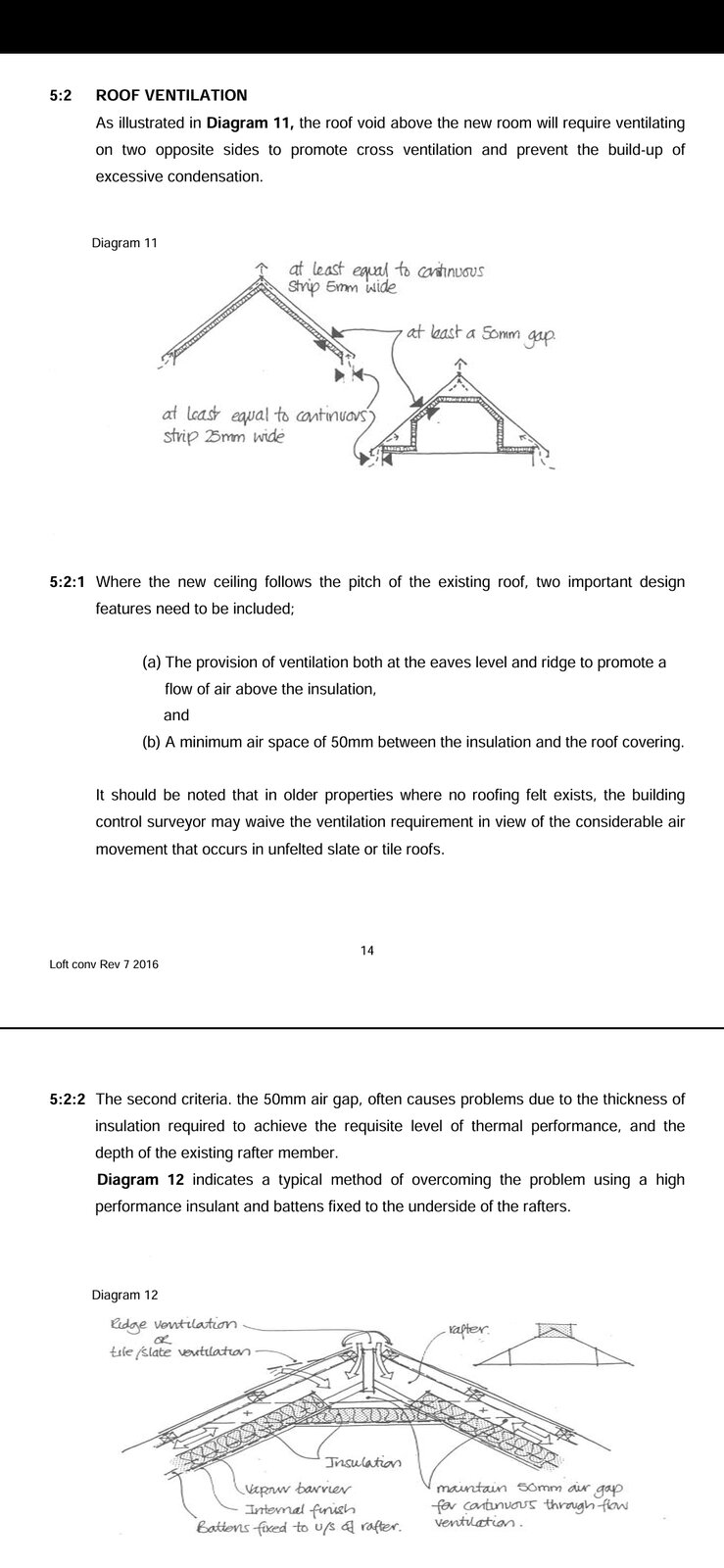

Ideally, there should be a cross flow of ventilation above the insulation - from the eaves (either soffit, or over fascia vents), to the ridge, and back down the other side.
The minimum gap between PIR insulation slabs and a breathable membrane should be 25mm.
Here's some guidance from a LA regarding ventilation of a loft conversion...
Some of your existing insulation appears to be pushed up tight into the eaves, refurbishment vent trays may help keep the ventilation path clear.
Another issue of slight concern, are your loft windows. Depending on the rafter size, it's usual to double up on the rafters and headers around a new window.
Your rafters may be structurally OK, but it appears that the header is quite slim - probably not a good idea. Were these signed off by BC?
Thanks for the regulation links! Yeah I know the min gap is 25mm but I don't feel I need to overdo it, I'm fine with 50mm insulation and then having a 50mm gap.
Everything you see was done before we bought the house, and there's no certificates, no documentation, we don't even know how did it. Most of what we can see in and around the house is done to really high standard - the previous previous owner was in the trade themselves (decorator I believe) with good contacts so the plastering and all things in the house are top notch. But we don't know if/where they cut any corners "under the surface". The rafters around the loft windows aren't doubled up, but I don't think that's a DIY fix for me, is it? And generally I don't want to tinker too much with structural stuff. I had a few roofers up to inquire about the vents and no one commented on the loft windows, the only thing they said is the membrane needs to be properly tucked away in some places (is there some "membrane duct tape" or do I just staple it where it's a bit loose or what?)
The insulation that seems to be pushed into the eaves I'm gonna take back. My plan is to take small off cut bits of the Kingspan to put it on the corners of the boards and then push it over the eaves, so that it's guaranteed there's an air flow gap, but no insulation can push into the eaves (as they do right now). Also, there's some random bricks on top of the eaves that I have to remove.
