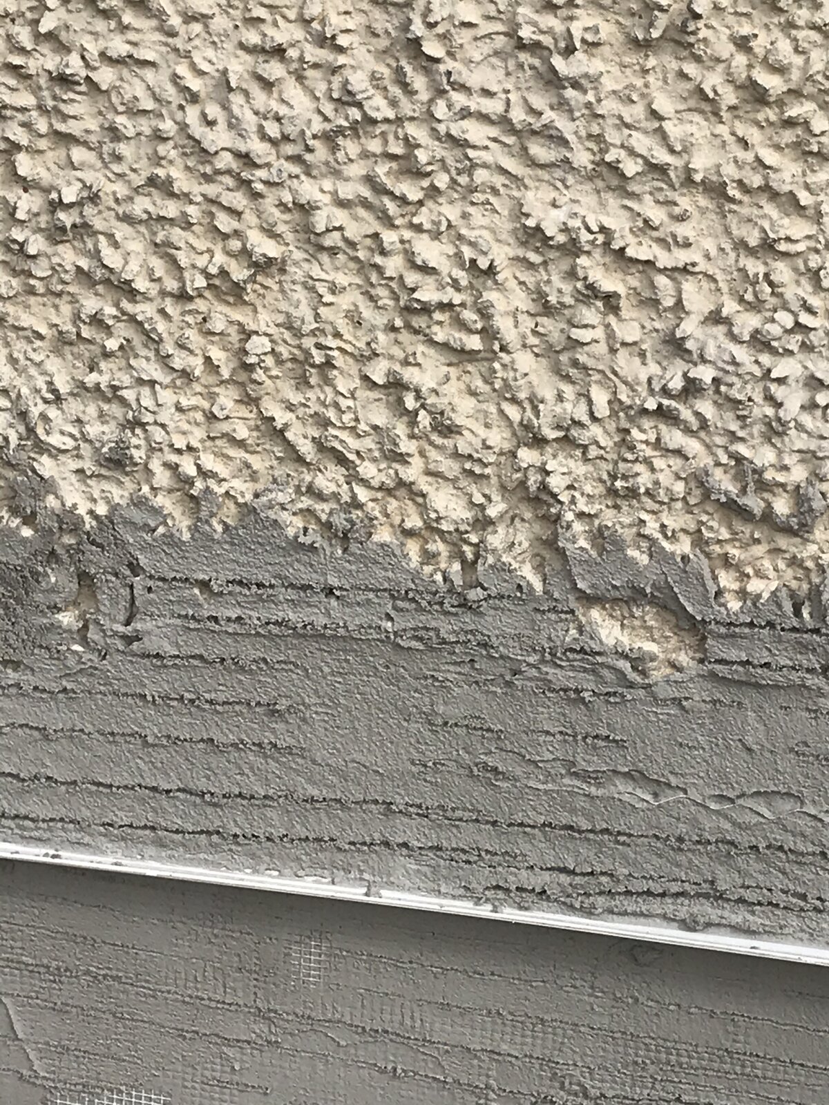

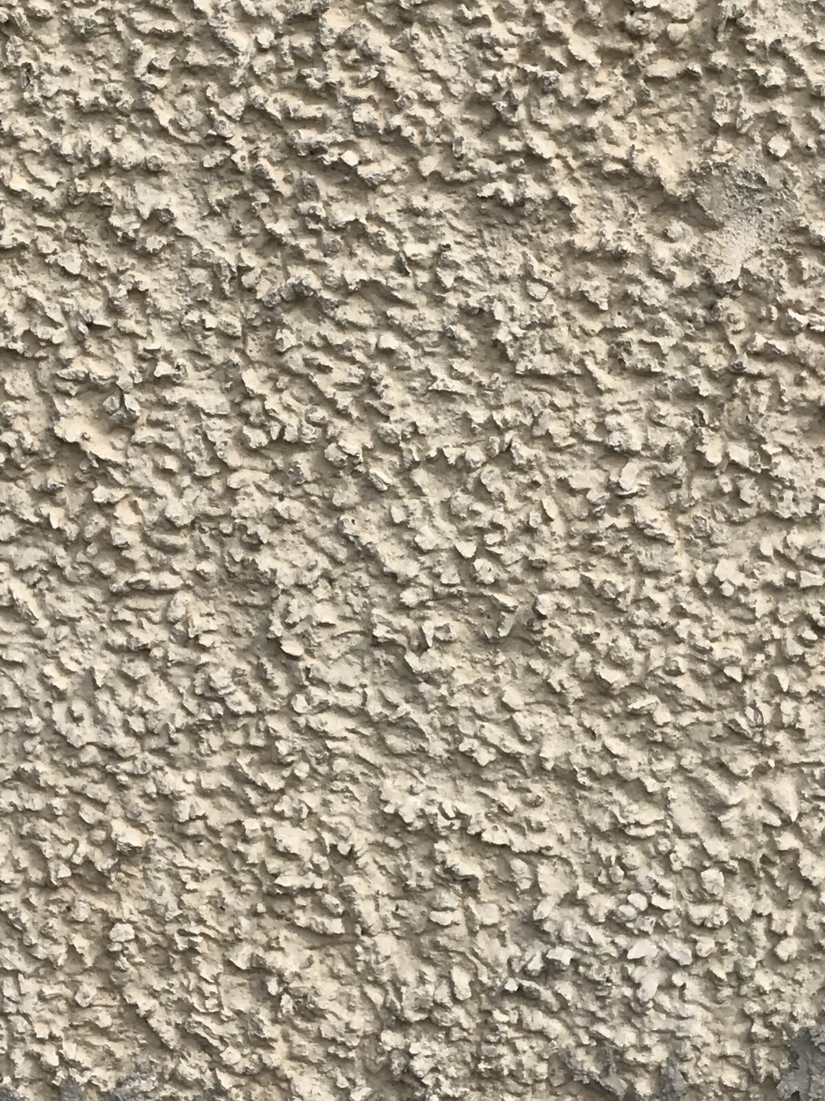

How thick can you apply roughcast on wall it’s going over old roughcast the guys haven’t put on any scratch coat will this be ok.

Should be meshed, and basecoat applied if thats a painted surface.
