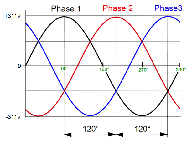

This is 220V 3-phase ....
I'm not sure I would say so. For a start, the Y-axis is labelled "VRMS", which is nonsense. RMS voltage only has a meaning in relation to voltage over whole numbers of half-cycles, and has no meaning as an instantaneous value at a point in time. If it were a 220V RMS supply,, the instantaneous voltages (relative to an actual or hypothesised neutral) would have a peak of around 311V.

This is 220V 3-phase - what do you connect between to get 220V single-phase?
You don't, because what you have drawn is NOT a 220V 3 phase supply. But had you not got the Y axis scale wrong, the simple answer is that you connect between ANY two of the phases. Literally, pick ANY two phases and plot the difference between them - what do you get ?

You don't, because what you have drawn is NOT a 220V 3 phase supply. But had you not got the Y axis scale wrong, the simple answer is that you connect between ANY two of the phases. Literally, pick ANY two phases and plot the difference between them - what do you get ? ... Ah, John beat me to it on the scale :rolleyes:

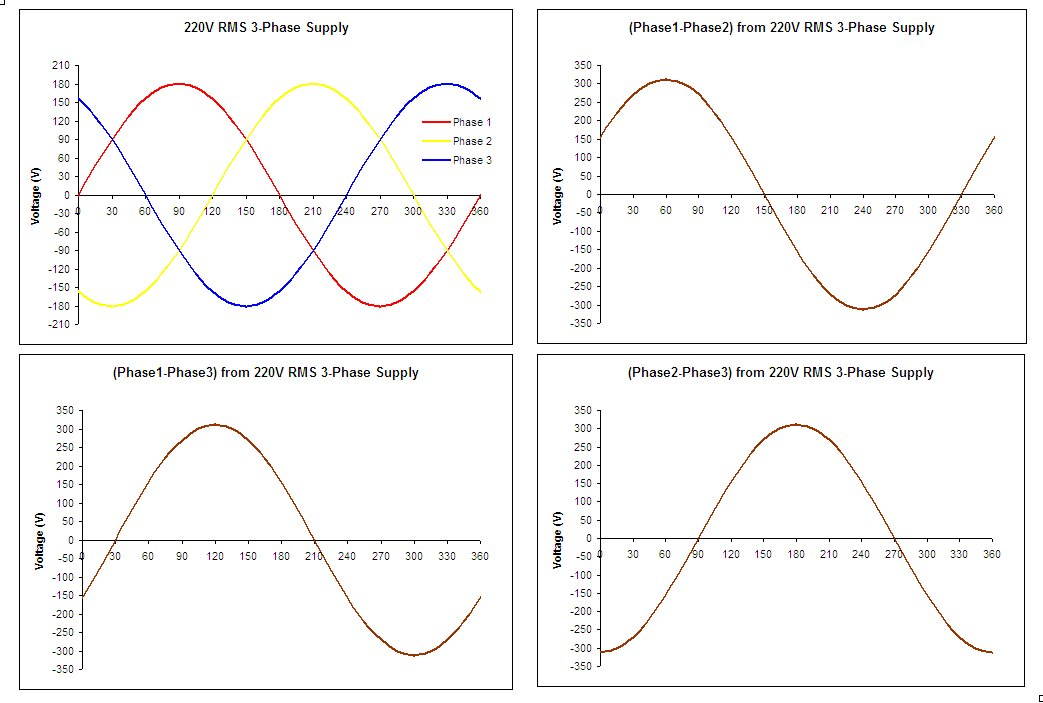

As we knew would be the case, with a 220V RMS 3-phase supply, thus ~127V RMS (~180V peak) per phase, what one would get, between any two phases, would be ~311V peak (~220V RMS) ...
Kind Regards, John
But it's not (in terms of normal terminology), is it?
No, it's not.
I screwed up in the original diagram, and then carried that through to the second one as I was distracted by my reaction to your pettifogging comment about RMS.
No, it's not. .... I screwed up in the original diagram, and then carried that through to the second one as I was distracted by my reaction to your pettifogging comment about RMS.
It wasn't so much the mislabelling of the axis as "VRMS" which concerned me, since it was obvious that, despite what it said, you were showing plots of instantaneous voltages against time.
My real concern was that, regardless of the axis label, you had plotted incorrect values for the individual phases of a 220V (RMS) 3-phase supply - as you say, a "screw up" :)
But no worse, I suggest, than your screw-up - as you realised I was meaning to show a 220V 3-phase supply, you should have pointed out that my peak Y values should have been +/- 180, not 311.
Two wrongs don't make a right. I fairly rapidly corrected my mistake. Without prompting from Simon and myself, you may eventually have also corrected yours, but who knows?
In fact, it's hard to see how this suggestion ever arose. We all know that the meaning of a "400V (RMS) 3-phase supply" is that there is 400V between phases (and 230V between each phase and the real, or notional, 'neutral'), so I don't see why it was ever doubted that there would be 220V (RMS) between phases in a "220V (RMS) 3-phase supply".
It was one of your many questions (rhetorical and/or socratic) which does, indeed, imply a suggestion. If you had (somewhat more characteristically) written something like ".... what on earth do you connect between to get 220V single-phase?" that would have been even more obvious. The implication of your question was surely that you did not believe that one could get 220V by 'connecting between' anything?
In any event, as you know, the answer to your question was/is very simple/obvious ... IF what you had shown actually had been "220V 3-phase" (which it wasn't), then you could connect between any two of the phases to get 220V, since that is the accepted meaning of "220V 3-phase".
