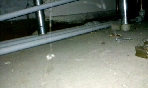

Not only cables, this is a new heating system. OK this part is on the concrete floor under kitchen units but upstairs it's just as OP describes.

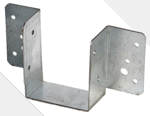

If you have access during installation you can clip them to joists where they run in the same direction, and if you want to support them where they run at right angles you can use mini-joist hangers and short lengths of cable tray.
