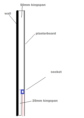

So, plan is 50mm insulation board, with 35mm backboxes, plasterboard, and skimmed.
My idea, which I hope will maintain vapour control and also give space for cable to avoid overheating risk, is to totally remove the 50mm board where the cables run from below the floor to the socket, and replace with 25mm board, leaving a 25mm gap, which along with the 10mm (or so) plasterboard will provide the right size space for the back box, and give room for cable and channel to run.
Does this sound like a good idea? How do people usually run cables over, or through, PIR? The insulation and plasterboard will both be stuck with foam, so no batten spaces etc.
Here's a pic I just made ...

there will be a gap of 25mm between the insulation board and the plasterboard. I could run it through a bit of plastic pipe if that would make it safer?
I am saying there is no need for the 25mm. gap so that the cable touches the plasterboard.

If the cables are clipped to a wall (or in contact with the plasterboard) then the wall/plasterboard is deemed to act as a heatsink so the cables don't get hot. If the cables are enclosed in conduit then that heatsinking is deemed to not happen. Your best bet (well BCO was happy when I did it anyway) was clip the cables to the masonry wall and cut holes in the insulation/pb where the socket boxes were (insulation bonded to pb and the whole lot dot and dabbed to the wall, 70mm PIR so well within regs for U value of the overall scheme).

Efl, I'll be using foam to glue the boards together, the cable could be embedded in insulation and foam. That would be bad wouldn't it?
You really should be discussing the routing and exact installation methods with your electrician. Cables can, if you wish, be completely surrounded by PIR insulation - they just have to be sized accordingly.
