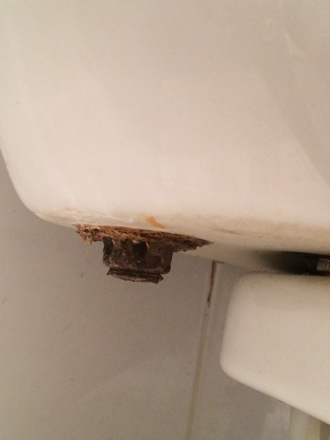

Hi i've just moved into a flat and noticed that at the back of the toilet there is a metal screw thats at the bottom left of the cistern is like this... (please see pic) I'm sure I've seen these screws being plastic before? I assume the washer must have gone or something?
If it should have a plastic screw/nut/bolt for this where could I get a quality one and what should I ask for?...and is it an easy fix? Thanks for your help
is it rusted metal or just gunky plastic - the nut should be inside too
Looks like the old overflow that's been blanked off. Run over it with a wire brush, as footprints mentions leave it alone if not leaking and then paint it white.
You may have trouble removing it with all that rust and cause more issue than you fix.
