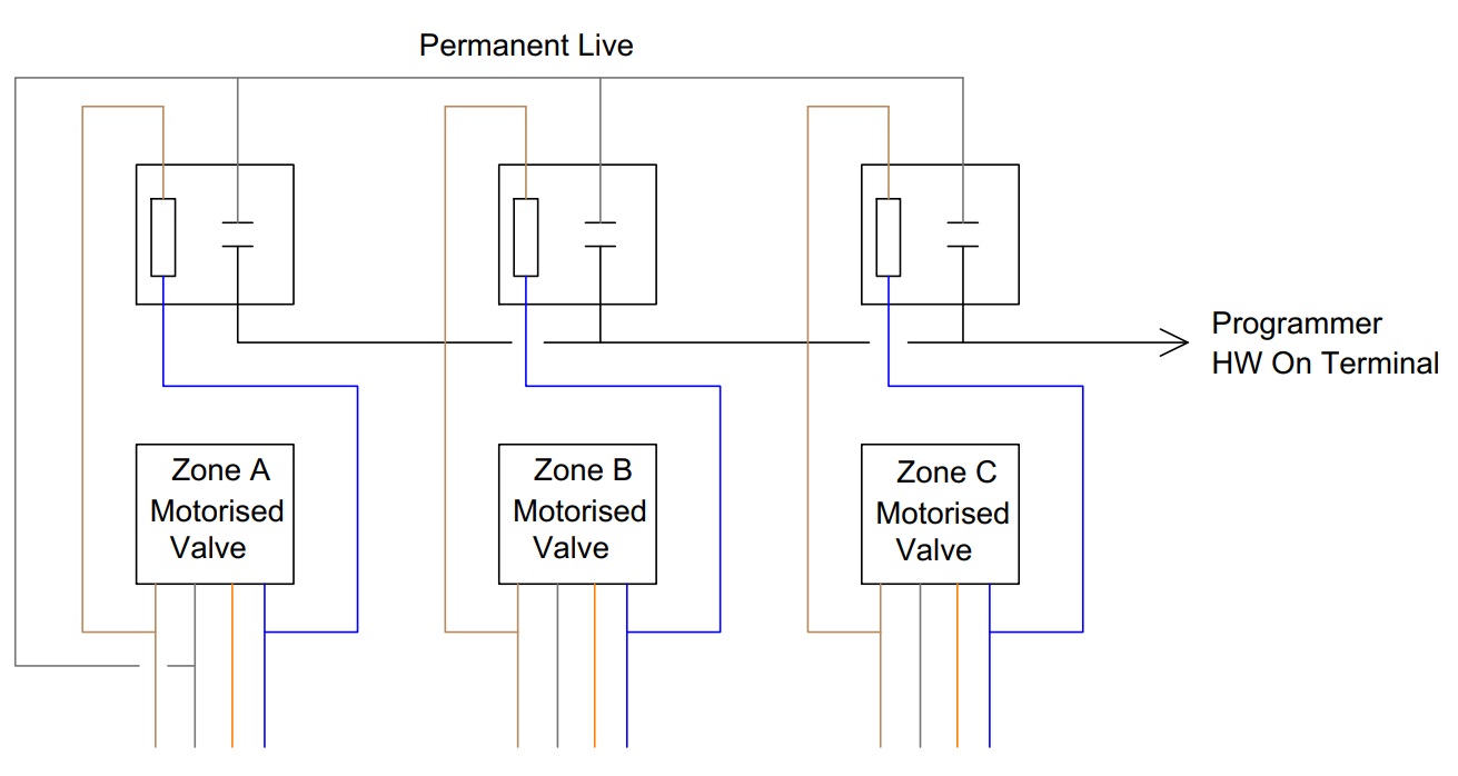

In a 4 motorised valve system, how can I have the hot water valve activated not only when that valve is specifically powered but is also activated when any one or more of the other valves is activated while at the same time allowing the hot water valve to close when the hot water has reached the desired temperature? So, as an example, If A, B and C are motorised valve for central heating zones A1, B1 and C1 respectively and D is the hot water motorised valve controlled by a cylinder thermostat, it is desired to
1 activate D so that none of the other valves A, B or C is activated; or
2 activate A (or B or C) so that the hot water valve is also automatically activated which will close when the hot water reaches the required temperature; while
3 valves A or B or C can function independently.
Thanks.

Wire the coils of three relays with normally open contacts to N & L of the three central heating motorised valves A, B, C.
Connect the normally open contacts of the three relays together in parallel.
Connect one side of the normally open contacts to a permanent live
Connect the other side of the normally open contacts to the 'HW On' of the programmer.
When any of the CH valves are opened, the relay will also switch on the HW. The relays provide the necessary isolation between the motorised valves.
For the purposes of the diagram I have assumed that the grey wire to the motorised valve is the permanent live. Convention states that's the way to do it, but very occasionally some installers transpose orange and grey. So best to check first.

I forgot to mention that with my suggested solution, connecting the wire to the HW On terminal (instead of the motorised valve D as you suggested) means that the hot water cylinder thermostat will still function and prevent the hot water overheating. Although you might not have noticed so far, as I imagine you don't have the central heating on at the moment. :giggle:

@stem. I have now installed the 3 relays as you suggested. Two of them work as is desired. In other words, when power to, for example, Zone A or Zone B vlaves is switched off, then the boiler/pump also switches off. However, for Zone C, there is a "problem". Having turned on Zone C, its valve opens as does the HW cylinder valve. However, when Zone C is powered off, the boiler pump continue to operate and will only switch off the the HW thermostat reaches the desired hot water cylinder temperature. In other words, power is constantly applied to the Zone C's relay. I hope that makes sense. If you have any thoughts on this, please let me know. Otherwise, I'll abandon the Zone C relay option. Thanks again for your advice.
All three are exactly the same, so if A and B work, then so should C.
The hot water channel of the programmer will still be working as per its set timed schedule. Is it possible that it has turned 'on' and is responsible for keeping the hot water going?
Other than that check the wiring carefully to make sure all 3 heating zones are wired up exactly the same.
