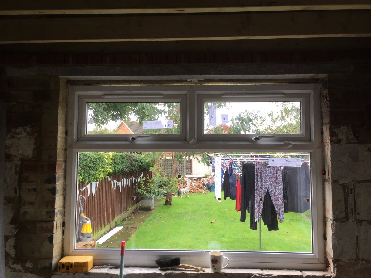

I have a upvc window with two fan lights at the top
The top part is sagging down as the top of the frame has nothing to fix to as it has a steel reinforced concrete lintel above it that is holding an end wall gable
I removed the foam fix from above then packed the frame off the window, the frame is fairly compliant

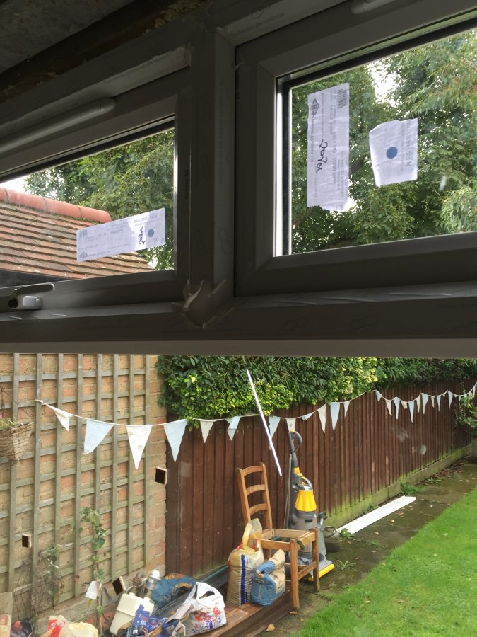

Now the window has a crack 3 days later from when i packed it out! also with no foam fix replaced so no compression from above

As rule we pack the transom up from the glass unit below, picture would help
Hi that's what I did, ^ central to the window and equal spaced either side so 3x packing from top of the unit
Without taking the beading off I cannot remember how many were at the bottom possibly the problem?
When I packed it it was perfectly straight no gaps on the spirit level it seems as though it has dropped 2-3mm when checking after the crack, is that possible?

As a reference the window is 1610mm wide
Please excuse the washing and mess

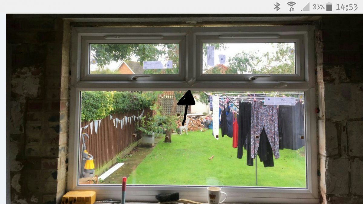

Remove glazing bead and place glass packers here, using the glass unit to pack the transom up so it's level, you will need a gap above the window for this to go up which you have, then foam up

That arrow is where I packed it plus one either side equally spaced so three at the top ( five if you include the two corners)
No need for the packers either side as this can bow the transom up and the sashes COULD start catching, by positioning the packers in the centre you are pushing all the upward load up through the mullion, hope that makes sense.
Have you cured the bow though?
