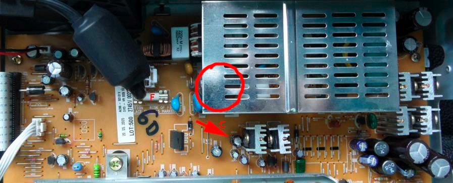

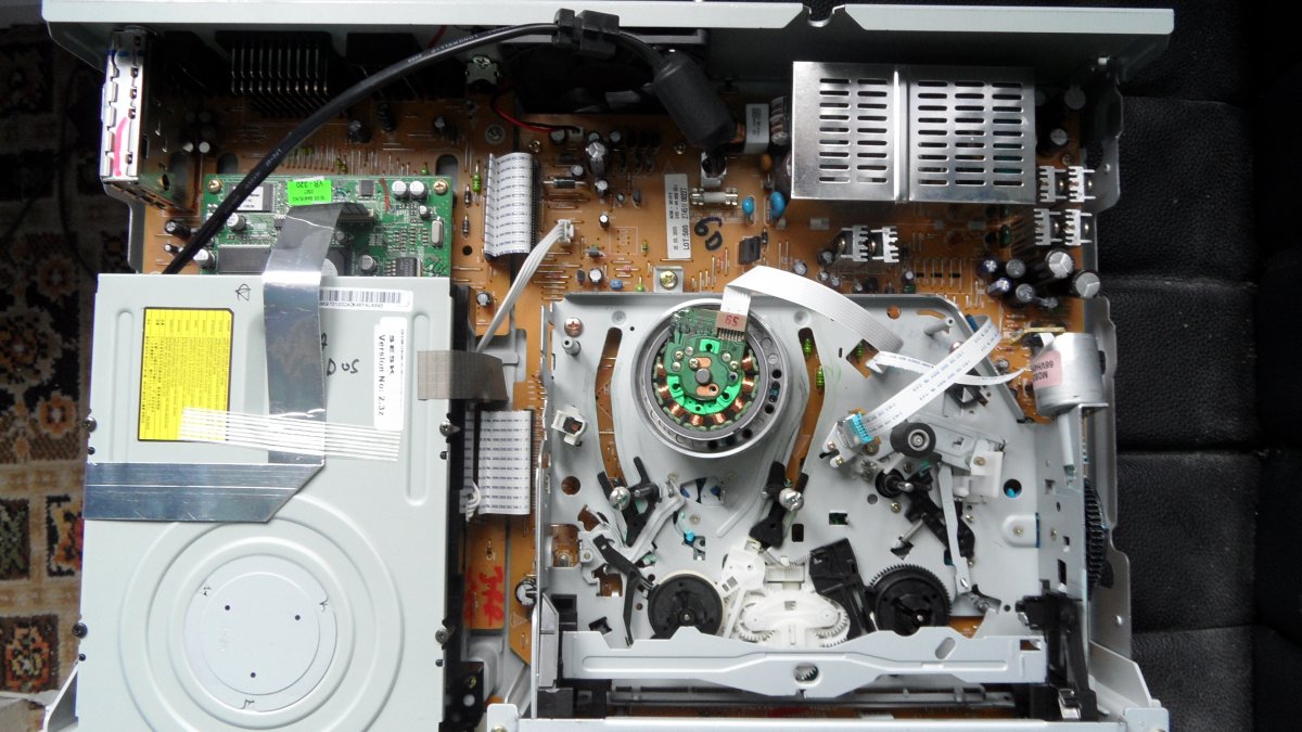

Hi Sam,
The power supply is as you suggest protected by a fixed metal cover but is not on a separate board and to remove the board needs the removal of components like the VHS tapedeck etc. I have attached a photo incase you have any ideas on the stripdown.
Thank's
Measure the fuse "F". If open-circuit, there's a semiconductor fault which will be harder to fix.
The red arrow C indicates a capacitor that has overheated. It needs to be replaced but I doubt this will cure the fault.
The red circle indicates the high-voltage reservoir capacitor. Somewhere between it and the transformer (see yellow tape beneath the grill) is a start-up capacitor that might be the culprit.
Hi Sam, The 1.6 amp fuse is serviceable, well spotted regarding the capacitor. I will now attempt the removal of the board assy. The white flexible strips that connect the boards are these able to be unplugged or are they soldered ?
Many thanks for your help again.
I can see that the fuse is serviceable - it's in a clip.
You'll have to inspect the flexible connectors very carefully. There's sometimes a release mechanism.
