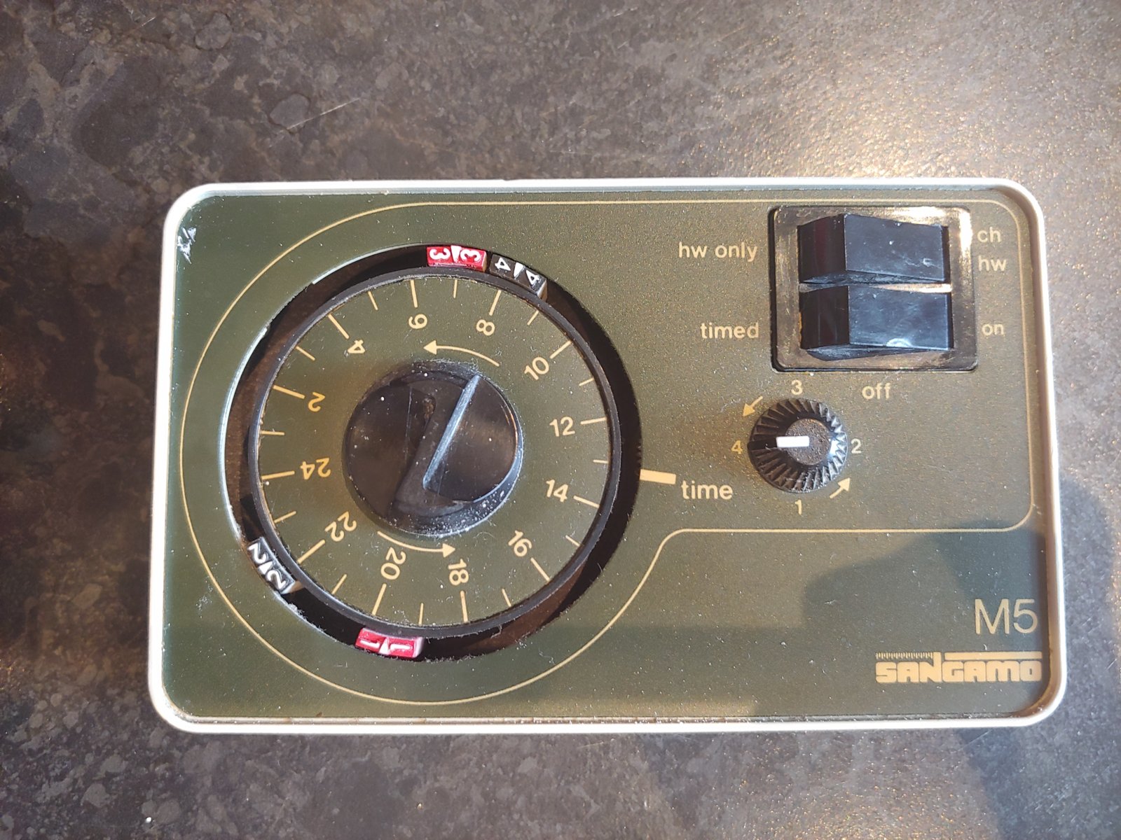

Hi all,

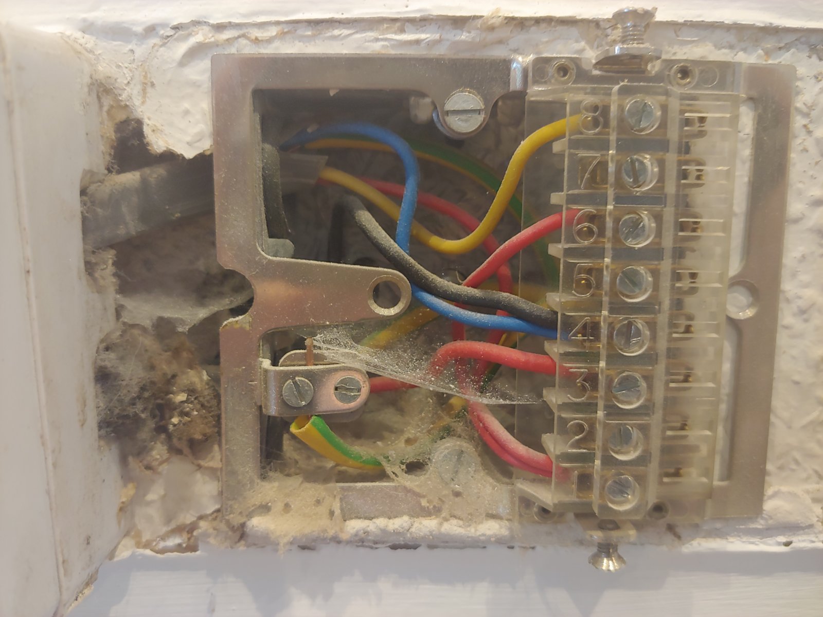

Currently I have a Sangamo M5 faulty/noisy timer attached to my boiler system. The system consists of a back boiler (behind the fireplace), a thermostat, Sangamo M5 timer, an on/off switch, a pump and an insulated copper boiler with a thermostat on the outside of it.

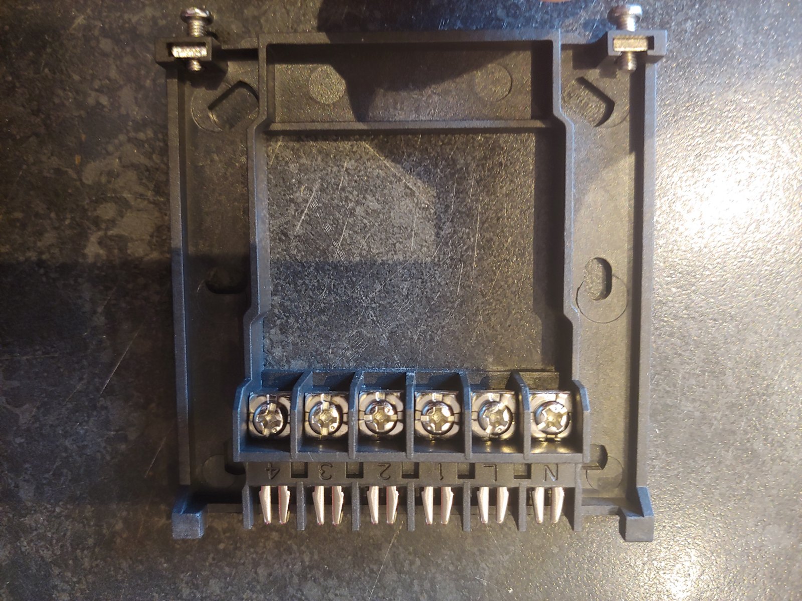

I have purchased a Sangamo Choice PR2n to replace the M5 with but the back plates are different.

The M5 is earthed and the new PR2n is not, do I crimp said earth cable to the other earth cable to ensure continuity?
Dip switch settings?

You have a Gravity HW system, you will need additional controls if you want your PR2 to be fully pumped controlled

Fully pumped means you can have CH or HW on individually, you have gravity HW so you can only have HW on its own or CH and HW together, changing the programmer will not alter this , you will have to change to a Y plan or S plan if you want them individually

The new PR2 is capable of controlling either a 'fully pumped' or 'gravity hot water' system. There is a switch marked 1, pumped / gravity to select the modus operandi. As you don't know which you have, once the wires are moved over from the M5 to the PR2 if you find that in 'pumped' mode when the heating only is set to be 'on' that the boiler doesn't fire up, then simply move the switch to the 'gravity' position.
M5 terminal (1) = HW ON = PR2 (3)
M5 terminal (3) = L = PR2 (L)
M5 terminal (4) = N = PR2 (N)
M5 terminal (8) = CH ON = PR2 (4)
The link wire between M5 terminals 1 & 6 is not required, as the PR2 already has this made internally for you.
