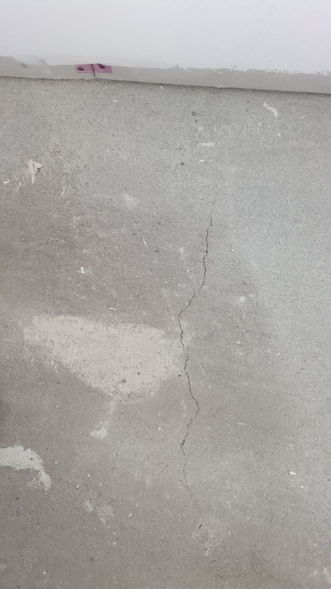

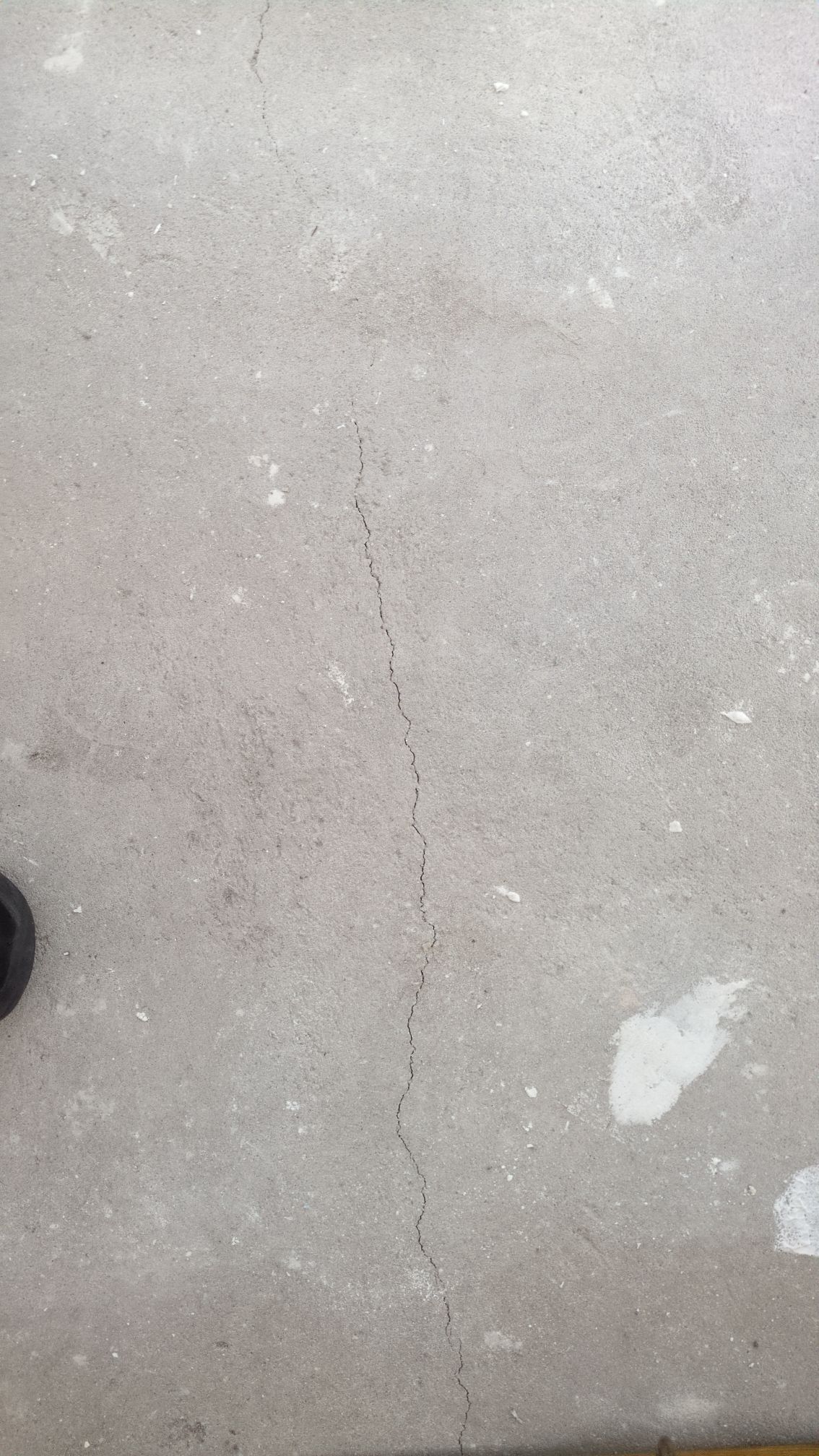

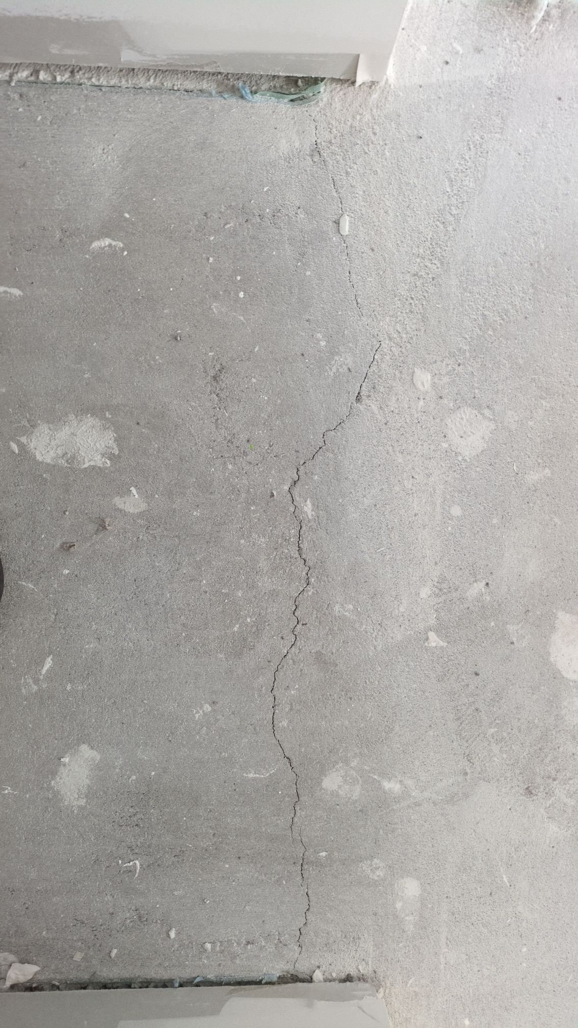

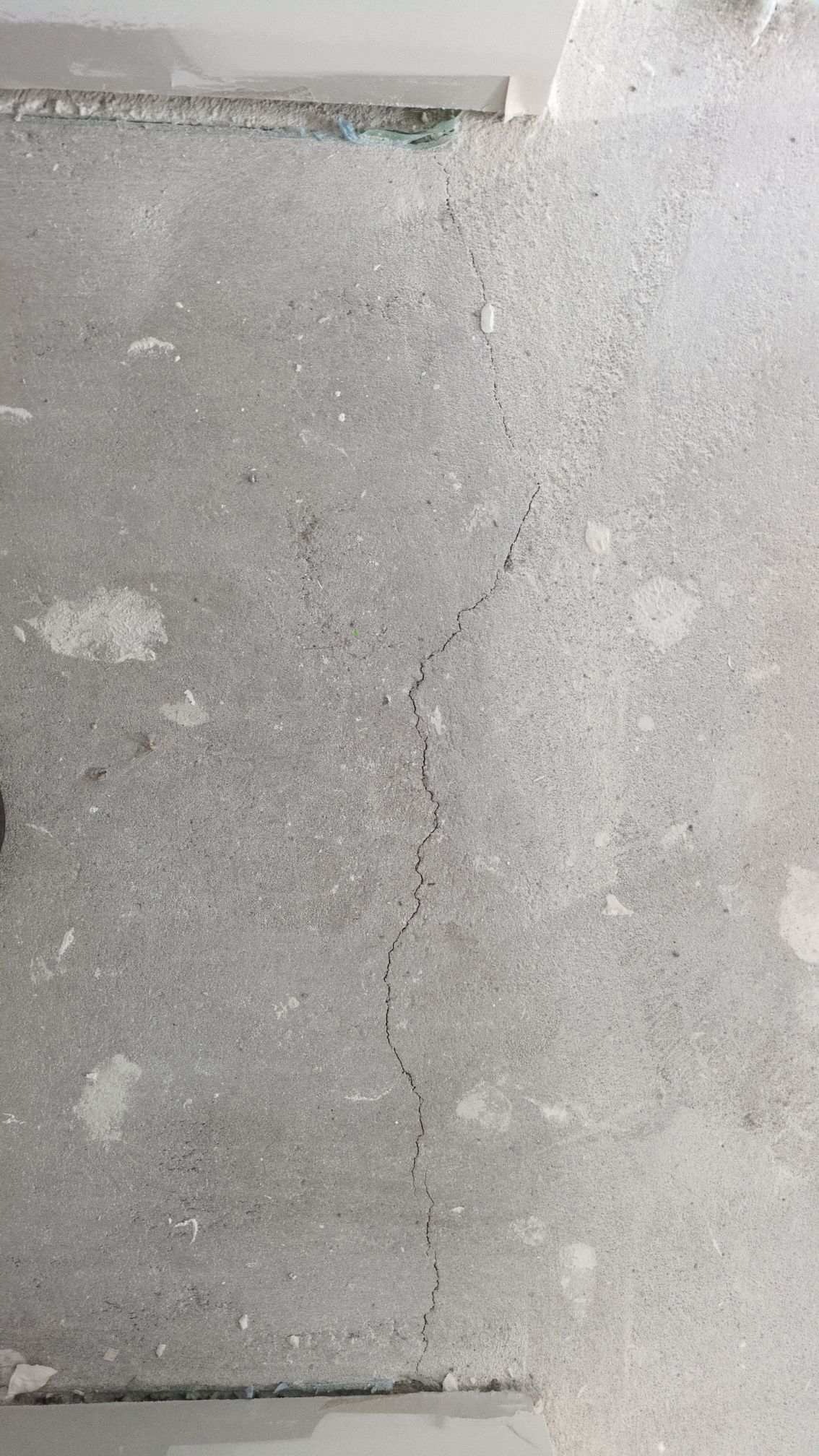

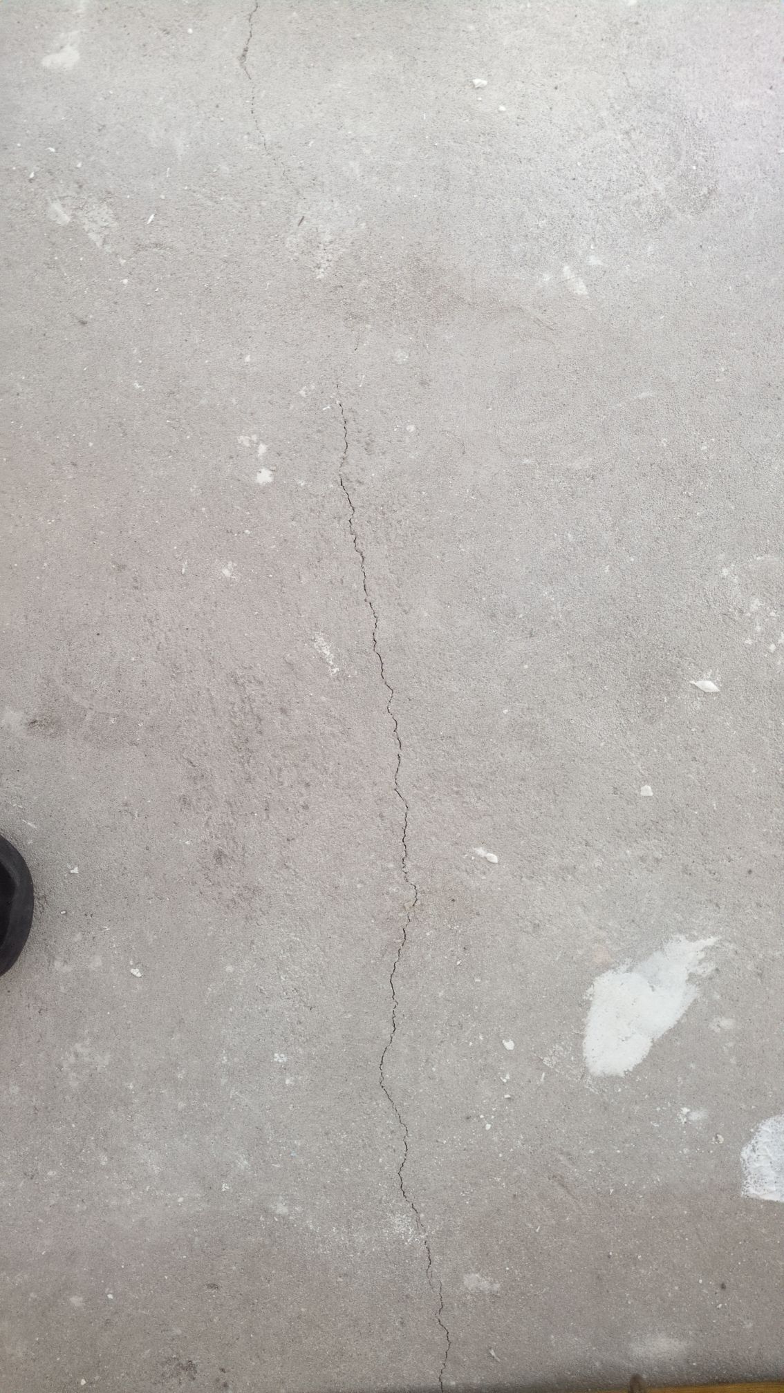

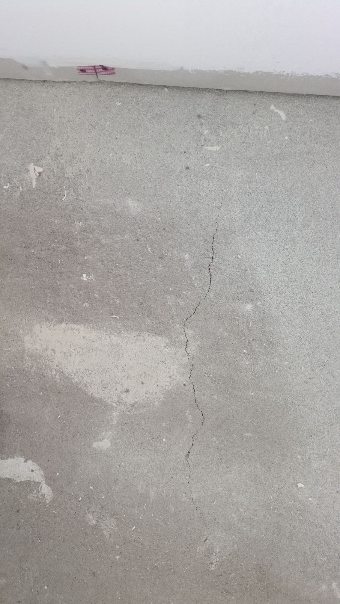

Hi all. Have currently got builders in doing extension which has concrete floor with UFH and screed over the top. UFH has been turned on to dry the screed, raising the temp by 2 deg every two days. Some hairline cracks have started to appear in one room, and wondering if this is a problem? Builder is currently on holiday for the long weekend so can't ask, and would be good to get some outside opinions too as don't want to be fobbed off with a quick but wrong solution. Pictures of cracks attached.
Thanks. View attachment 411907 1000006215_20260403101511.jpg1000006214_20260403101436.jpg
Why would you turn on the heat because heat would crack plaster or concrete?
If you wanted to speed up drying a dehumidifier and fans moving the air..
You shouldn't really be using the floor to dry it out.
It won't really make a difference to the heating, and if you wanted to fill it, just brush in dry and and cement, this will largely be cosmetic. You wouldn't know if the tiles were down.
If you are having tiles, are they putting down a decoupling membrane first?
Screed had air dried for two weeks before UFH turned on. UFH was turned on under instruction from heating engineer, unfortunately I don't know anything about how the screed and UFH works so did not know this was bad.
Tiles will be going in part of extension and I have seen decoupling membrane mentioned elsewhere so will confirm with builders that they will use it.
Two weeks is not long enough to 'air dry' screed, it's something like 1 or 2mm per day, so it would need months to dry properly.
I use Durabase C+ crack/decoupling mat, it's approx 3mm thick, if you can't spare that (marrying up to a current floor level) there is a mat available that is like two sheets of membrane, it's very thin, but might help if you are short on mm's.
Good luck, once floor is finished, you'll forget about the 'issues'.
