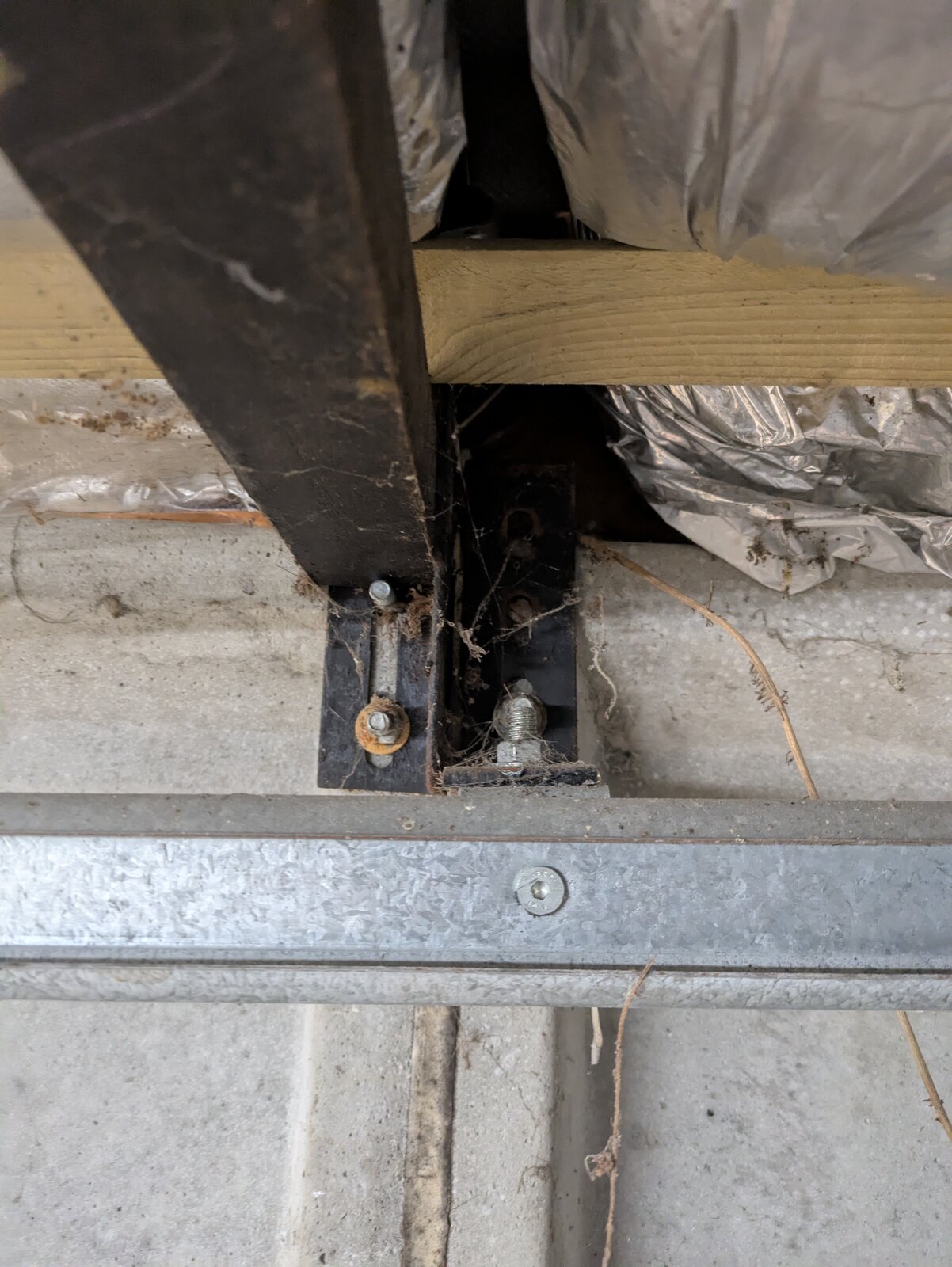

Thanks for the replies so far, upon further research, and speaking to people who have effectively removed condensation from their garage... I think how ill proceed with this is to seal/insulate the thing, add ventilation and heat it for the months it gets very cold.
As this is a temporary solution, which I'll probably replace in 3/4 years when I have completed all the other projects in the house, I'm seeking to keep costs low. So am pricing up - 25 mm PIR for floor (to not loose too much ceiling height), 30 mm PIR for walls and 50mm for the roof.
To seal, I'm thinking DPM membrane, PIR, OSB (chipboard for floor).
For the walls, Ill add timber studs to it finishes flush with the inside ribs, then I can create a continual layer of insulation, taped at the but joints). Up and over, I will leave in place, build a stud wall inside to form a new wall. I very rarely use the garage door, but nice to have the option to use it again in the future.
I do need to raise the ceiling as the pent roof finishes on top of the panels (2000 height), so add loosing
45 mm of that after insulating the concrete floor is not ideal.
I'd like to raise the brackets by 100-150 mm, however the brackets are Maxed out in the higher end of the garage (see pic below). Would it be possible for me to get some brackets made up to extend the brackets to raise each of the joists up 100-150 mil? Or perhaps build a frame from box section/angle bracket/timber fixed to top of the sectional panels, then fix the steel joists to that?
Another option is I could raise the joists up to the max height, then add timber to the top of the joists to create a 60:1 fall. I wouldn't gain any additional ceiling height, but would probably be OK. The preferred option would be to raise them all to gain a bit of height though.
Once the height is raised, I would then OSB the top of the joists, 50mm PIR, DPF, corrugated panels directly on top and fix down.
Any thoughts on all of that appreciated
"High" section:
Low side :
