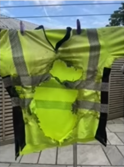

Should high vis be banned? At least those made of nylon type material?

Picture from an efixx video, should any construction worker likely to come into contact with live supplies and the resultant ionisation be wearing any man-made fibre clothes?
View attachment 416310 Picture from an efixx video, should any construction worker likely to come into contact with live supplies and the resultant ionisation be wearing any man-made fibre clothes?
this has been asked very frequently and the cause of a number of injuries but I suspect any conclusions are based along the lines of the number of saves Vs the number problems.
Fluorescent strips can be sown on to most materials, I remember being issued with a fluorescent tab in the building of Connah's Quay power station, which we all wore under our overalls, we were of course stopped, and questioned, and we said overalls as the name suggests go over all, and are to stop any loose clothing from getting caught in machinery, and health and safety required we wear them, and as long as they were prepared to issue a statement to the union to say overalls are no longer required, we would be happy to stop wearing them, as they are rather hot.
We were issued with overalls with fluorescent strips instead. Main material was cotton.

When I did some work on railway premises I was issued with an orange Hi-Vis vest by my employer. I turned up and sat through the 5 hour site induction (which unlike most major building contractors is transferable) the went to find my initial escort, he went through the roof as I had to be dressed neck to ankles in orange (even though I was only working in a very ordinary plant room). I was lucky as he was prepared to escort me to the plant room and go through the scope of works with me incorrectly dressed.
My employer provided orange overalls but nylon... same result as nylon was not permitted. Again he escorted me to the plant room to allow me to start the job but on the instructions that I had to get the proper kit before I returned. That nylon overall was horrible, ridiculously hot and itchy and I for one was very pleased I only wore it the once.
My final PPE was cotton based orange Hi-Viz short sleeved T-shirts and orange cotton trousers.
