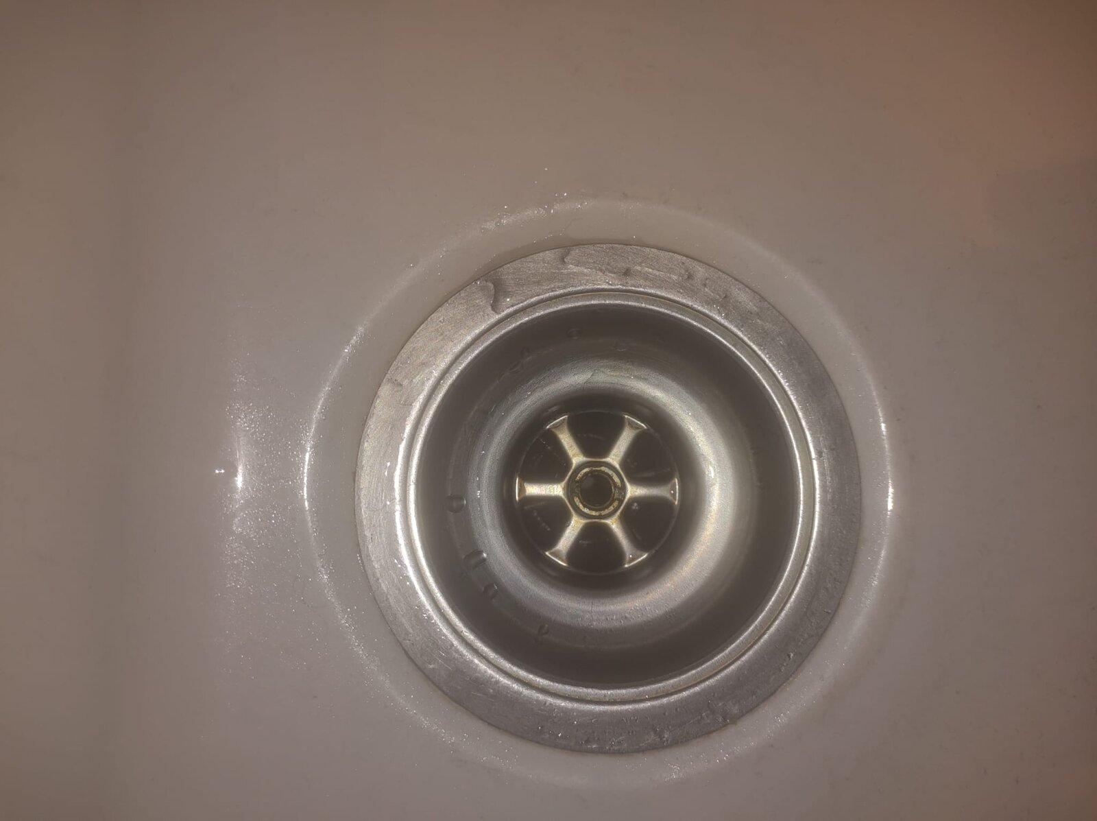

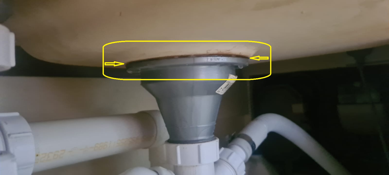

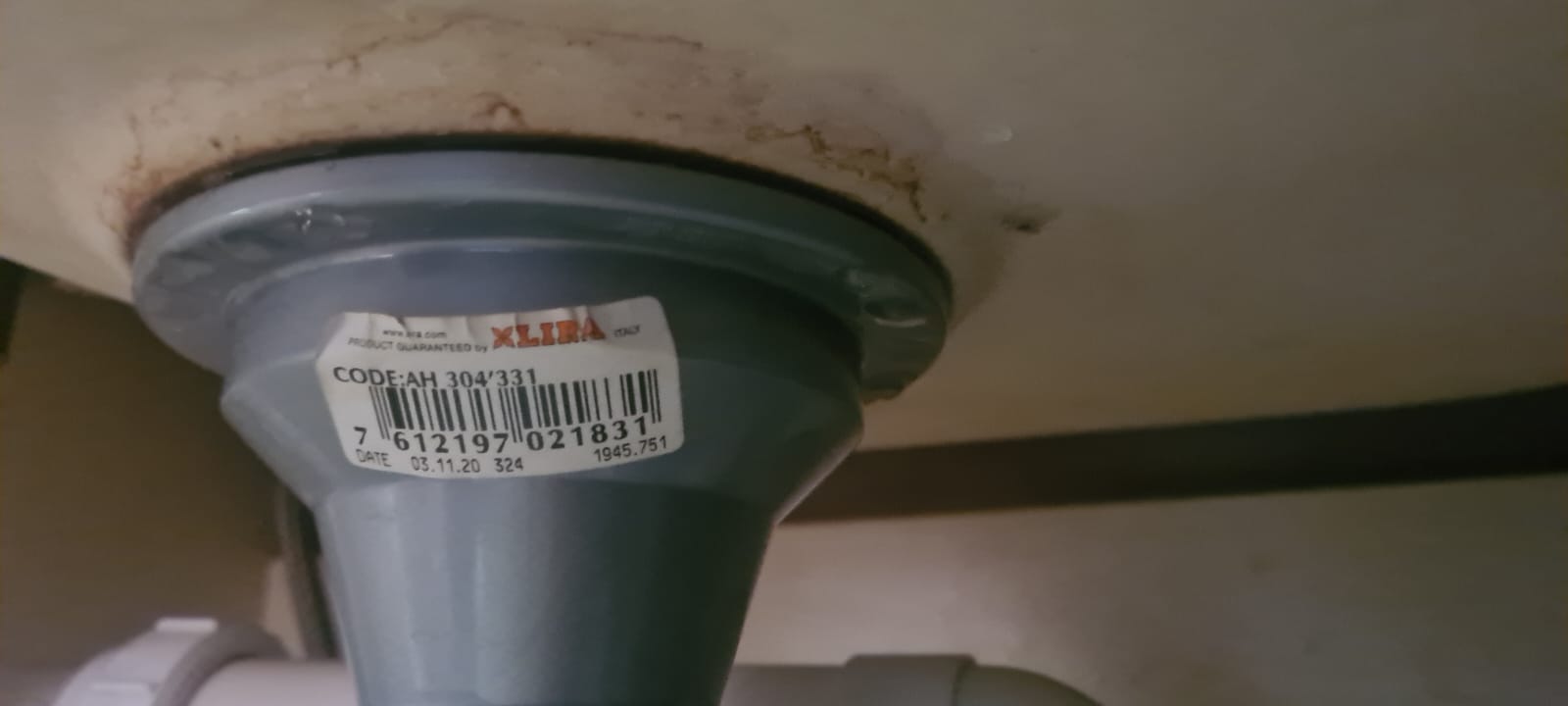

Hi everyone.
Here’s the situation: it’s been leaking from this spot for a while—see the photos. It mainly leaks when I use the sink heavily; if I don’t use it much, it seems like nothing’s leaking. I couldn’t figure out where it was coming from for a long time.
So my question is: can I fix this myself? Specifically:
  1. Do I just need to unscrew the gray piece and replace the black rubber gasket, or do I need to replace the entire gray assembly along with the gasket?
  2. What steps are involved, and how realistic is it to do this myself without calling in a professional?

Very easy job. Look on youtube as lots on there showing step by step....
Looking at it from above (sink), you should be able to see a hollow screw. undo the screw, and it will release the section below. Get a tub of Plumbers Mait, form lumps of it, into long, thin sausages, and apply it to both sides of the rubber gasket, then reassemble, slowly squeezing out the Mait. The Mait is horribly sticky stuff, but it's none setting. Just scrap off the surplus.

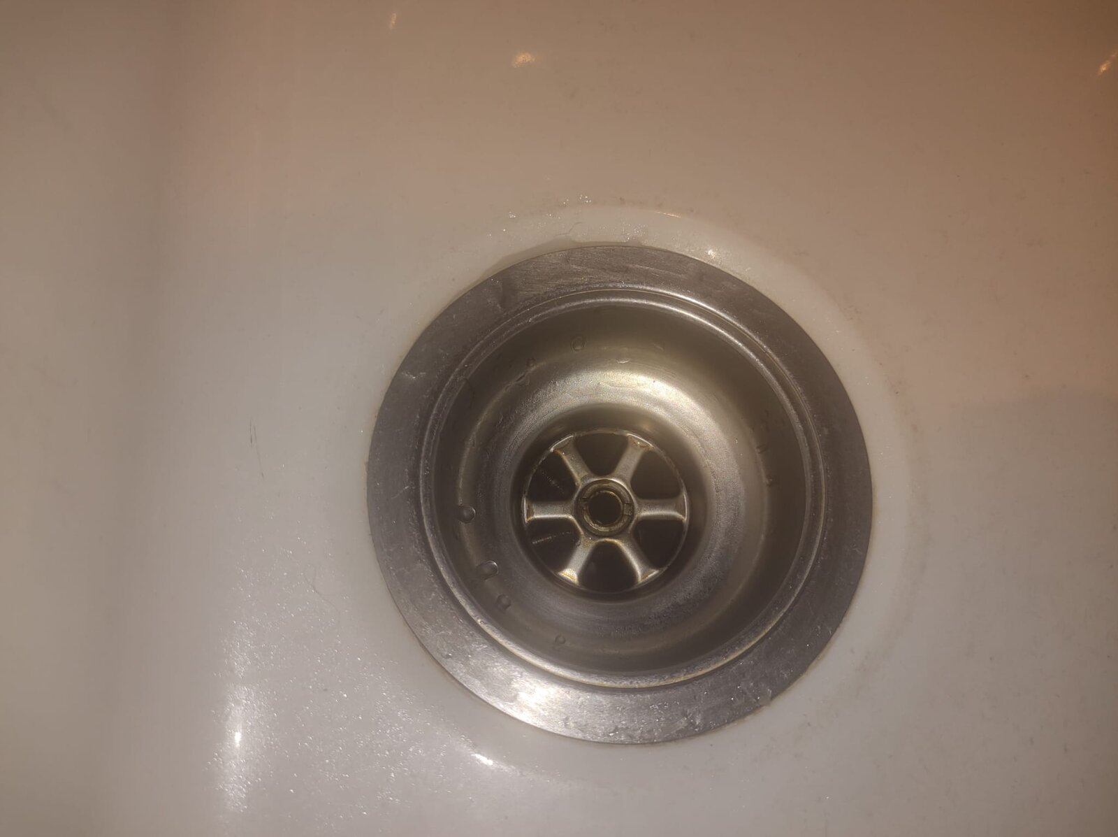

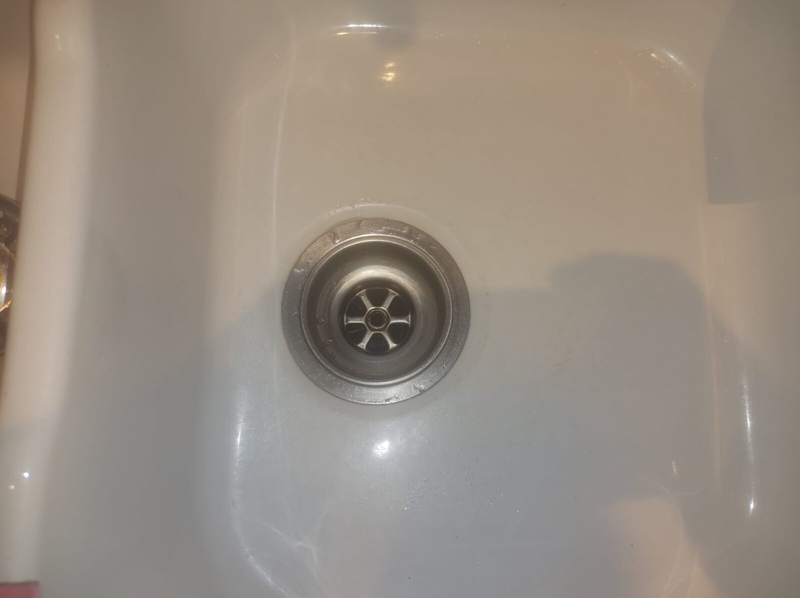

Is on the pics the hollow screw that you were talking about, or is it something unusual? Do i need a specific tool to unscrew it?

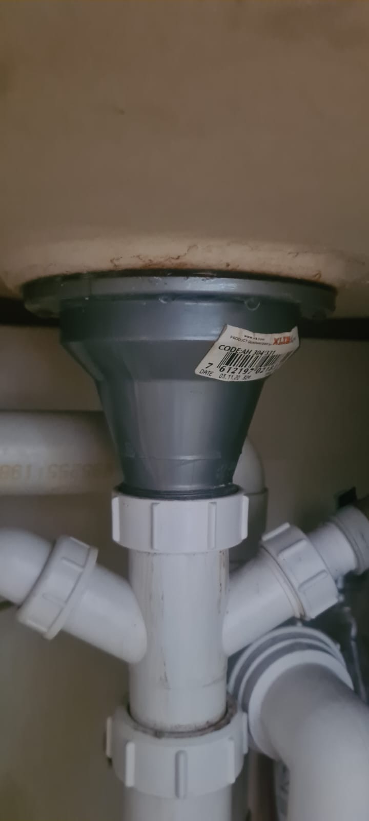

And I wonder, do I need to dismantle all the white pipes below the grey thing to be able to apply plumbers Mait to the both sides of the gasket?

Most likely the screw thats securing the centre of waste has worked loose and just needs a tighten.
If you can get a turn or more on it that’s the solution .
When loose may only leak when hot water is expanding the sink causing leak .
Yes, use a straight screwdiver, wide enough to catch both sides of the slot.
No - you will need to undo the fitting, at the bottom of the grey 'funnel' shape, that is all.
