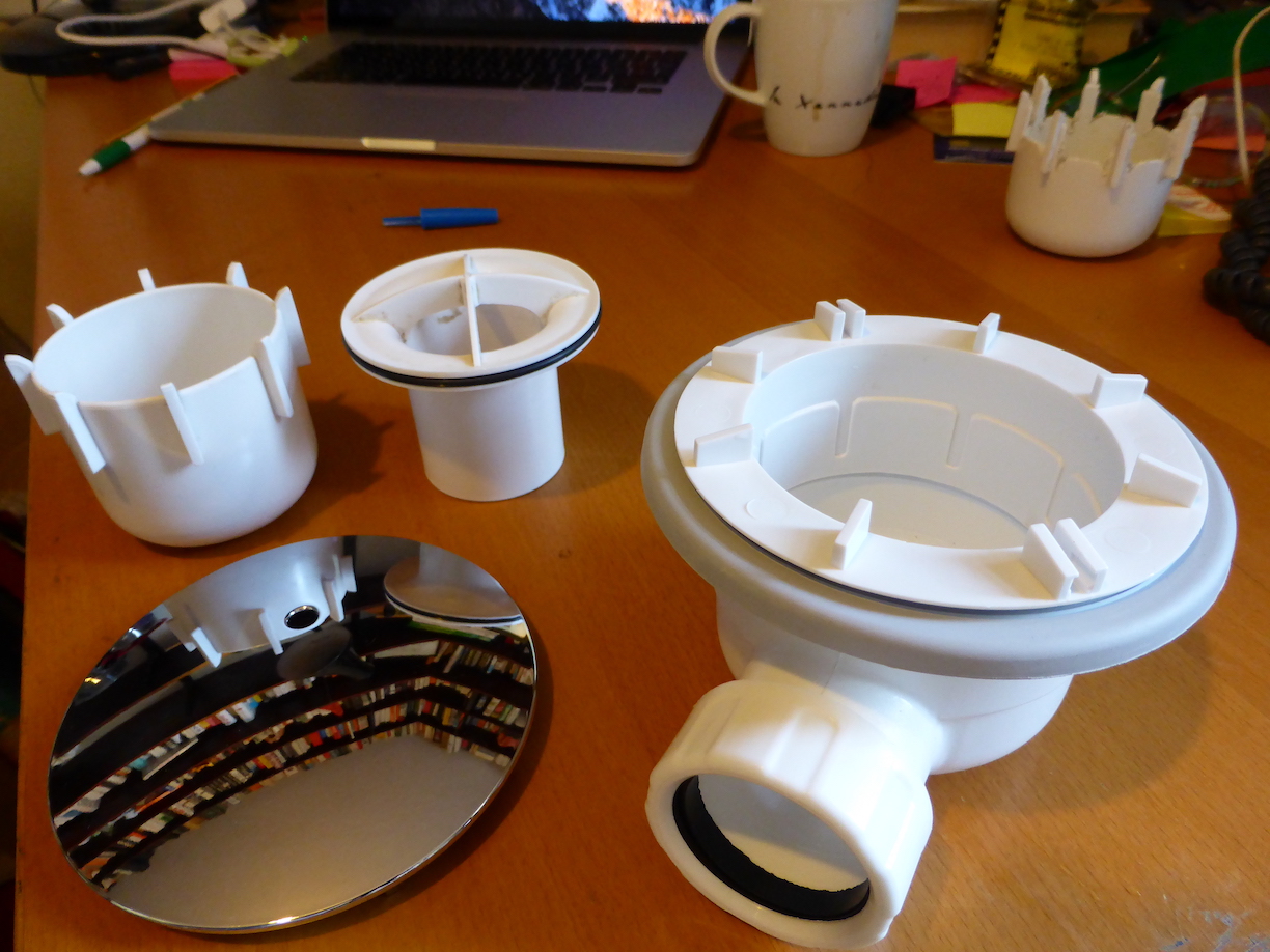

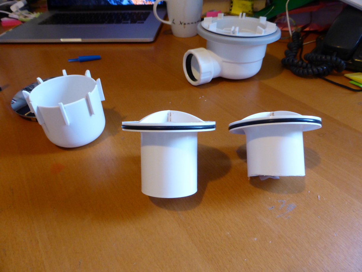

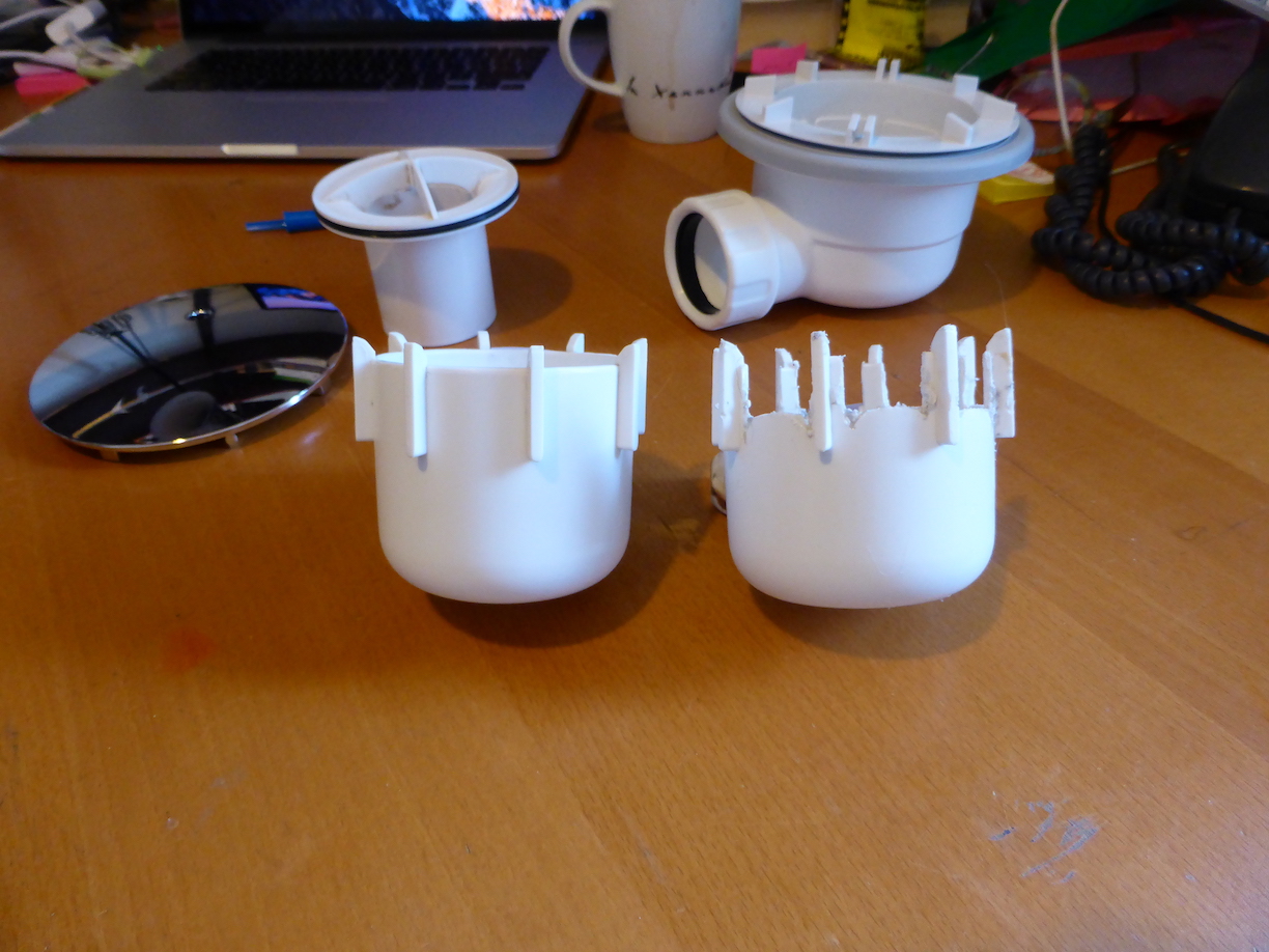

Right, finally got around to writing this up. Short answer: I made the changes I wanted to, it drains fast enough, I'm happy!
Helpful photos for @JBR or anyone else that wants to know:
Mine was actually a Simpsons STHFW6190 High Flow Waste, (one of the great comedy names ) but I imagine this'll work for anything similar.
The water seal inside the pot is now only about 2cm high, but this seems to be keeping smells at bay (they are certainly detectable when the trap comes out for hair removal). So pretty pleased with myself
glad your sorted and thanks for pics of your handiwork Dave. that's now a very shallow water seal ,and its good that its worked for you ,but it may not work for everyone .if the waste pipework discharges into a soil stack it must have a deeper seal than that. so word of warning to anyone thinking of buying this trap...don't !
