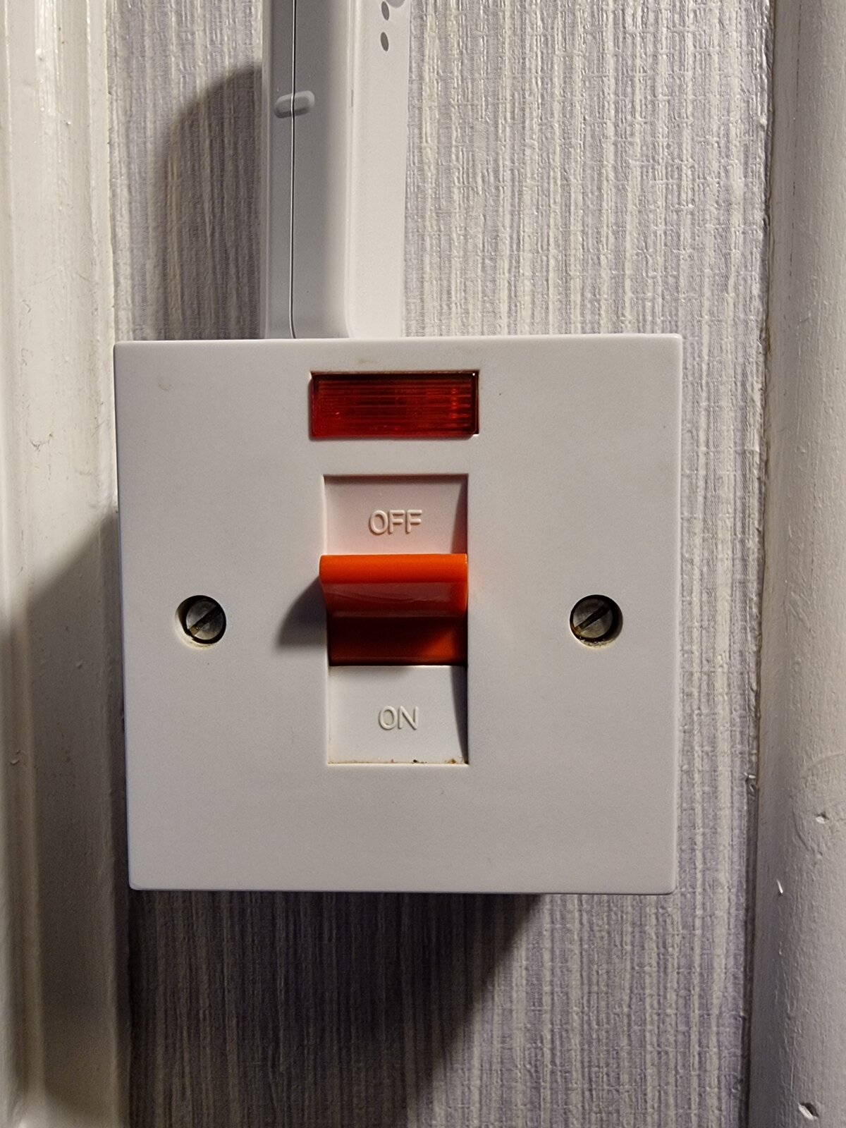

You might have a look at the isolator switch wiring as well.
It seems that switching on at the isolator causes more problems when you switch the shower back on?.

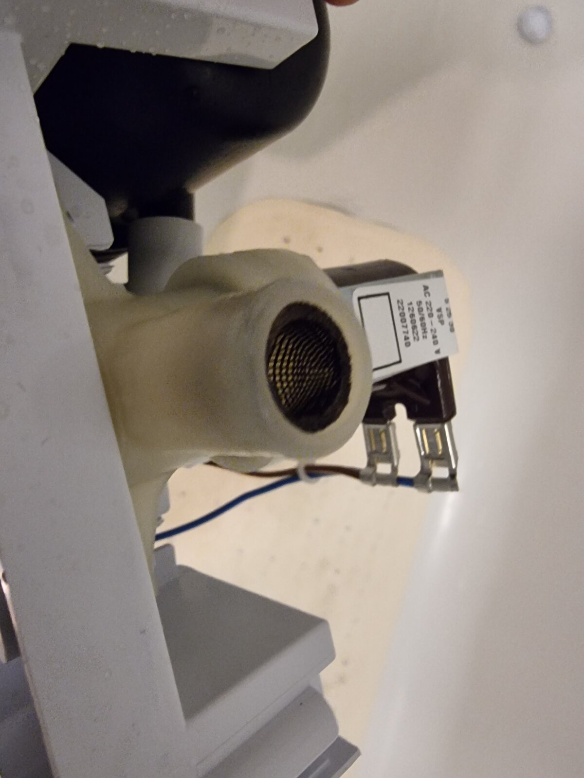

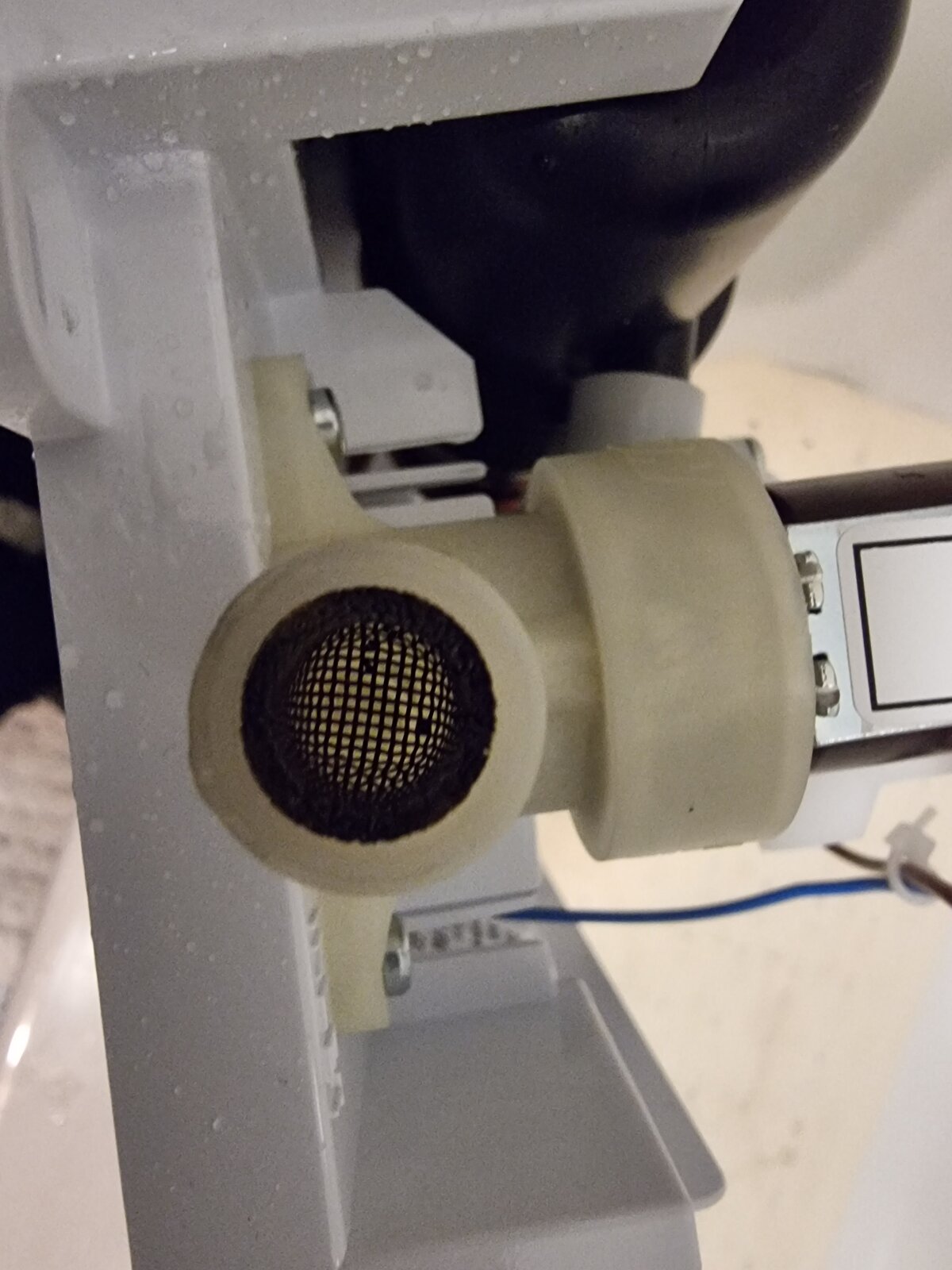

Filter, It will show it in the MIs, you will have to remove the cover.
Bugger means messing about with the compression fitting.
So had the shower off the wall again. The filter looks clear to me (gave it a blow) as i couldnt see how to remove it.
