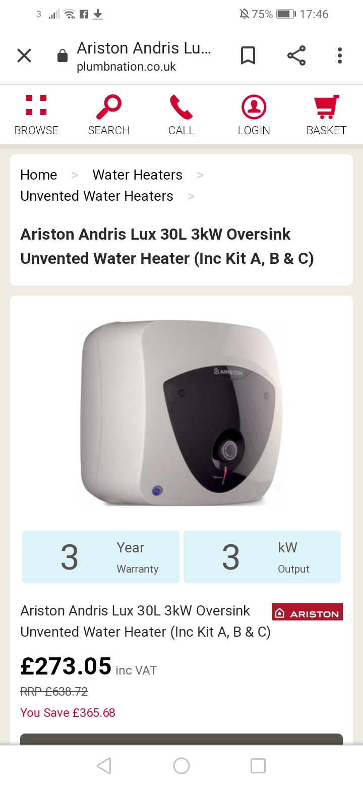

Could you in anyway run a shower of this?
You could, but it would be a very short shower, no more than about 4 minutes
Thanks so really looking at a 10litre cylinder for a shower then.
It's the kw rating you need for a shower to work properly. Electric showers have very little storage but heat the incoming water quickly.
