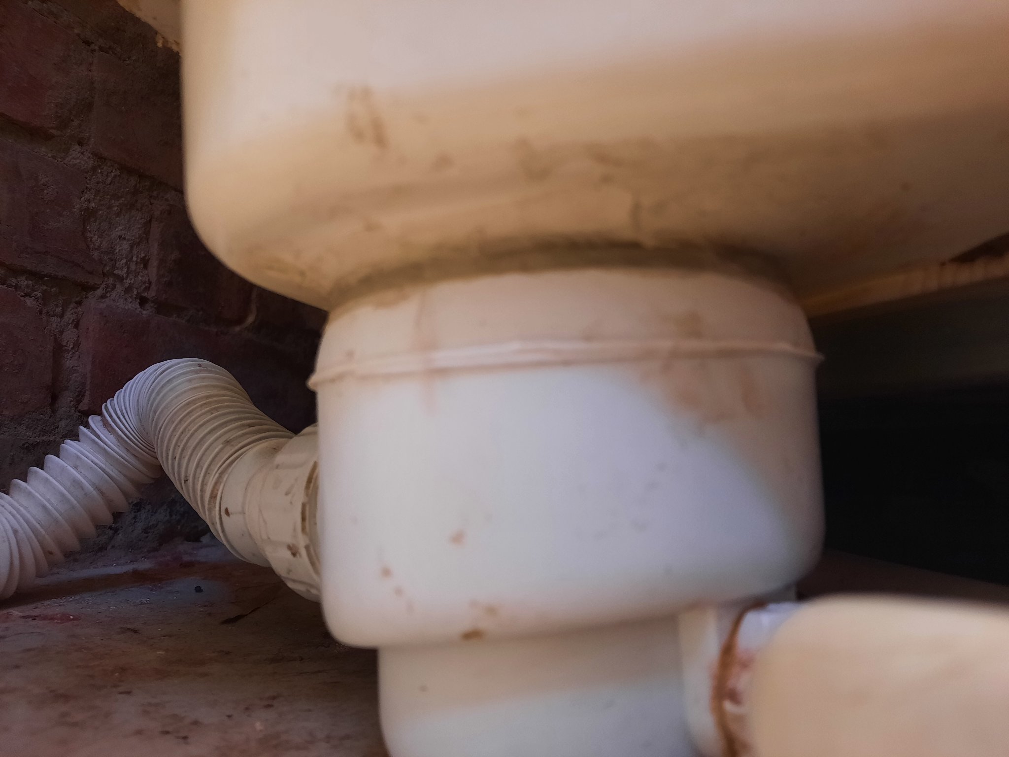

I've been fighting a loosing battle with the shower drainage. It always forms a small lake in the shower. I was hoping to get into the trap and give it a thorough clean. Can't really see how that it done though. The top bit, inside the tray, appears to be a single piece of plastic, sealed in place. The bottom does appear to rotate around a seal. It's a Megios shower from the 90's and appears to have a bespoke trap. Before I pull any harder on it, does anyone actually know how it's mean to come apart or any tip for cleaning it?
I've come up through ceiling then floor in the past to get waste access.
Tray side it may unscrew. I don't know for sure from photo.
Matching tray and waste is not uncommon and a pain. Often get discontinued.

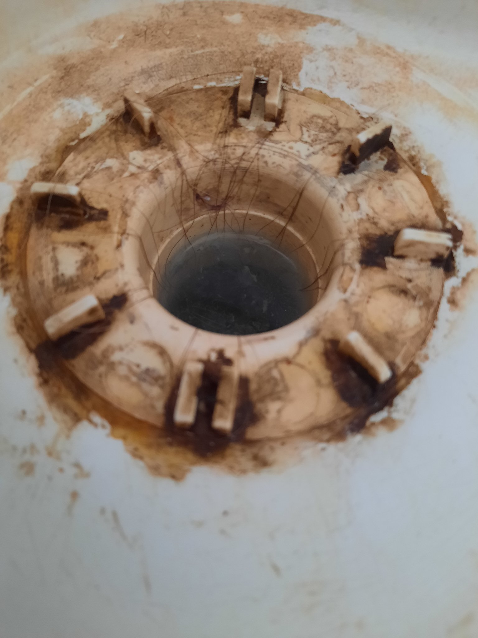

Can you take a photo of the waste from above, with the grill bit removed?
BTW, I am not a plumber.

Those kind of traps normally have a middle section which can be lifted up from above. Hence I asked for photos from above.
My money is on the flexible connection. Perhaps undo this and see if there’s a blockage there?
Thanks for the info. I have had the flexible hose off and a quantity of hair does tend to get caught there. Doesn't do wonders to improve the situation though. I've also tried some unblocking fluid. Again, it improves things but it's still not amazing. It would be great to get inside and see what's going on.

You can't get it off and say cleaning the pipework hasn't helped. Change it, for a few pounds, and then you know the trap isn't an issue. A modern one will be easier to clean in the future.

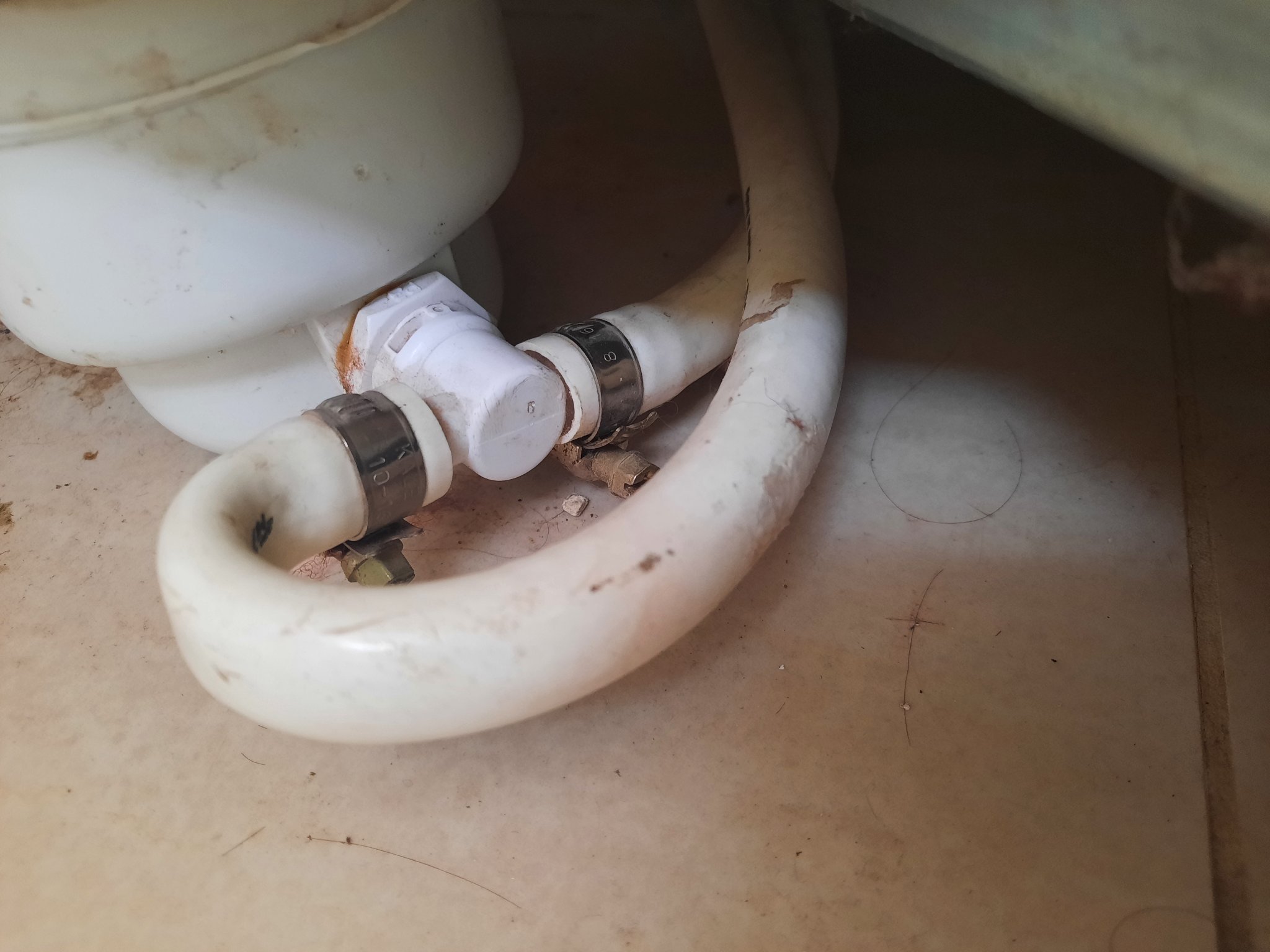

One other thing, it wasn't 100% clear in the previous picture but there's also a couple of hoses that couple into the trap. I'm assuming I'm unlikely to find a replacement with such an attachment point. Any tips for alternative mounting options?

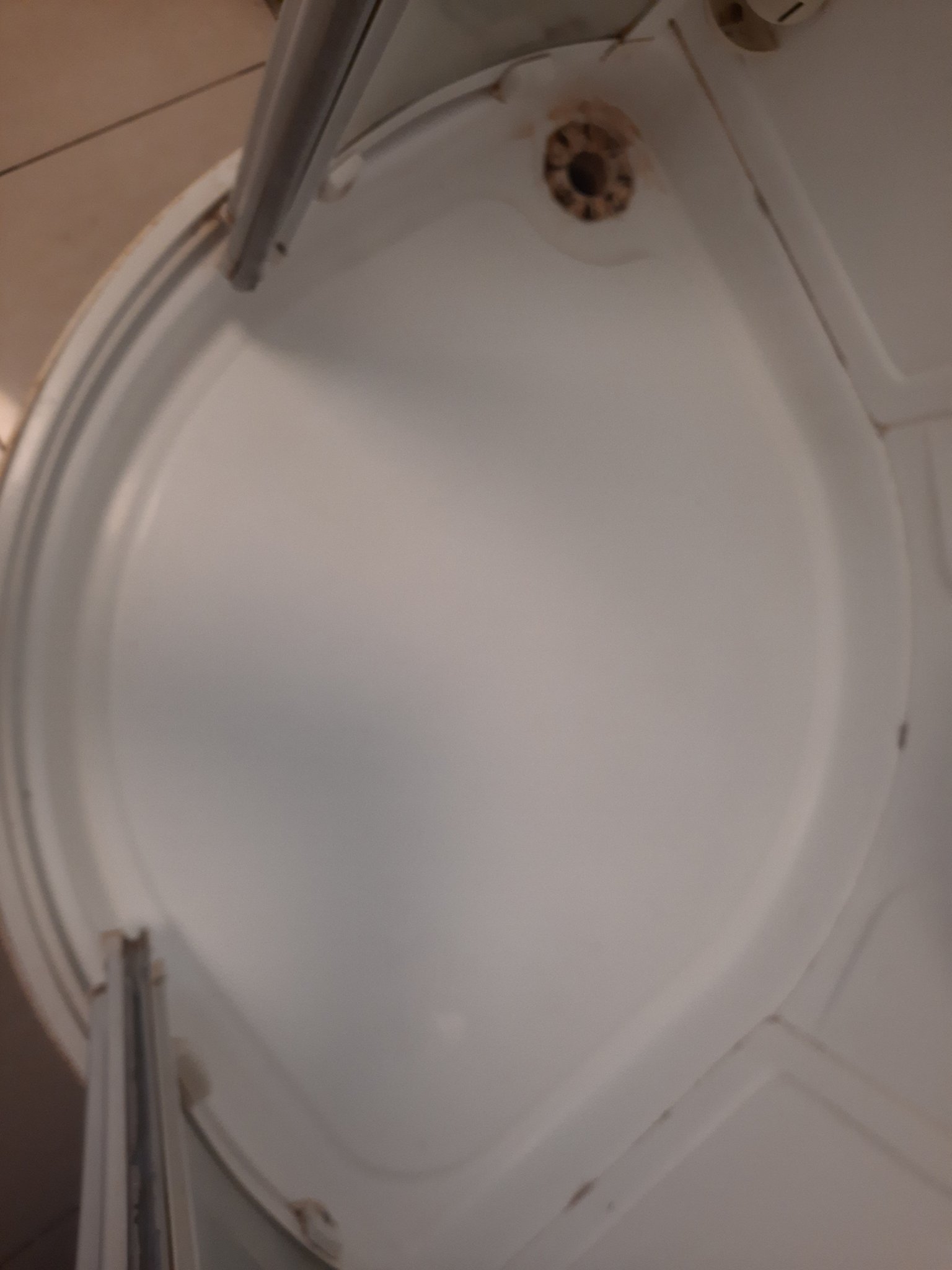

Where do those 2 pipes comes from, are then connected to another part of the tray? Can you take a pic of the whole tray from up top and a closer one around the trap below, where it meets the tray?
The waste section of the trap inside the tray, with the raised parts, looks to be siliconed in, you need to see if that can will loosen from the trap underneath and then the trap can be removed, you do need to know where those 2 extra pipes come from and what they may carry though, if anything. They may just be anti vac inlets to break the suction and aid in drainage.

The two pipes go to the workings of the shower around the back. I surmise that they are something to do with the built in steamer.

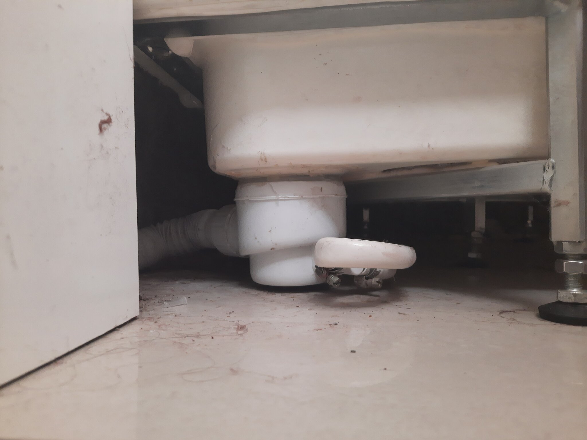

I have had the pressure washer through the pipe from the drain all the way up to the flexible hose, so I'm sure that the pipe isn't the issue.

Your flexible connection is running uphill which might be your issue
