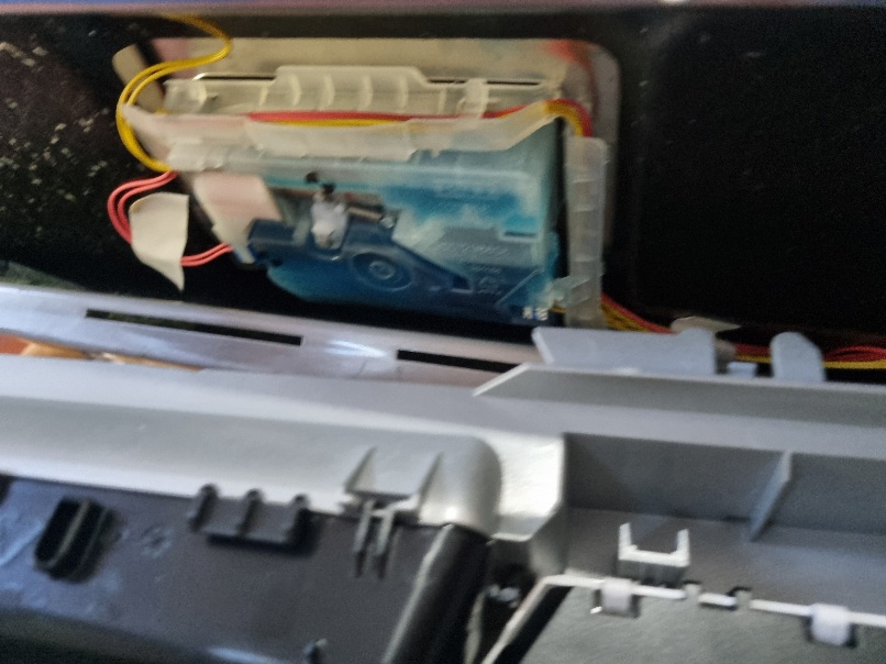

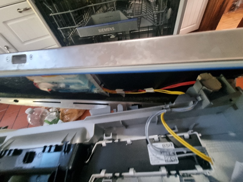

Hi,
I will be very grateful for any advice regarding our Siemens SE23H160AG/01 which has no power.
I tried unplugging it & pressed power & reset buttons but it has no power.
Previous night it worked but there were no lights on the panel & today there are no lights & no power & no error codes.
The socket is ok & plugging it into another socket does not change things.
10 A fuse has continuity with Multimeter.The door closes with nice clunk.
I opened the panel & there are no burnt or loose wires. I have attached the pics.
Is there another fuse in the dishwasher? The non-contact tester shows power coming into the cable but not in the panel.
I will be grateful for any suggestions to trouble shoot & get it working.
Many thanks

Thermal fuse. Test it with multi meter like any other fuse. I don't know where you will find it. Probably on control board
Did you check if there is a ribbon cable between the door and the machine they often break at the bottom where they hinge
Can't see an obvious thermal fuse & there's no video on YouTube to point to one. Thanks
The main power board is back bottom right, the mains cable plugs in to it. If you can get it out and inspect it for the power chip and resistor failure that the Neff,Bosch, Siemens dishwashers comonly have.
