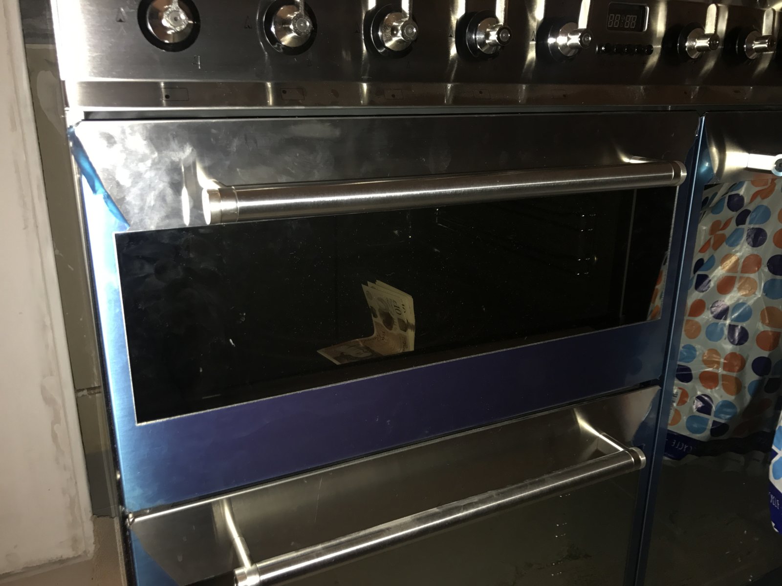

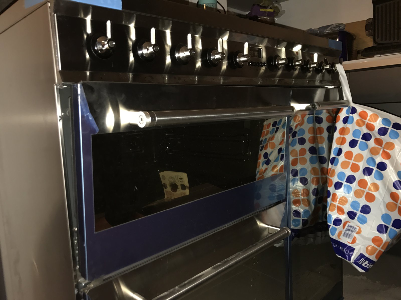

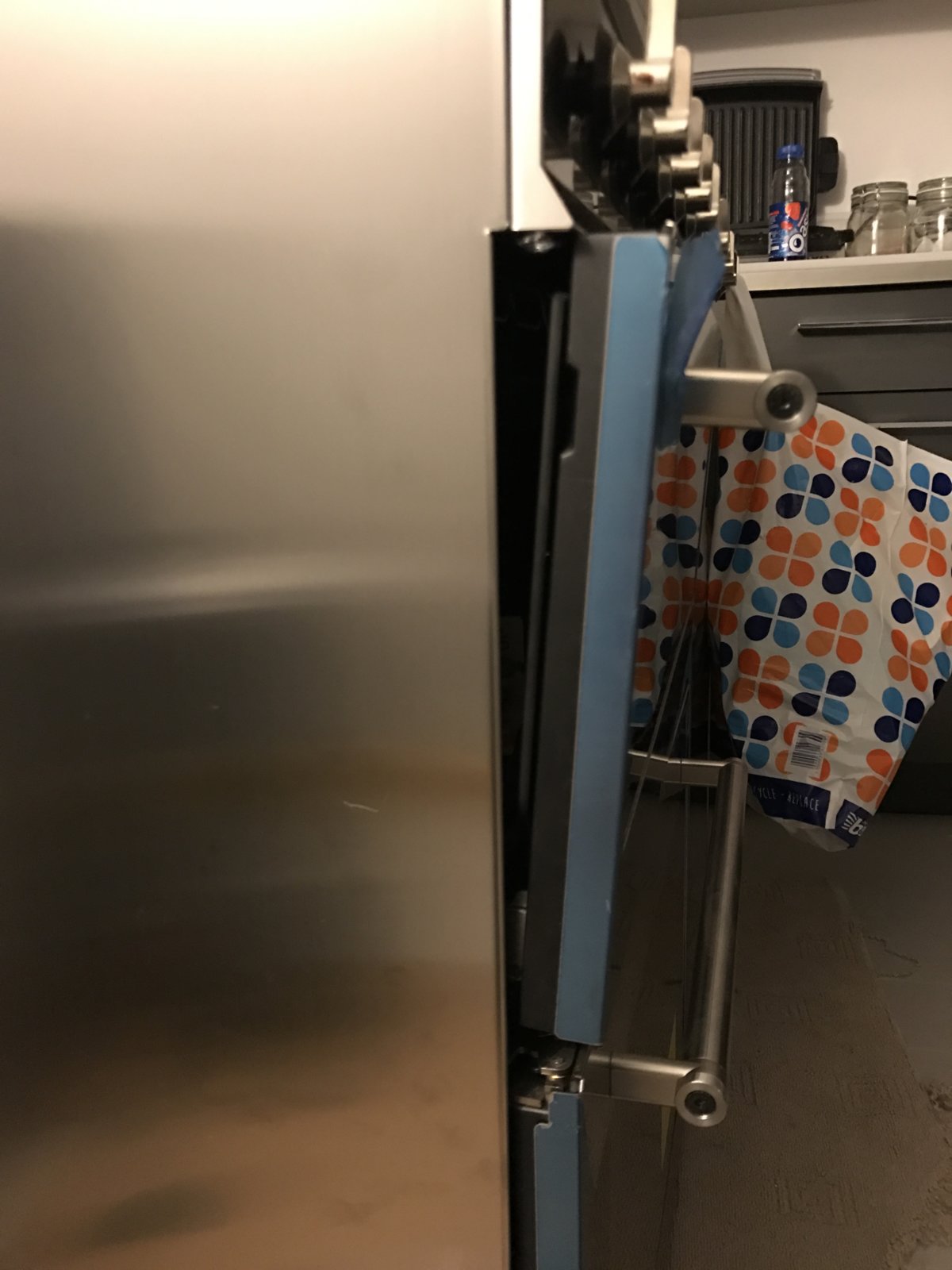

I just tried to pull the oven out by the doors and one felt to slide out and now doesn't close.

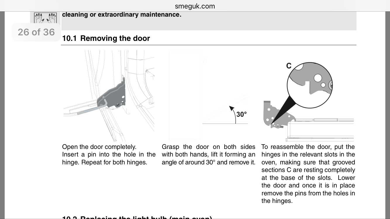

I can't see anything on google so wondered if anyone knows how to adjust the doors?
Oh and it's new so I'm in trouble if it's still like that in the morning.

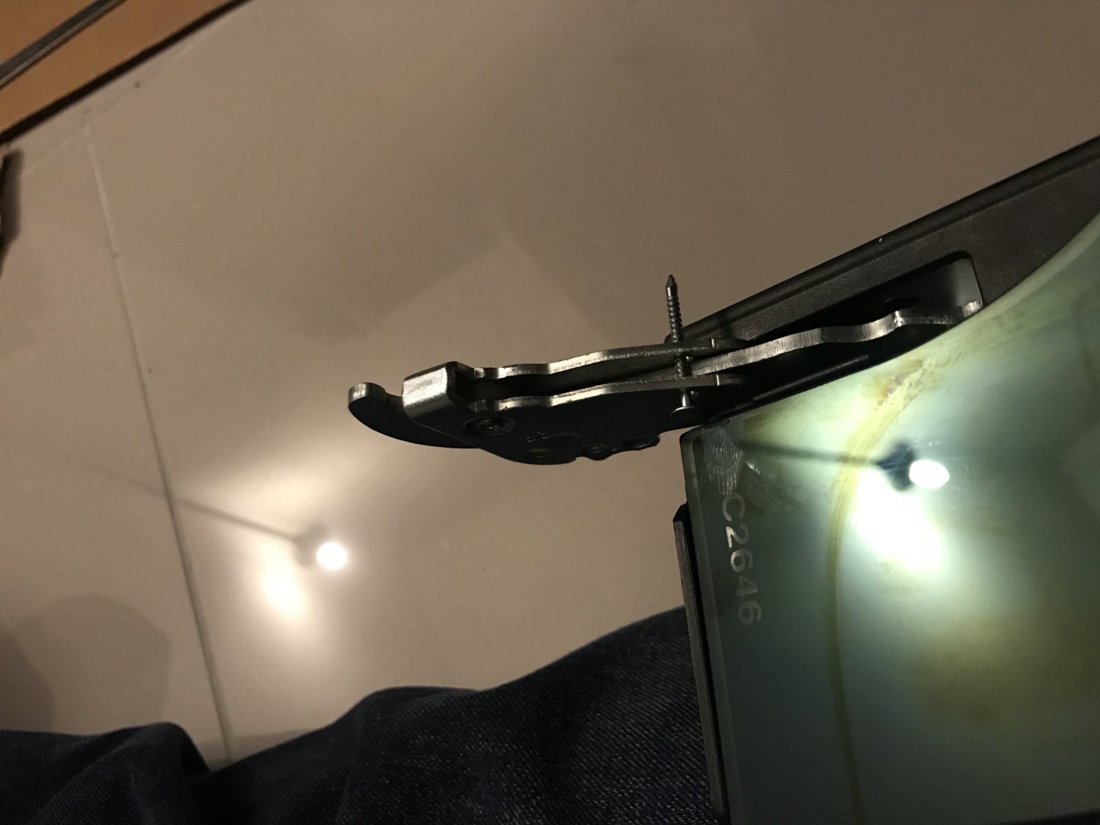

Ok, sorted it. I just took the door off, put it back on again and it's straight.
