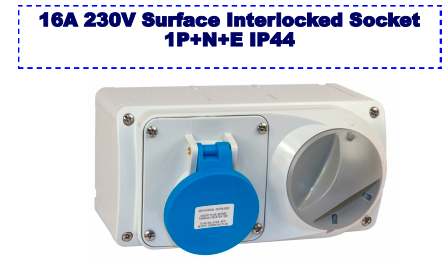

Interlocked - as in you can't have live contacts accessible. If the plug is out, then power is locked off; if power is on, the plug is locked in.
Essentially the same function as shuttering - just a different route to achieving it.
But the interlocked sockets I've seen only stop the plug being inserted or removed when switched off, nothing to stop it being switched on with no plug inserted. After a hundred operations all of the flimsy nylon strips have failed anyway. Very unlike a 13A socket.
But the interlocked sockets I've seen only stop the plug being inserted or removed when switched off, nothing to stop it being switched on with no plug inserted. After a hundred operations all of the flimsy nylon strips have failed anyway. Very unlike a 13A socket. My "known" experiences are resticted to MK & Gewiss although I used others.
Interlocked sockets are equipped with an integral switch ensuring safe electrical disconnection and isolation. In order to prevent disconnection of the plug and socket coupling under load, it is not possible to turn the integral isolator switch to the ‘on’ position until a mating plug has been fully inserted. The plug cannot then be withdrawn until the isolator has been selected to the ‘off’ position

Ok I get that description but in my experience it doesn't apply to the MK or Gewiss unless they have all been faulty.
The very early interlocked sockets where the plug was inserted and turned clockwise about 45° were fine but they went out of fashion a long time ago.
I don't think I have any interlocked sockets at the moment as they are too big for portable work.
Fair enough. I have no experience of any, so cannot comment - I just remembered that the Lewden ones (which are what I posted) had the functionality described above - which (assuming it works!) sound very reasonable.
Kind Regards, John
