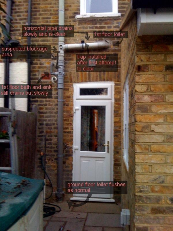

The top half looks to me like Solvent Weld. I agree that this waste pipe in the strap boss may be protruding too far in. I would rod up via the access door at the bottom, but stand to the side. If you have to cut anywhere, cut out the branch, clear both ways and then replace it with a ring seal access branch - that will enable you to rod the horizontal section in future. All you will need to do that is one ring seal access branch and two double sockets - all push fit. Good luck.
