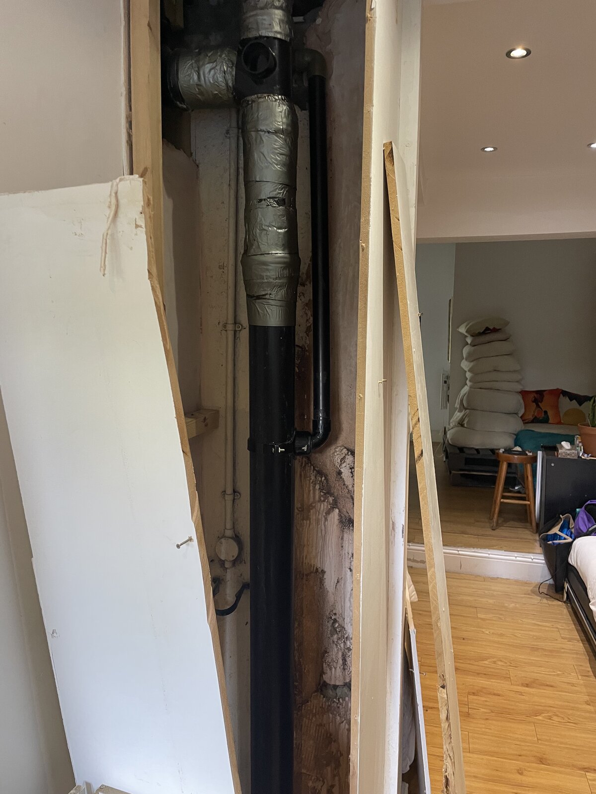

My sister had a leak and opened the box around the soil pipe - It looks like it was repaired before and the leak was from a loos joint.
Is there any tape that can be used around the joints before the box is put back? Is gaffer tape suitable to provide a tight water seal? I tried the self amalgamating tape but it wasnt very easy to use and I did not feel like it covered the area well enough
Should I really be using flashband on this soil pipe or is there a better tape to wrap round the joints just in case there is a leak before its decorated and boxed in
If the stack and soil pipe has been fitted correct - I.E. a male end into a downstream female end then as long as the seal is ok then it shouldn't really leak. It would only normally leak if the soil pipe was backing up so the joints were immersed for a length of time before the water ran away.
I'd be getting all that tape off and have a proper look to see where it's actually leaking from and why. Then as suggested it can be repaired properly.
Landlord responsible for service pipework ?
It does not look like it is leaking but I worry that if I take off the flashband then I will expose a leak and I prefer to tape over to give it a further level of protection
Is there no waterproof tape that can be applied over joints ?
