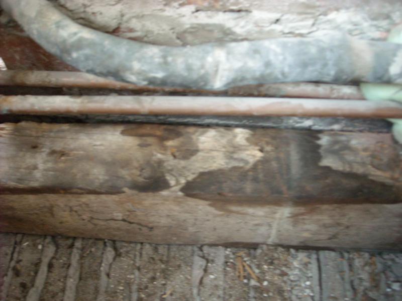

I'm ripping out the old T&G pine, ready for 25mm ply for tiling on.
The end joist, shown in the pics, has some dry rot present along the top edge. This can be seen in the second photo, at the left hand end where it's about 1/4" deep. It has also penetrated where nails have held the boards down.
This is probably a combination of water getting at it (it sits under the pipes) and poor ventilation.
I need this sorting fast, would the application of a decent timber treatment (cuprinol) stop it spreading through the joist?
I can improve the ventilation in this part of the floor also, is this recommended? And I can most certainly prevent moisture getting to it by sorting the plumbing good and proper!
I'm off to get some Cuprinol now, however I could do with your suggestions. The joists are 5"x3" and this one spans about 6 feet.
you have to cut out and replace all affected timber, and timber in contact with and beyond the affected part (wrap it in polythene to carry it away for disposal, vac up the dust). the spores and roots are very pernicious

I'll get more of the boards off and see how the rest of it looks. Is there an easier option than replacing the whole joist?

I've only had wet rot myself. Do you see tendrils, fluff, red dust, fruiting bodies, cubical cracking of the timber?
Poke it with an old screwdriver and see how deep it goes. It may have travelled along teh laths of the ceiling below.

Approx 18'' of the end joist (4-5 board widths) are affected at the left hand end of the joist as indicated in the pictures in the OP. At the other end of the same joist, there is an area mildly affected which is about 1 board width. This lies below the toliet supply plumbing. There are none of the characteristics which JohnD has described to indicate the presence of wet rot; from previous experience in my parents house this looks like dry rot.
Anyway, the remainder of this joist (a good four feet, and the other joists seem sound, when poked hard by a screwdriver.
I am endeavouring to vacuum up the dust but can't get the nozzle into a tight space behind the affected joist.
I have acquired ronseal treatment, as I could not get hand of cuprinol. According to the 'strapline' this should do exactly as it says on the tin (so I won't go throwing it in rivers ;)
I will treat all the timber I have uncovered in the floor and the L+P ceiling attached to it for now and see if any further advice pops up. Boards are off for chiminea fuel (when the bl**dy sun comes out!)

Can't see any signs of dry rot in that photo. Just wet rot that has dried.
To be honest I was thinking the same, it doesn't really look like dry rot. Another name for dry rot is "cubic rot" because simply put the timber forms into little cubes as it is attacked and moisture is drawn from it. Internally you would normally find the mycilium or fungus threads running between the cubes and the whole thing becomes fragile to touch.

both dry/wet rot do cuboidal cracking.
Dry rot still needs moisture to continue to grow, what it does however is transport moisture from the wet areas of timber, to dry areas of timber allowing itself to spread. The fungus will also possibly take moisture from the wall, and transport it to the timber though it's ability to do so is limited, but the masonry itself should be dry or isolated from the timber.
If you remove the source of moisture, and dry the timber, you stop the dry rot. The spores are already present in nearly all buildings and the air itself, so you don't need to treat chopped out bits of timber like they are highly infectious.
The general advice of chop it all out +500mm of sound timber, is just that, general.
In many historic buildings such advice would be considered far to inappropriate. Often the dry rot itself is scraped away, (and where the beams are exposed and aesthetic, new slivers of timber is spliced in or resin repair is used), and the drying of the timber is closely monitored.
Treatment will at most penetrate a few mm's, it is only used to help protect the timber during drying. Even rod injections are limited and generally unnecessary.
If the other joists are not showing signs of moisture, it is more likely leaks or condensation from the pipe dropping water onto the beams top edge, extra ventilation of the floor should not be necessary, instead fix the leak or lag the pipe.
If I understand you correctly the rot is only 1/4" deep on the top of the joist, scrap this away, dry the timber, and re-level the surface of the joist either with resin or timber planed in to fit. The rot will not become active again without a source of moisture.
