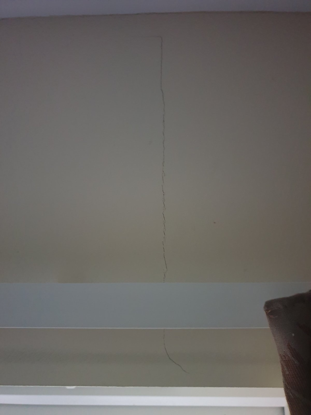

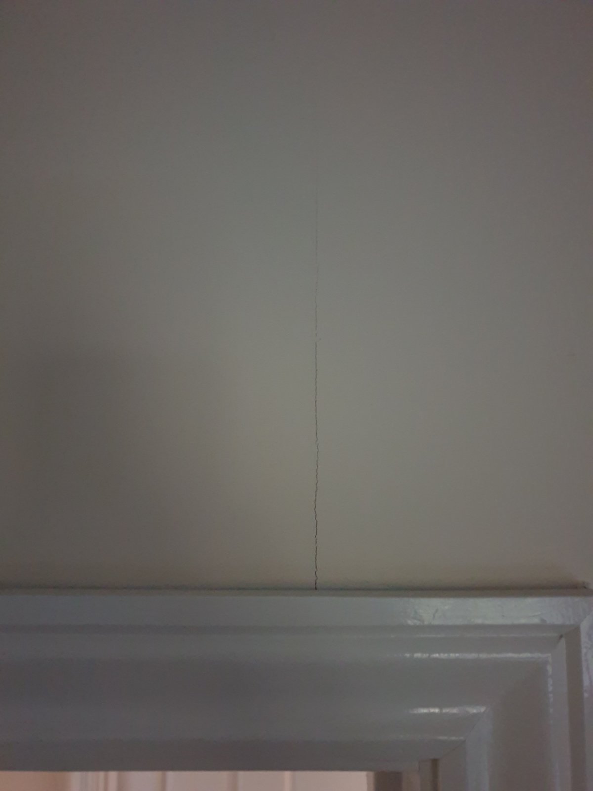

Hi,
We have these kind of cracks above most doorways and windows in our house.
It was a new build in 2012 and I'm just putting it down to a bad boarding job (unless anyone knows otherwise). The walls aren't plastered and I think the cracks are at the board joins.
There's a million different videos on the internet all offering different solutions, but what's the best process and product for a uk house?
Thanks!
Those kind of cracks are particularly awkward. If you rake them out you will damage the "scrim/jointing tape".
In the past I have brushed PVA in to the crack and used very thin adhesive jointing tape and then EasyFill over the top using a 12" filling knife, sanding back when cured.
Alternatively I just line the whole room, the lining paper hides the hairline cracks.
