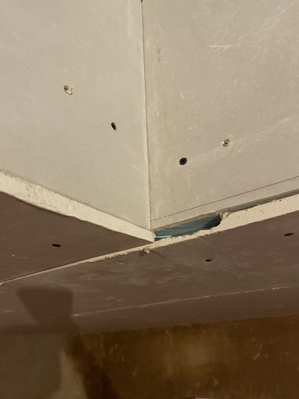

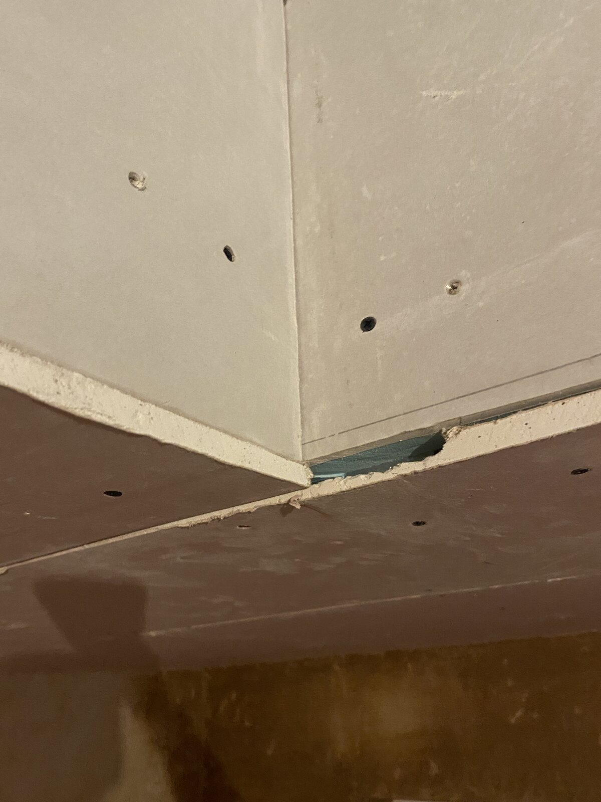

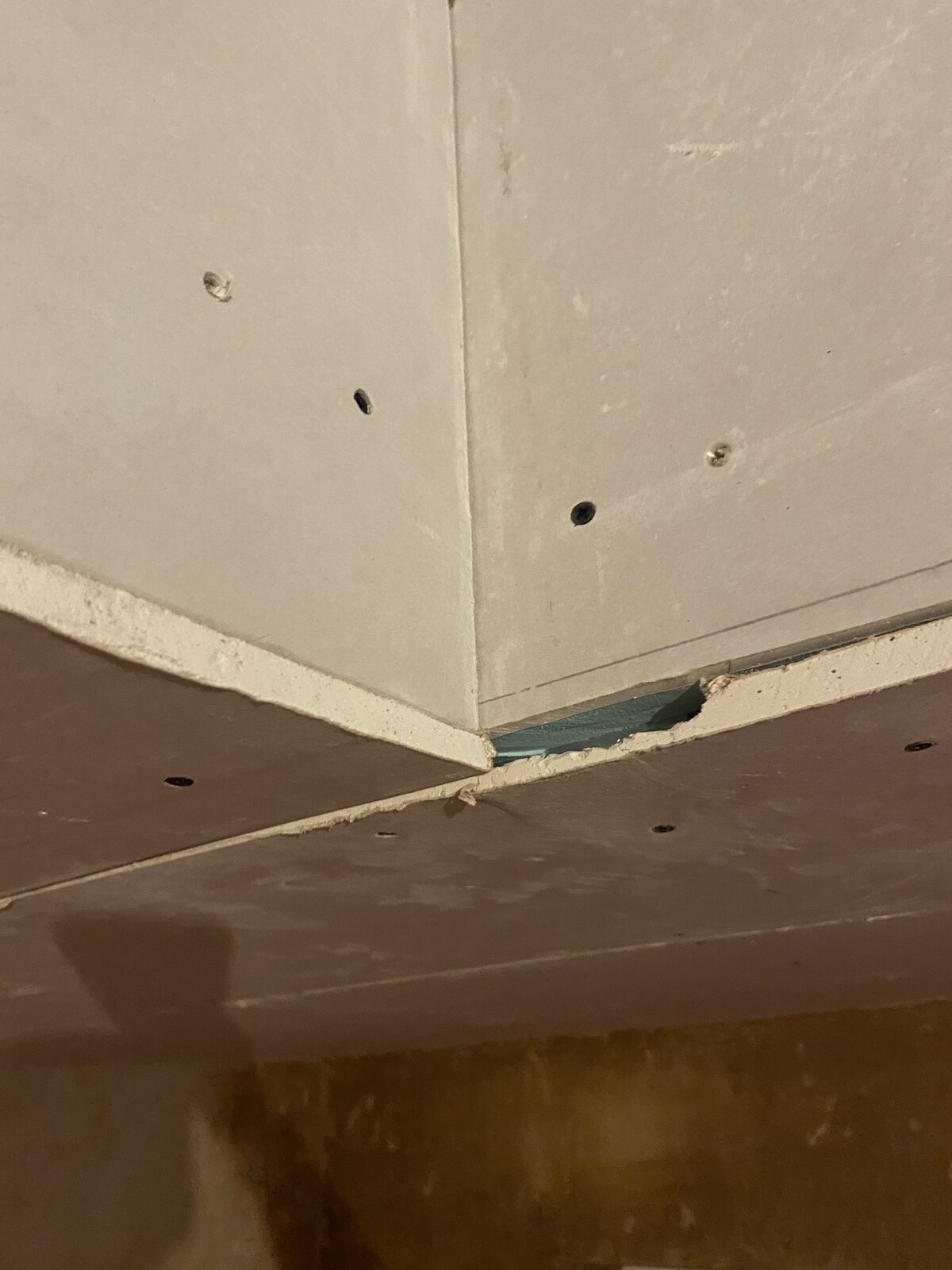

Hey guys,
Where I have heavy duty joist hangers in my flat roof, the plasterboard around it has a slight bulge to it. I feel it’s too much to even out with plaster.
How can I resolve this? Notch a bit out of the back of the plasterboard to accommodate the hanger, or just rasp the top to flatten it?
Although it’s fire PB, it doesn’t actually need to be.
Thanks in advance
Andy
Thanks guys, the upper screws are wrong. That's an upstand for a skylight. That particular plasterboard has 35mm of insulation on the back of it and at the time of fitting I didn't have the correct PB screws for the depth, so it was just temporarily fitted with wood screws.
Think i'll try gouging the back of the board. Ta
Looks like its going to be tight as the backside of the plasterboard is already level with the rest of the ceiling if that don't work then maybe adjust the hanger
Was a bit of a faff, but much more lever after gouging. Still a bit of a bump but I should be able to sort that out with the skin.
Extra long PB screws for the skylight sorted too :)
Thanks folks

Have you thought about packing the other sheet of plasterboard out To level it out ? either that or level it out with bonding before skimming
