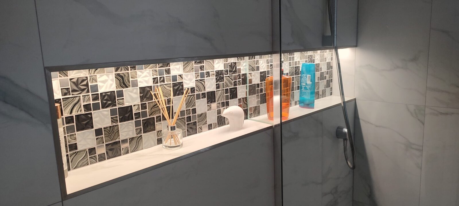

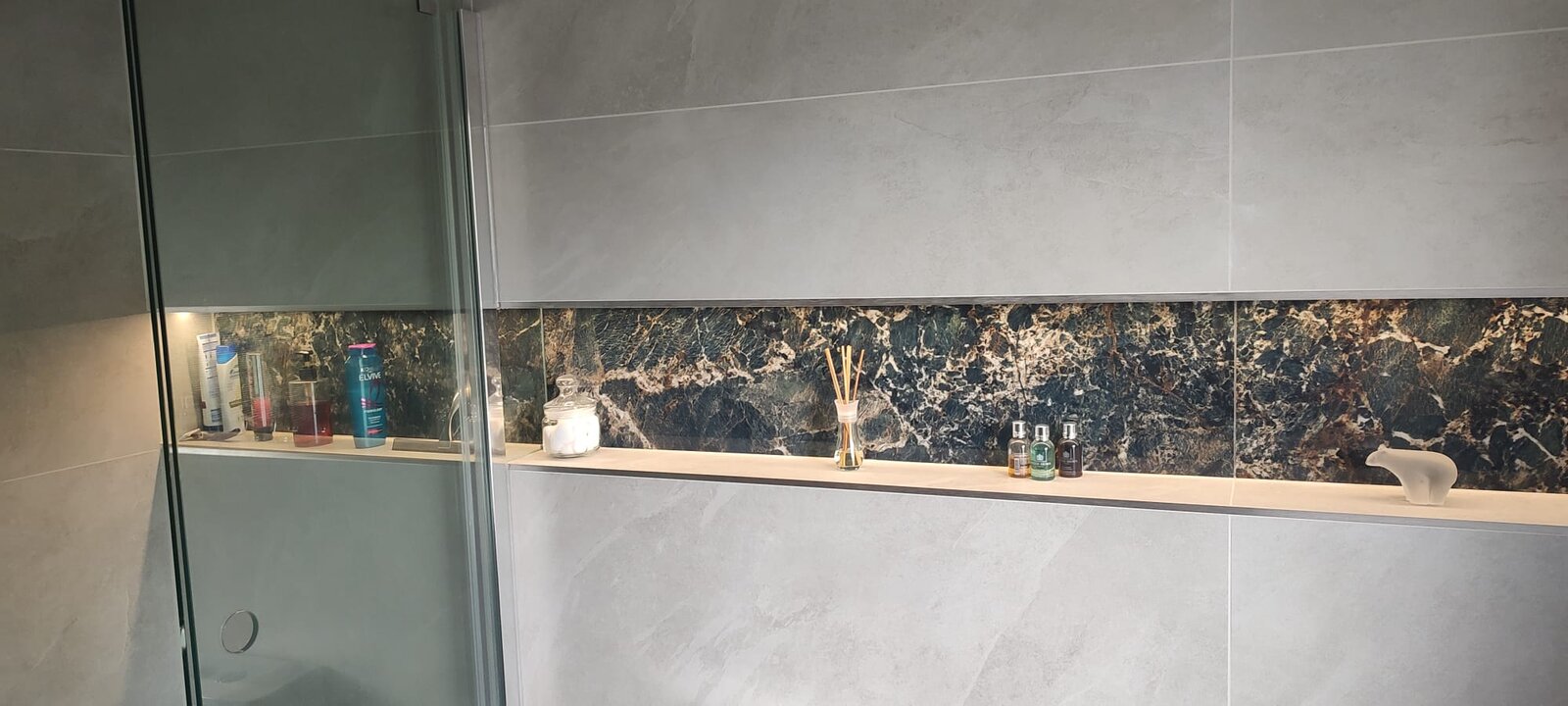

Try your local glaziers. I was trying to find two bits of glass 300x135 for our shower niches and the rules insist on safety glass - online the best I could get was £120.
However, this was a 10mm piece of glass and that size and location there was no way that it needed that. So I went to my local glazier and he cut a polished two pieces for me - £16 each
For shelves you could get away with thinner pieces - depends on your risk tolerance

Credit where it's due - you've done a really nice job
