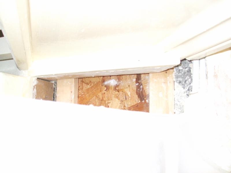

We (She) would like to change hte ballusters, the requirement is for Oak or beech and intending to Use Burridge parts (Fusion) but the existing Newels are white pained pine and too short (but I could cheat by using longer newels.
Photos of stairs are Stairs are
and
The top newels (at least one) sit on an engineered joist which itself sits on a block wall, I can get a screwdriver under bottom of the netwel. First one is on its side.
Now how difficult will it be to change the newels? Presumably lift out stairs, change newels, refit stairs????

You may get away leaving the stairs in situ and swapping the newels / base rail / spindles / hand rail. I have done it with the standard Burbidge range but not the Fusion stuff.
Budget to me means what I am prepared to spend to do it.
Newels I can deal with BUT the newel bases are pine and too short and can't see how I can change them without lifting the stairs out.
