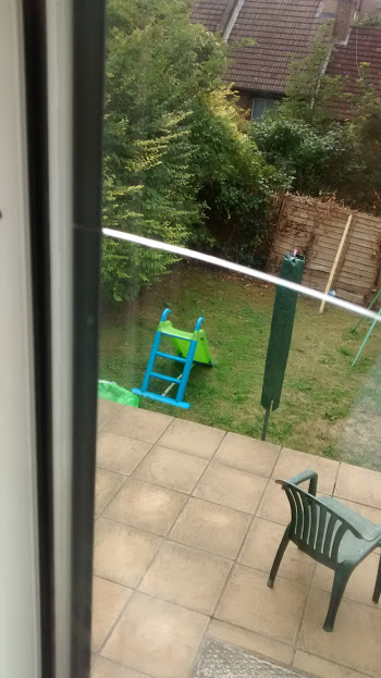

I've got old steel type double glazing and I've managed to crack the glass and was wondering how to remove the glass so I can get a replacement.
ive previously removed upvc glass panels before which was quite straight forward but don't see any frame work that's removable on this window ??
any help much appreciated. here's some photos

So all you have holding the DG glass is rubber strips? If these are same as my shopfront windows, then all you need is a Flat putty knife something similar. Push it between the glass and seal and pry away, as you gently work along a small length of the seal.
Best to start in the corner, and at least that way once you've started you can just use your hands to pull out the entire single length, and just repeat for all four seals, but leaving the external ones in place, unless you wanna clean them?
Without looking like you have OCD?! ;) place the seals on the table/floor in a preferred order, so when you come to putting them back in, you have the correct ones for their original place. (I don't know why, but replacing them I got the feeling they were longer and I might have mixed them up?! :/ haha )
Replacing is just the reverse; start at one corner and push using your finger and thumbs and using a 1x2 piece of wood, push it along the seals. Ideally you might sped it all up if you put some fairy liquid on the glass, help the rubber seal move better.

Cant tell for sure without an external pic but it looks like you have externally beaded aluminum windows with an internal wedge gasket.
As above remove the internal rubber gasket and this will allow the beads and then glass to be removed from the outside
