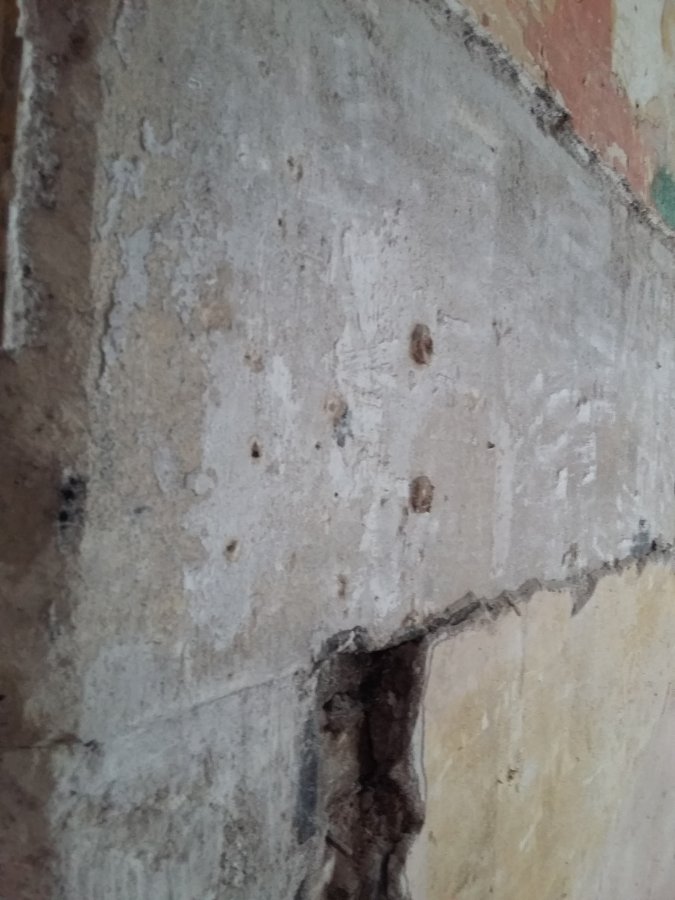

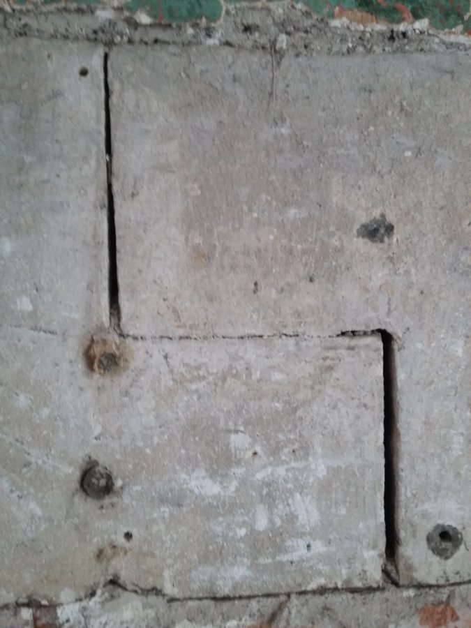

Thanks for your replies. Yep, its definitely limestone having sanded it a bit to check - pics below show better the centre join and dowels, and the join between sides and top of the stone. Its in a 17th century cottage so goodness knows how long its been there, I assume its been like that for quite a long time. I guess the concern is when it was bricked up whether they also did something to weaken it at the same time like removing dowels etc. My plan going forward is to acro prop both 'sides' of the joint while removing the bricks and then slowly ease them off to see if there is any drop/sag.

Like others, I've never seen that kind of joint before - usually it might have a joggle and/or a keystone?
Perhaps there is a joggle on the back side?

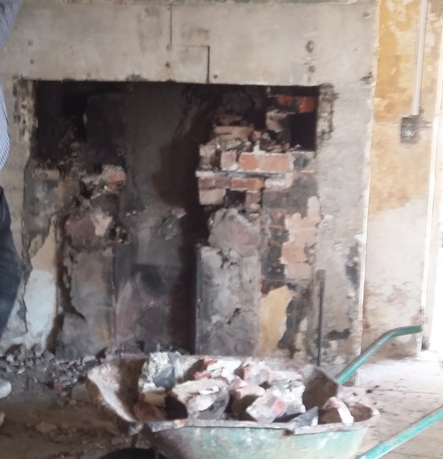

We started to remove the bricks today, current state shown below. There is no joggle visible on the back side so far, so I think it is genuinely an unsupported two-part stone lintel. The plan is to install an oak lintel underneath the stone, currently underpinned by props although the structure does still seem to be self-supporting at the moment as you can see in the photo!

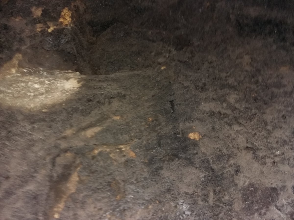

Finally cleared the fireplace today. For info, on the inside of the chimney above the join is an unloaded 'gap' (pic below, you can just make out the join below the gap). The weight is being distributed in a triangle towards the edges above the 'lintel' so that almost no weight is actually placed on it, loading the sides of the chimney breast instead. Has anyone else seen a design like this?

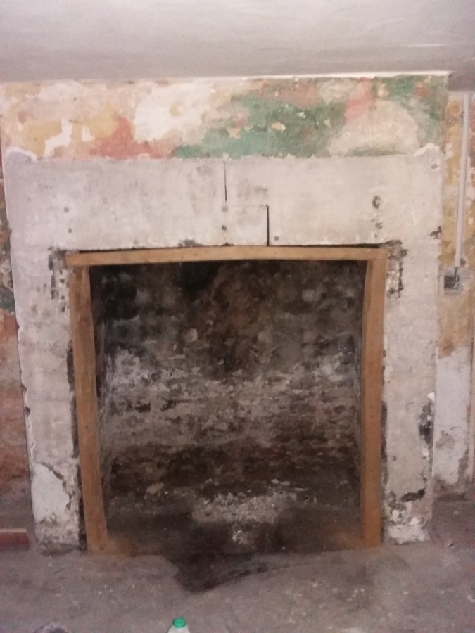

Nonetheless we've put in a wooden support structure for the moment (pic below) until something more permanent can be done, probably involving an oak railway sleeper cut into the sides.
