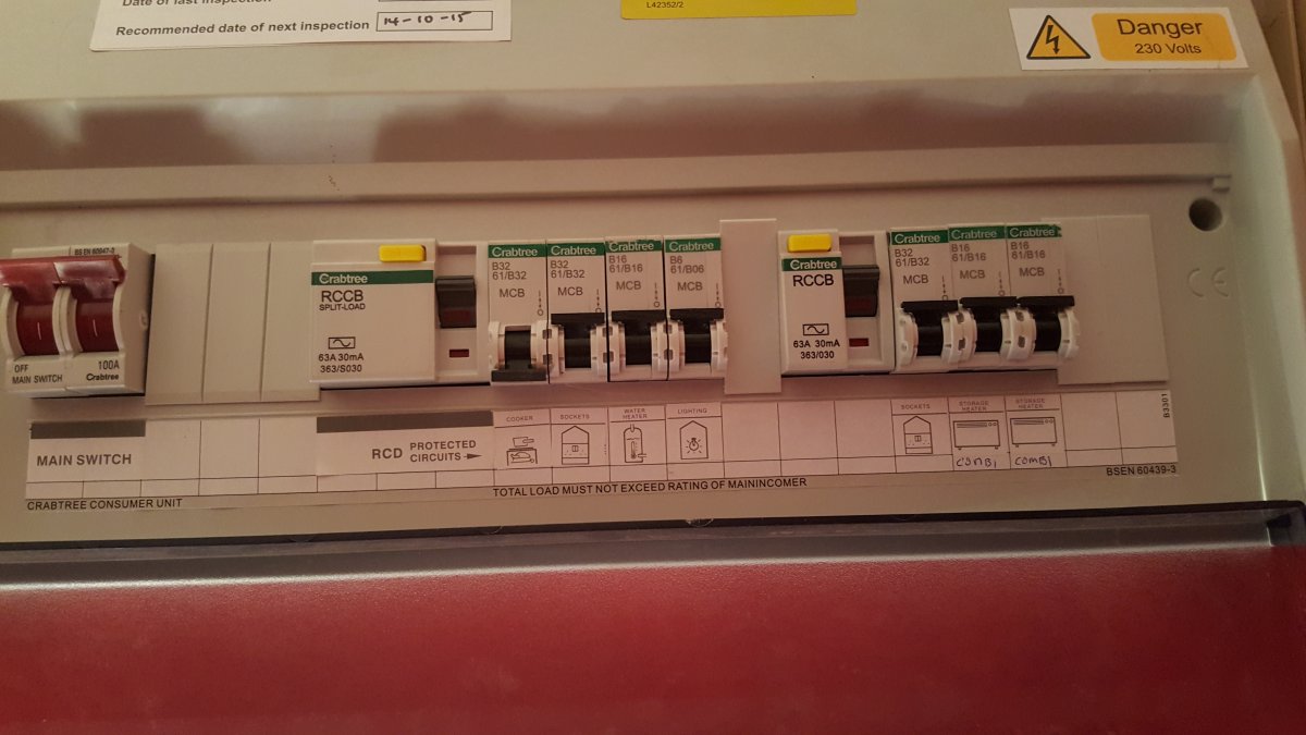

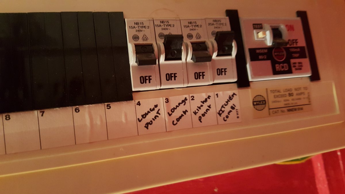

Hi I've recently moved into a new flat. I have these ridiculous old creda storage heaters. I can't get them to come on . There meant to come on at 12.30 on economy 7. There's a converter button which does work. But that just blows out hot air and I imagine expensive. Any help ? Gemma
If all of them aren't working then it's more than likely a supply problem at your CU. Are all your 'trip switches' in the on position?
I have one in kitchen and one in lounge. Only the convector button works on both. I'm not sure as I have 4 boxes on the wall and I'm not very good at this stuff. I'll try attach some photos
Pic 1 is your on peak board. Circuits marked storage heaters on this is the convectors in your heaters.
Pic 2 is your off peak board. Push all switches up.
Pic 3 is your switch fuses. Guessing the one on the left feeds your off peak board. Push that up also.
There will be double pole switches by your heaters as well which need to be turned on.

All the consumer units in your pics have RCD/RCCB protection, a safety device required by today's electrical regulations, which will kill the electricity long before it kills you, should be perfectly safe to turn everything on as previously mentioned. Should any of the breakers 'trip' off, then that is a sign of a fault and the cause inspected and remedied before resetting the breaker.
Ok the switches are all on. I'm still Alive :) I'll see if they come on at 12.30 now. Thanks very much guys
