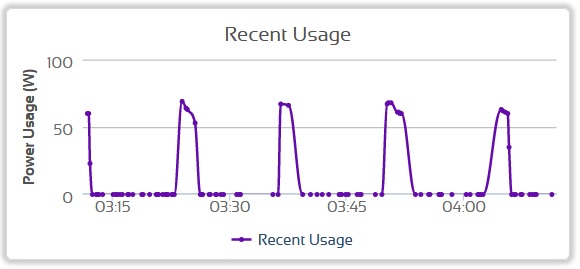

I have three, one is a cheap stand alone unit which is very good, the other two are internet linked one also switches and to be frank in the main they tell you less than the cheap one, the one way they are better is it auto works out average watts, and gives one a graph of the use, Recent_Usage_freezer3.jpg the graph shown is a freezer, I can see the motor runs for around 1/3 of the time which is as expected, but taking the readings with a stand alone would do the same.
