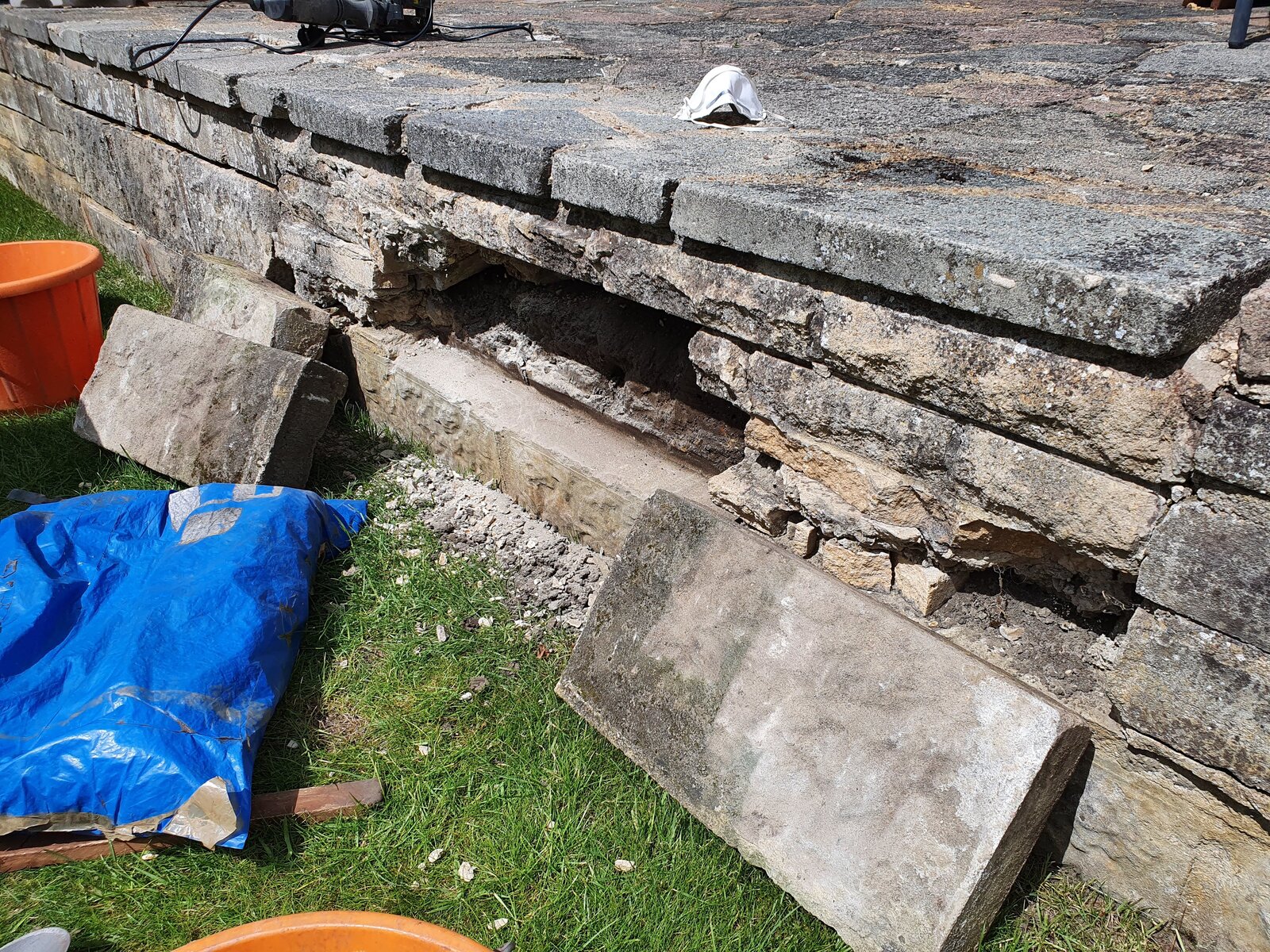

Hey, I need to repair part of the wall that holds up my patio. I'm not looking to do a perfect job because we'll be replacing the patio in a couple of years or so, so I'm just looking to patch things up so it doesn't look unsightly really.
I already have some large concrete blocks which will fill the void perfectly, I just need to work out what and how to fill the cavity behind the blocks (you can see loose soil there right now) and also point the gaps above/under/between blocks.

Thanks for your input @Mr diy a lot. I did attempt to fix the first block in place using some some ready mix mortar but it wasn't secure in the slightest. I think the void was simply to big, the mortar wouldn't take to the soil and the gaps above and below were too small to accomodate much mortar.

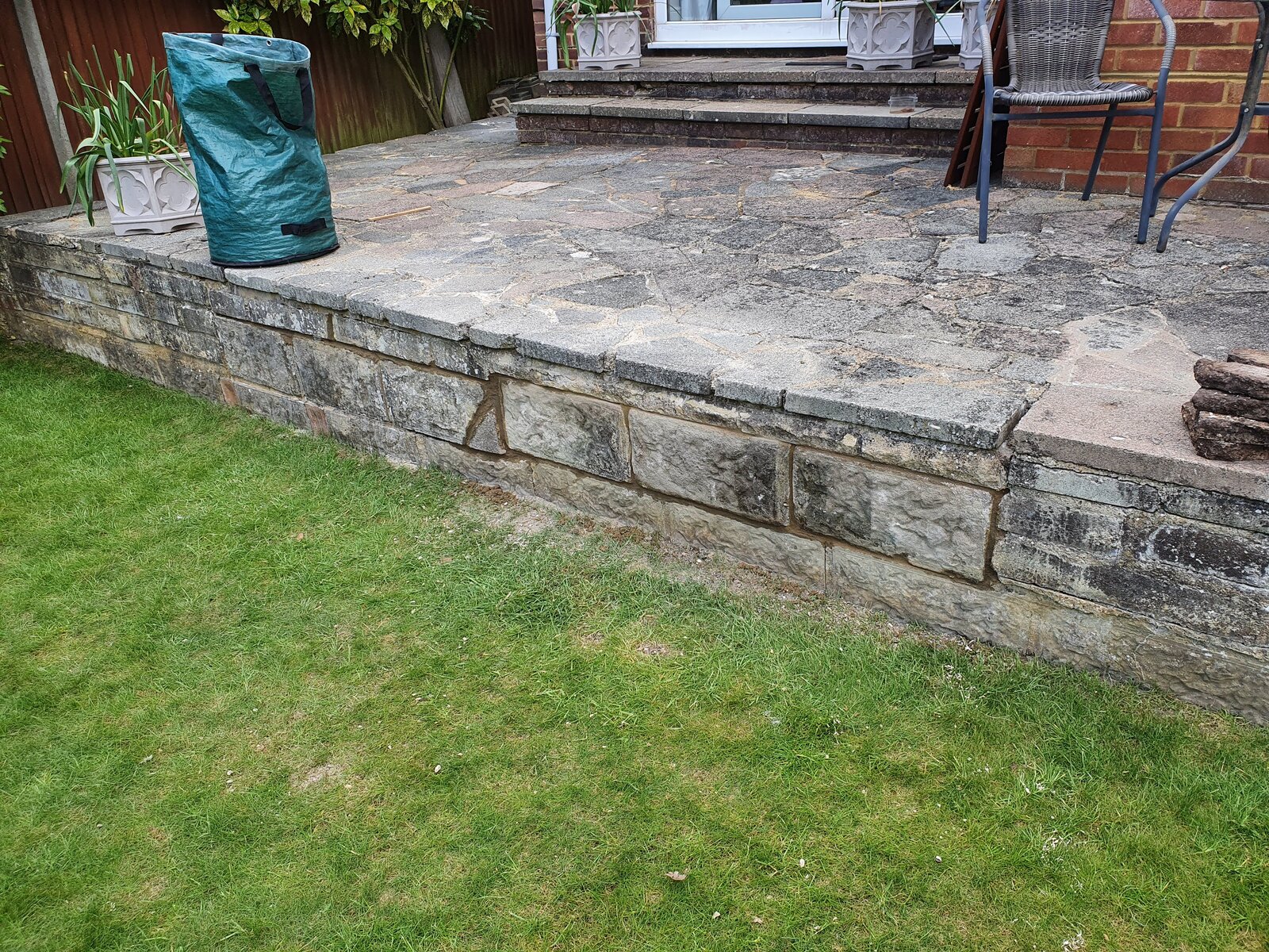

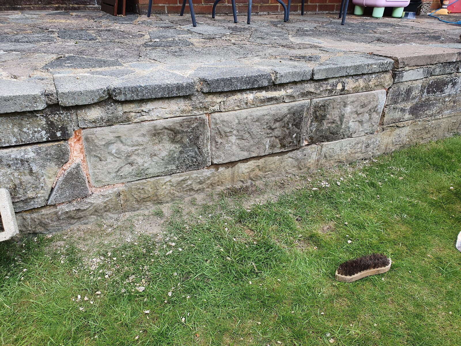

So in the end I bought some Soudal Expanding Foam Adhesive and used that to fill the void and fix the blocks securely in place, making sure that I left enough space to retrospectively point. And then I repointed the gaps with ready mix mortar. Very pleased with the result and pretty sure the adhesive has stuck the blocks securely.
