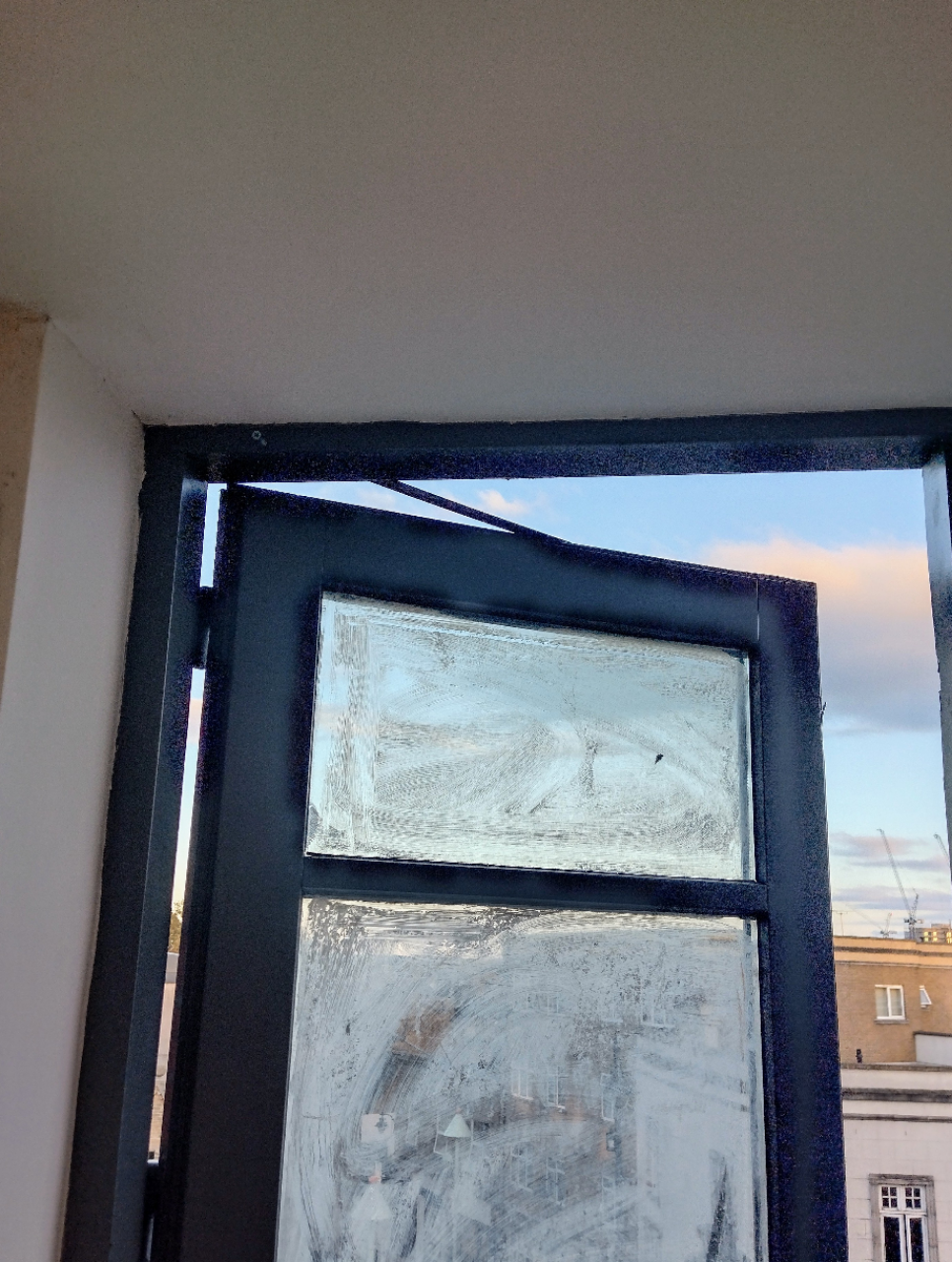

Can anyone recommend a suitable door closer which is also able to hold open the door?
Ideally, something I could just pick up at Screwfix, toolstation, B&Q etc
Door opens outwards
I). Top of door to safest part to drill to avoid glazing is 75mm
II) Top of door frame to safest part to drill to avoid glazing is 80mm
III) Door frame height is 24mm
IV). Underside of door frame (width) is 55mm

Wooden frame, external balcony door (heavy) with large glazing.
Height is 2.16m
Width is 0.75m
I'd want to keep it open every time i cook in the kitchen. Is there a better solution

On my two garage and workshop doors, I have gadgets, which latch the doors open, but only if opened to their full extent, where they latch open. It fits between top of door frame, and top of door, a flat steel bar, fixed to frame, and able to rotate. The bar, run in a bracket fixed to the door. Open the door fully, and the end of the bar latches, preventing the door reclosing. To release the door, there is a pull cord, which pulls the latch away. A bit industrial looking, but very effective.

Also, looking at the picture of the door, was the metal thingy at the top of the door a door stay?
I have one of these on my garage door https://www.lathamssteeldoors.co.uk/door-hardware-and-accessories/spring-stay/ you just push the door open until the catch drops and then it holds it in the open position (mines set to abut 85°) then to release the catch you just push it a few more degrees and the catch releases it allowing the door to be pulled shut.
They wouldn't be much good for my two people sized doors, on my garage and workshop - the wind would push the door, those few degrees. The ones I used, are very positive, and quite industrial. Once they latch, they remain firmly latched open, until the pulled is used to release them.
Mine work on steel doors and are friction stays so work against the spring, depending on the adjustment, about as heavy duty as you can get. Latham doors are commercial really, not really aimed at domestic.
The product you recommended looks brilliant. Thank you for suggesting it.
As it is heavy duty and for commercial activity, I am hoping it can handle the unpredictable gusts of wind which seem to come my way.
