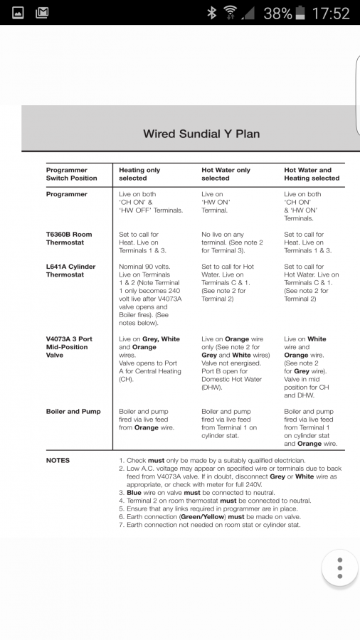

Ok, so symptom:
Central heating does not work at all (no radiators are warm - not even their 'feet', and they've been bled for air)
1) Manual "extra hour" CH set on Siemens pad
2) Drayton dial turned up/down and nothing happens on the boiler (usually it clicks I think)
3) Boiler has a little O-shaped window where I (think...) could in the past see a blue flame (but not anymore)
If I put "extra hour" for HW on the Siemens pad, a blue flame appears.
Hi, thanks for your response.
I believe it's the 1st variant.
I'm not quite sure where to look, but here's a thing I found near the Sieman's pad:
(3 pics of the same thing)
If this isn't what we're looking for then I can look again...

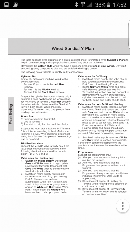

Second time I've posted this today. Best fault finding guide available. You need to determine whether it is a fault with your programmer, thermostat or motorised valve. (The latter being the most probable)
You will need a multimeter.
If you're not confident working with electrics then you should call an engineer.

Valve supplies live to boiler. When the boiler gets this, it turns on. In your case the valve is supplying live to boiler for hot water, but not for heating. Doesn't necessarily mean the valves at fault though. The valve might not be getting the signal to open on heating from your programmer or room thermostat. That's why it needs fault finding step by step
First some theory. At rest, the motorised valve is kept at the 'hot water only' position by a spring. When heating is required, the room thermostat makes the white wire to the valve live and winds the valve across to open up the central heating port.
The easiest first test, which will most likely reveal the problem, is to see if there is power getting to the motorised valve's white wire when the room thermostat is calling for heat. Only if you are capable of doing this test safely, and can use a multimeter follow the steps below.
1. Remove the valve head cover so that you can see the mechanism inside.
2. Set the controls to hot water only. (This is to ensure the valve sits at the hot water only position to start with)
3. Get an assistant to turn on the central heating at the programmer and turn up the room thermostat so that it is calling for heat, whilst you watch the valve mechanism. Does it move?
4. Without changing the settings of the controls, use a multimeter to measure between the blue (N) and white (L) wires at the motorised valve. If you see 230vac and the valve still remains in the hot water only position, the valve is faulty.
If you don't see the 230vac or the valve does moves away from the hot water only position, post back what happens.
