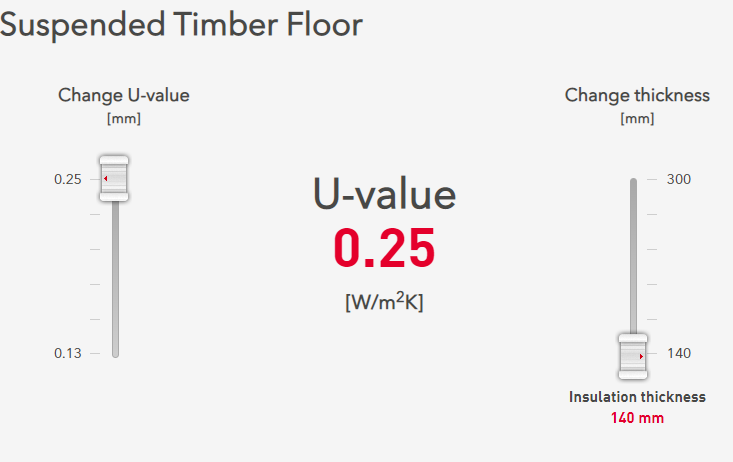

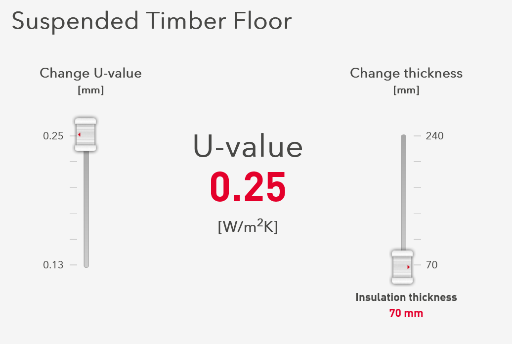

https://bim.rockwool.co.uk/u_value/
I don't know what the P/a ratio is so that might need recalculating
PA ratio for mine is .9 i believe which spits out 140mm rockwool. I think i will juts stick with the 100mm PIR as i have a fair few boards left over from the roof.
