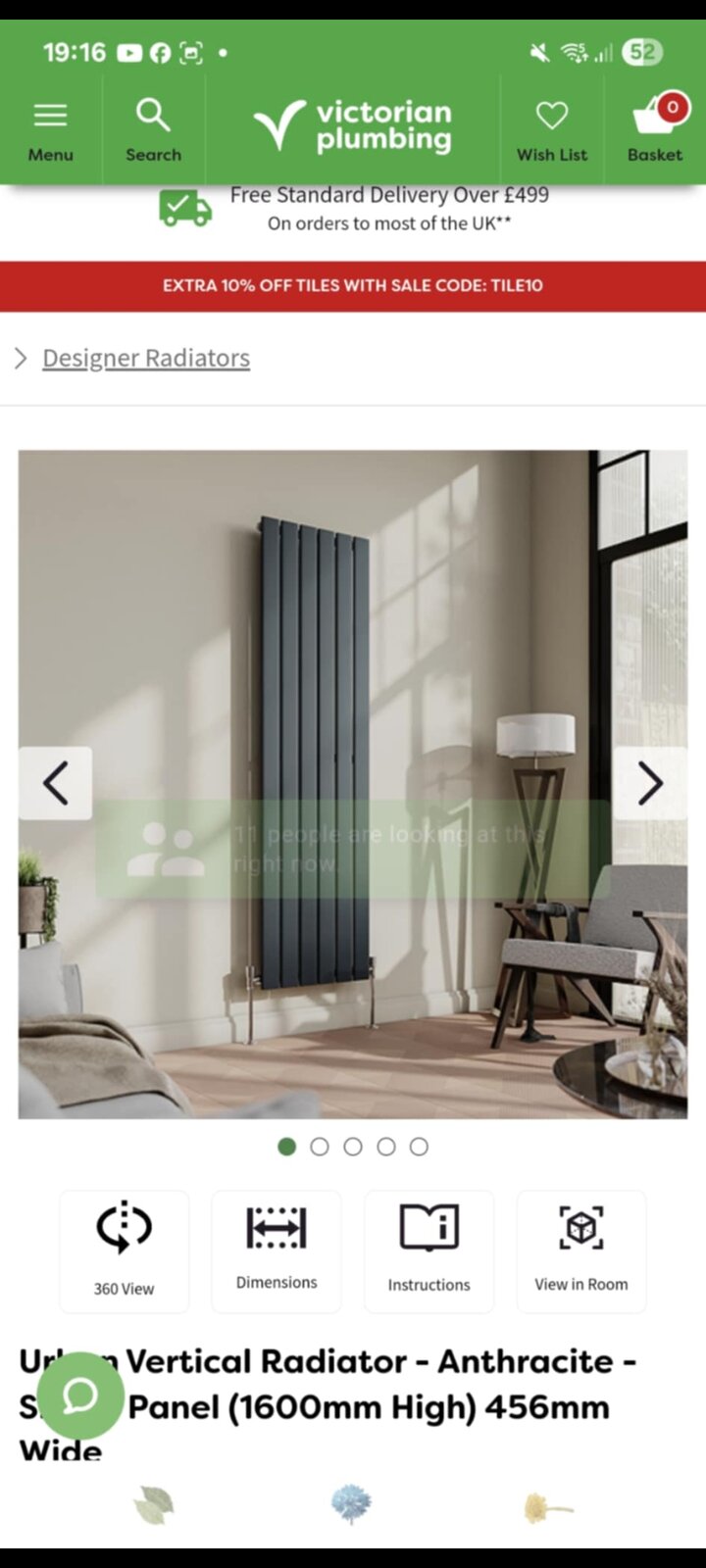

I'll have to work out the rooms heat loss. But is it likely 2 tower column radiators would heat this room. If swapped out the normal radiators
It depends on what the manufacturers states about their heat output and what temperature you intend running your flow at.
Fitting something like this
Thanks yes id have to measure the room and work out the heat loss
And then see what output the column radiators are giving
Yes, column radiators look very trendy but rely mainly on radiation to heat the room. The conventional panel radiators with "wavy steel" behind them or between two panels mainly heat via convection, so warm air continually rises from them. This is more efficent at heating a room.
LOL at wavy steel. I had to think for a minute or so before it dawned on me .. finned convector radiators(y)
It looks like quiet a big room. Main living room.
