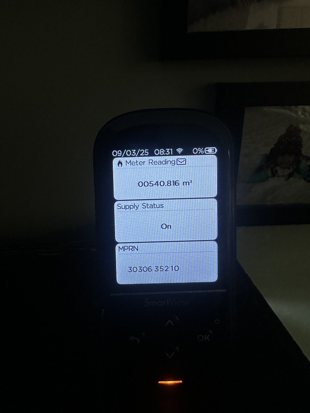

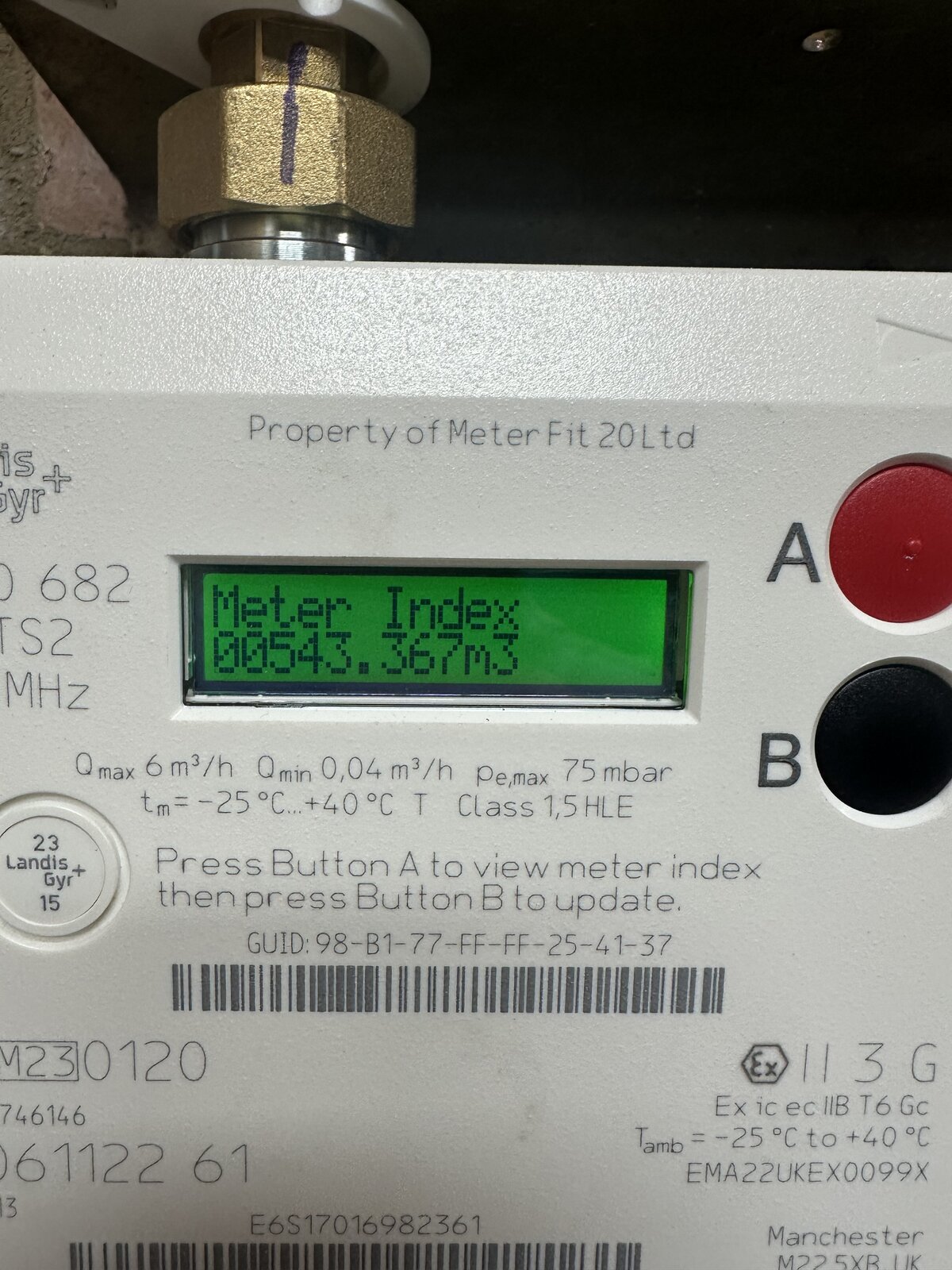

Suggest setting the DHW temp to 60C, open all HW taps and shower, this ensures that the boiler will run flat out, take a photo of the gas meter and exactly (to the very second) take another photo. The boiler output will be the 3 minute gas consumption X 20 X 11 X 0.88 ish, kW
I will do this test today at some point , so take the photo 3 minutes apart ? Just to be clear while the boiler is running flat out ? I’ll report back
Yes, increase the DHW temperature to 60C first and open all HW outlets, including the shower, the boiler will then run at its full output and take those readings exactly 3 minutes apart.

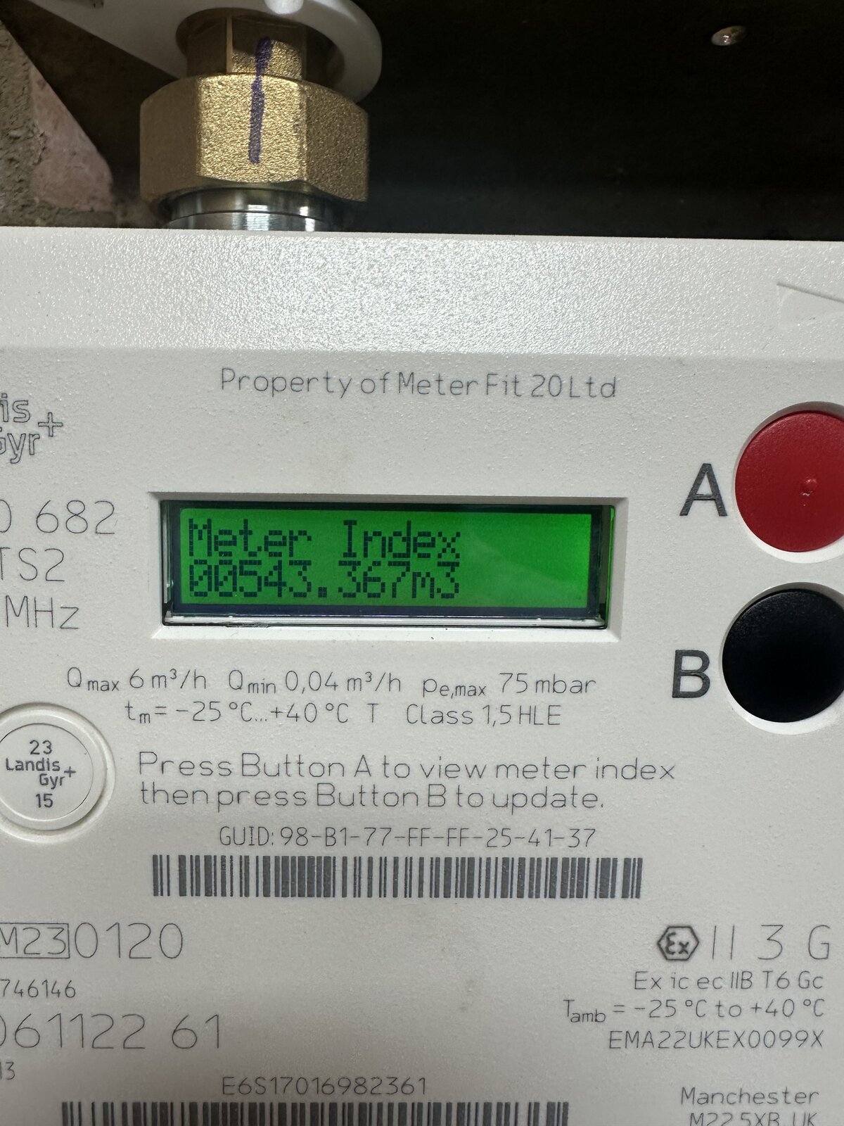

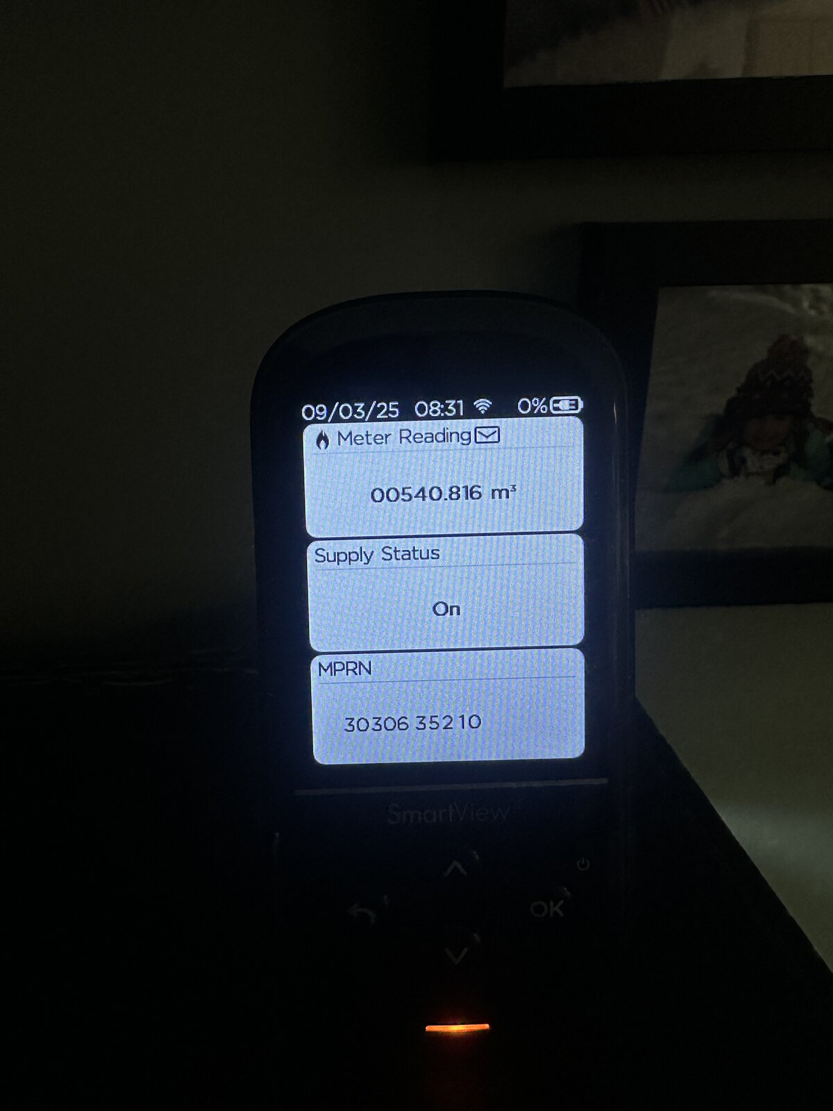

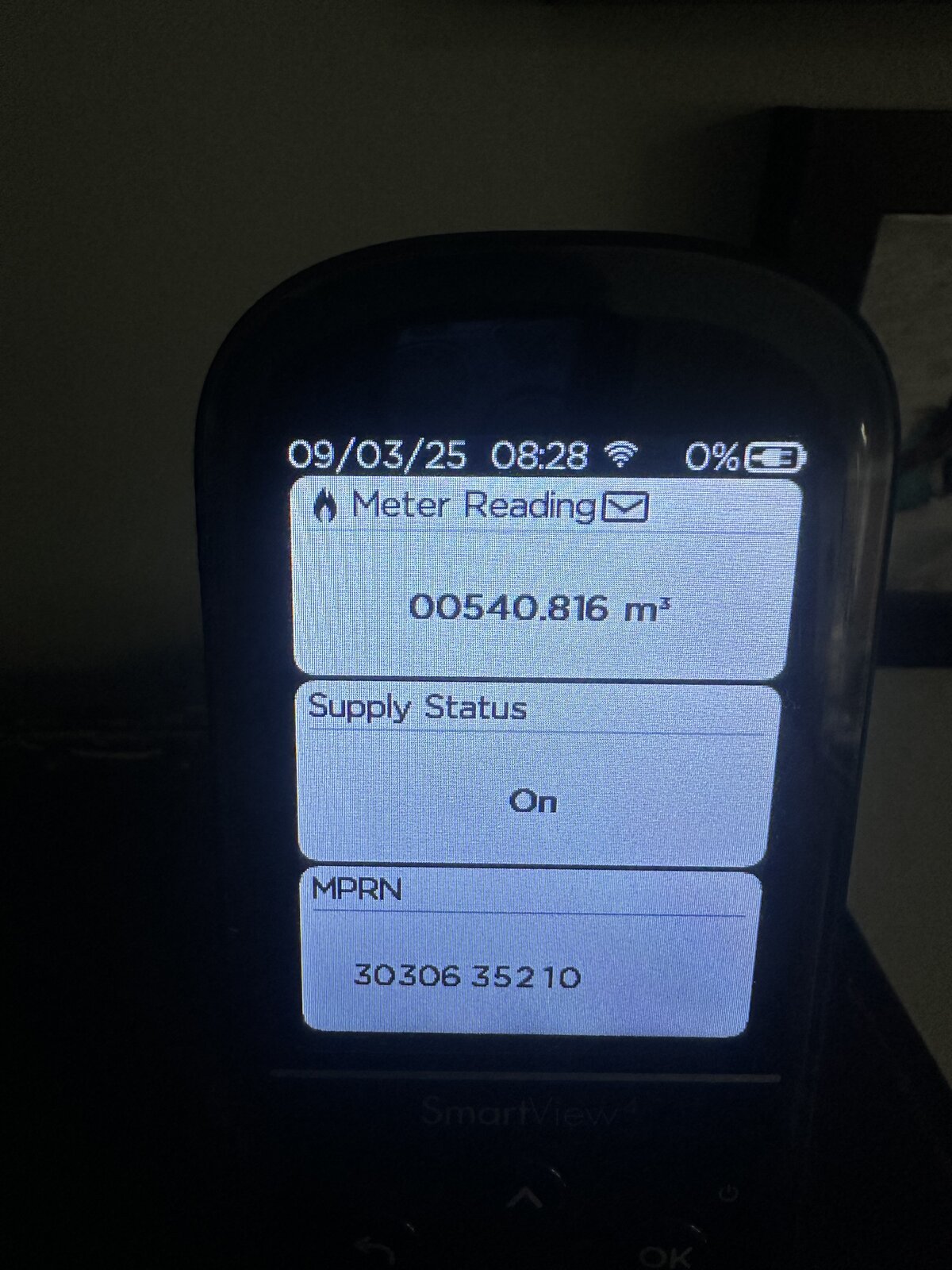

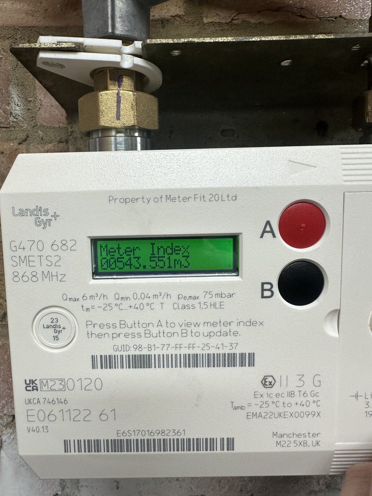

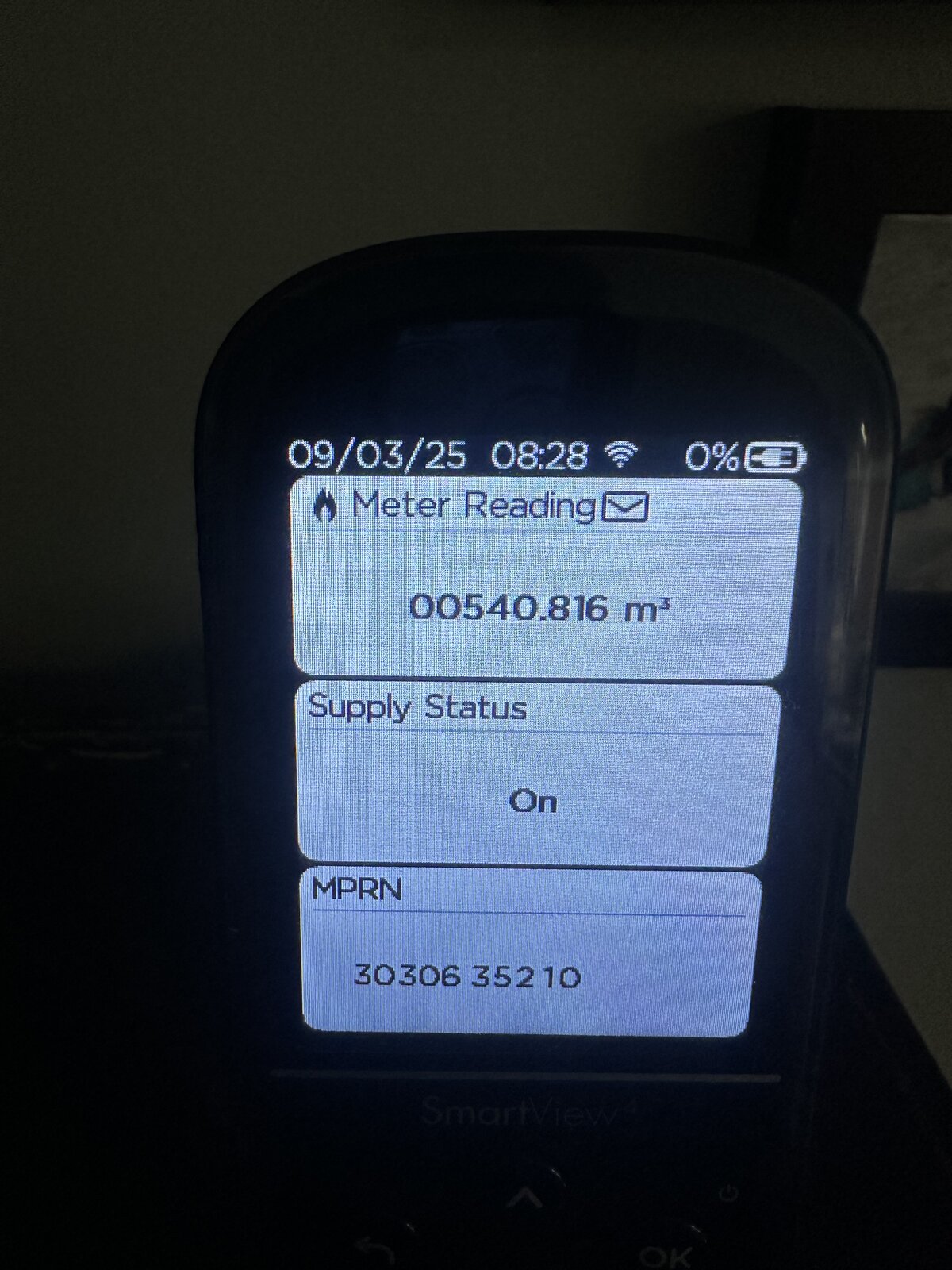

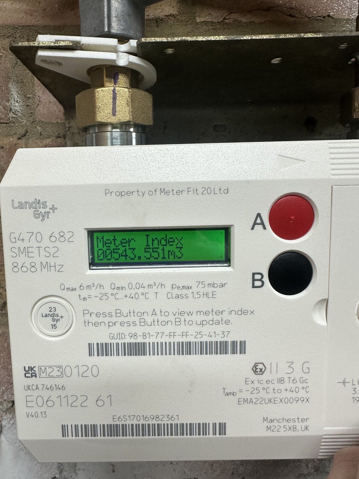

Had all taps running , although they were all weak and luke warm , DHW is already on max setting 60c
Those two meter readings are the same?, you take the first reading with the boiler firing flat out, then, with the boiler still firing flat out, take the second reading exactly 3 minutes later, subtract one from the other to get the 3 minute gas consumption etc.

The shower is not the best , as we were used to a power shower before and yes if someone turns on another h/w tap in the house it’s dreadful . Just trying to achieve a solid hot water system , we about to install an extra bathroom in our loft too not that anyone would shower at the same time.
Unfortunately!!, that equates to a boiler output of 35.6kW so the boiler is achieving its rated output.
Ah thanks I don’t doubt the boiler is not working correctly , it’s great if you live on your own and have a good water supply but we are a busy house of 4 , and used to having a gravity fed system with a power shower
