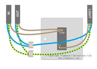

I've always looped at the ceiling but was recently replacing a switch where the loop was done at the switch. In this configuration, is the cable in L1 known as the "Switch Live" and should it therefore have a brown/blue sleeve to denote this like we do when looping at the ceiling?

The 'switched live' is already brown, so obviously does not need brown over-sleeving. Brown over-sleeving is only needed when (as with the switch drop from a 'loop-at-ceiling' rose), a blue conductor is used as a ('switched') live.

I thought that may be the case but also thought that it may need something to distinguish it from the other browns that are permanent lives?

No, the 'requirements' only relate to indicating that a conductor is 'live'/line (of any sort) when it does not have brown (or, in old colours, red) insulation. One is, of course, free to mark/label/oversleeve it in some way to identify it as a switched live. On the fairly unusual occasions on which I think this might be useful/helpful, my personal habit is to use a small bit of yellow sleeving for the S/L, but that's just me.

What purpose does this serve. You sleeve the blue conductor, when it is the S/L to show it is effectively a brown conductor. When looping at the switch the S/L is already brown. Brown sleeve on a brown conductor is redundant. Blue sleeve on a brown conductor is wrong, as blue signals a neutral conductor.

As has been said, you could with brown, but not blue - since it would not be permissible to put blue sleeving on a live conductor. However, even if the brown sleeving on a brown conductor was 'noticeable', it would have no meaning to anyone but you.
If you really want to identify one of the browns as being a 'switched live', in a manner that you (but no-one else) would understand (if you remembered), you could just tie a bit of cotton or thin string, or something like that, around it - but I really doubt that there would be much of a point in doing that.
