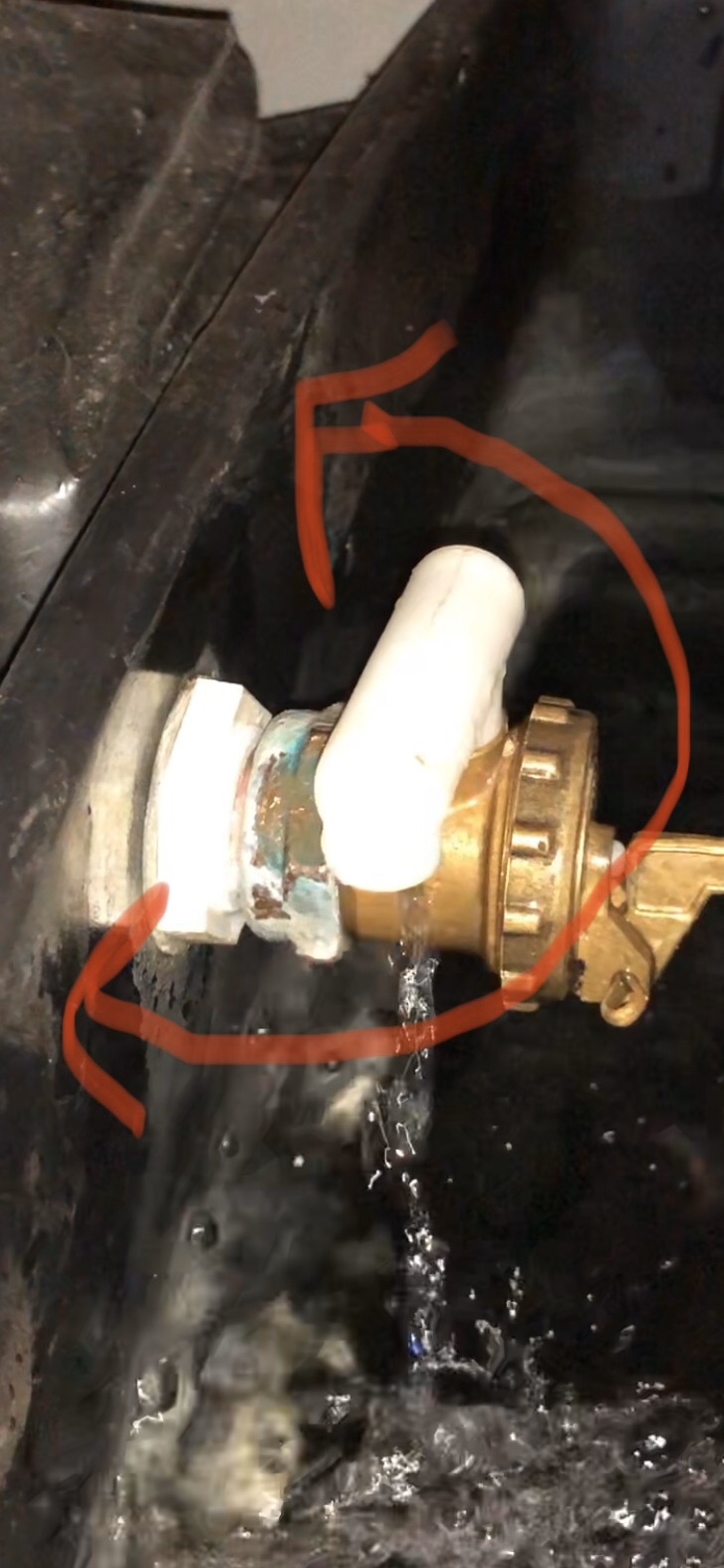

Hi
so had the floating valve replaced in my loft tank, the plastic spout thing that the water shoots into the tank out of is screwed into the assembly but it’s spins freely when the pressure of the water shoots through it
I’ve tried to tighten it but when it reaches its tight position it’s pressing against the wall of the tank
I’ve checked the one in the radiator header tank and the spout is firmly in place
should I be concerned ?
Yes, as it might come off and water will hit the tank lid and could overflow the outside of the tank, causing water damage to the ceiling below.

When it spins it can’t fully rotate as it hits the wall of the tank
Undo the plastic nuts either side of the tank and move the fitting in, this should allow more room to rotate the plastic spout.

I’m able to rotate it fully if I apply a bit of force but when it’s tight it’s pressed against the tank, I’ve removed it and put it back on thinking that it will end up in a different location when it’s tight but at its tightest point it’s always pressed against the tank
Ok, as long as it is tight and in the correct position. It doesn't have to over tightened.

Ok so the plastic tap spins freely in both directions as shown in photo, if u turn the tap to tighten it it tightens but the tap is then pressed against the wall of the tank

That part of the fitting shouldn't tighten, it should be able to rotate freely inside the fitting, it's just the flow diverter. They're usually just push clipped into the valve.
Ok so my mate had a spare plastic spout, looks exactly the same so screwed that one on and it was a much firmer fit, felt firmer when screwing it on so it’s now firmly in position
