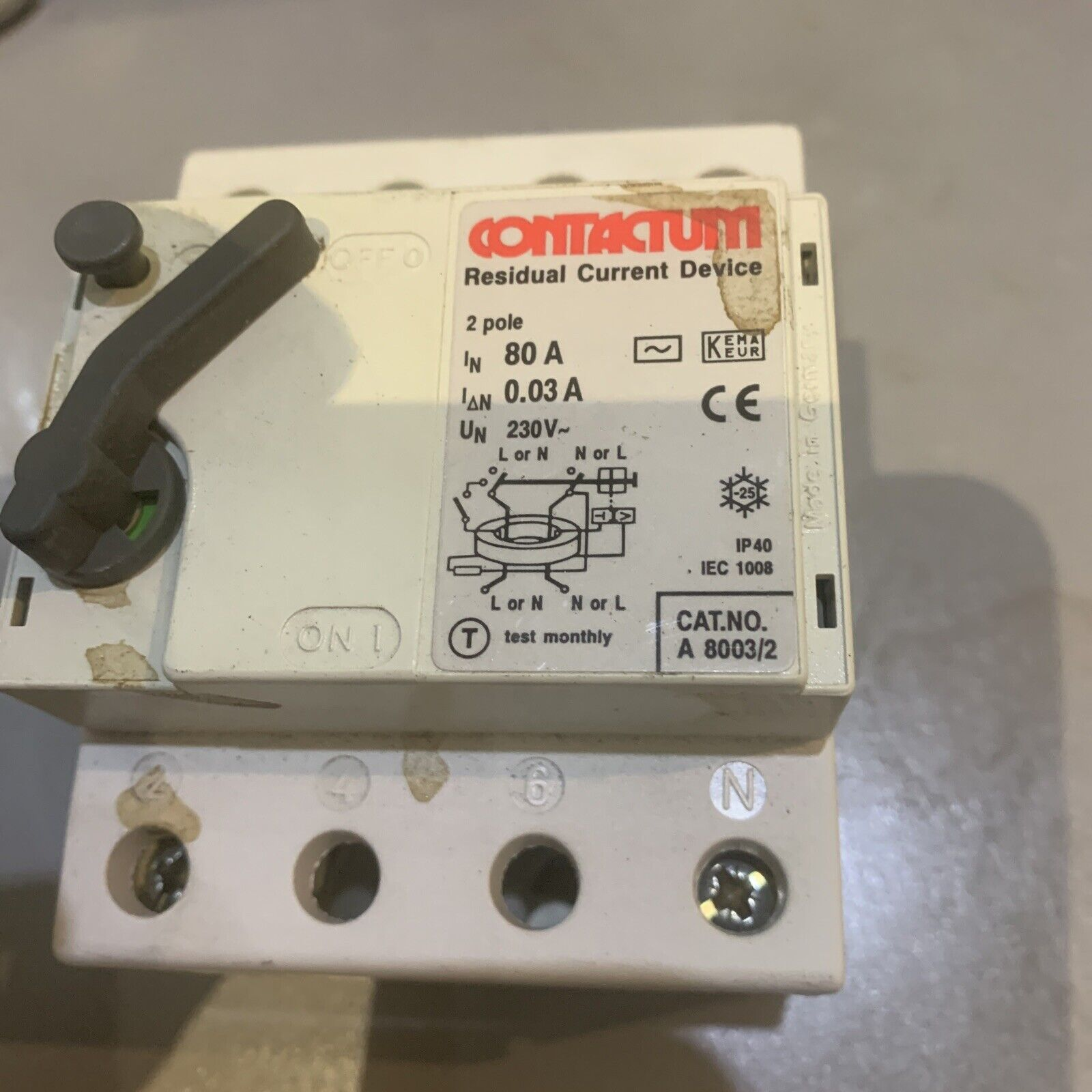

Something like this?
The device made by Fanex occupies 5 units in an enclosure. (I'm annoyed I didn't take pics as there was a bit of a panic to get running and a web search doesn't find it) It has a 'rotary' lever very much akin to the original RCD's and marked '0' & '1', this gives a basic idea but looks nought like it:
and grey 'test' & green 'set' buttons.
Written instructions (magnifying glass required) say to switch on (it toggles with a clunk and power gets through) and hold then press green button. When both have been done the window goes black (it also works to press green then switch on and actually feels more positive that way). Green button mechanically holds lever on but releasing green button releases the lever.

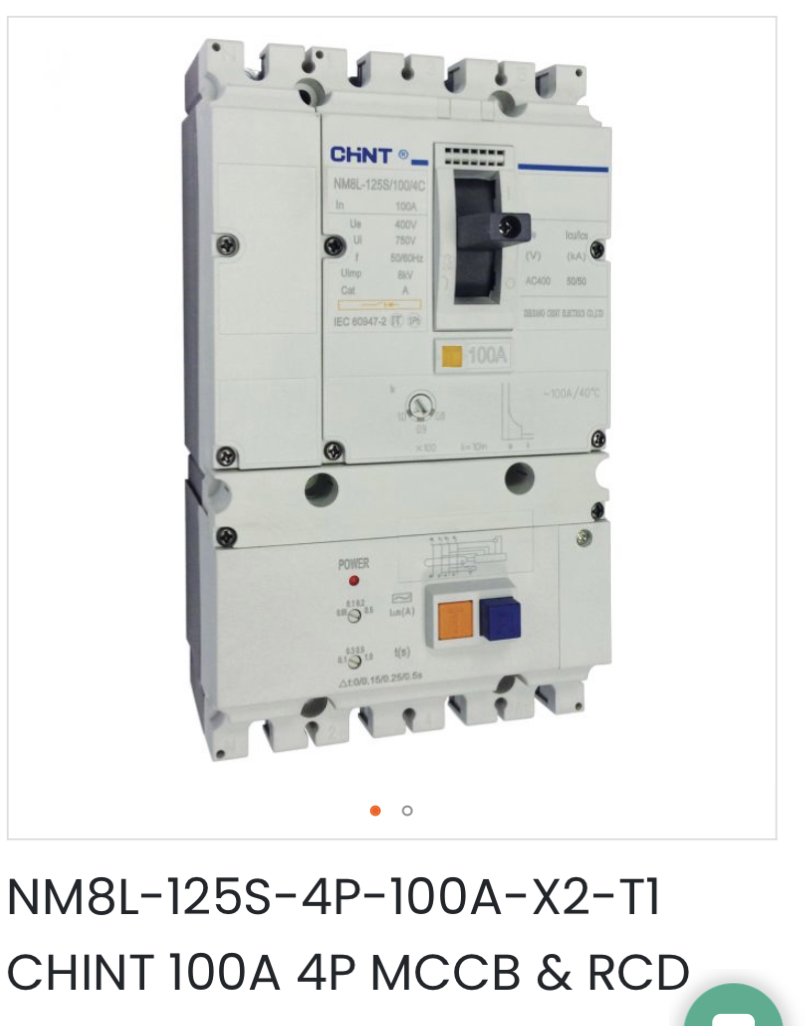

I don't know the Chint unit but other similar devices I've encountered are basically an OCPD plus passive RCD bolted together.
This device is interlocked.
Did the 4 pole device trip / not reset if it detected significant un-balance on the 3 phases it was monitoring ?
If that is the case then with load only on one phase the device would determine the load ( 3 phase ) to be un-acceptably out of balance
