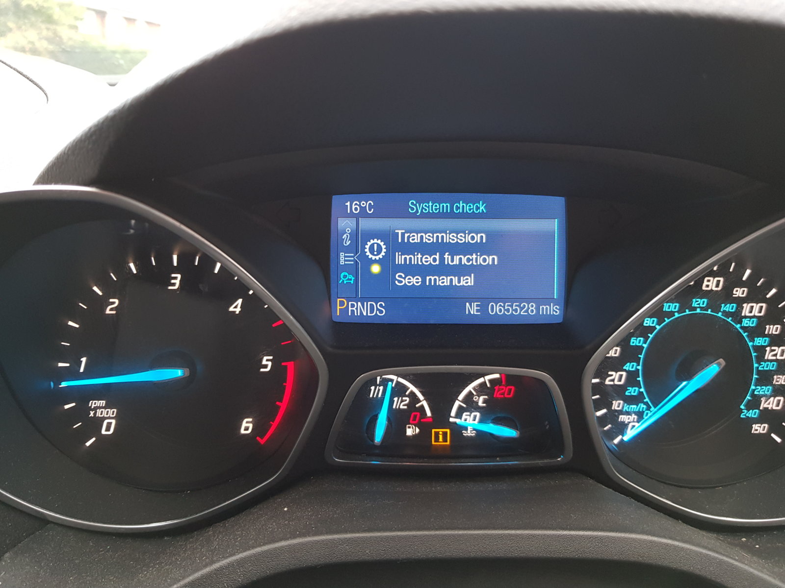

Wife rang me up at work saying the car was playing up (Mk2 Kuga Powershift).
Got home and managed to get it to fault again.
Managed to pull code P0766, shift solenoid D stuck.

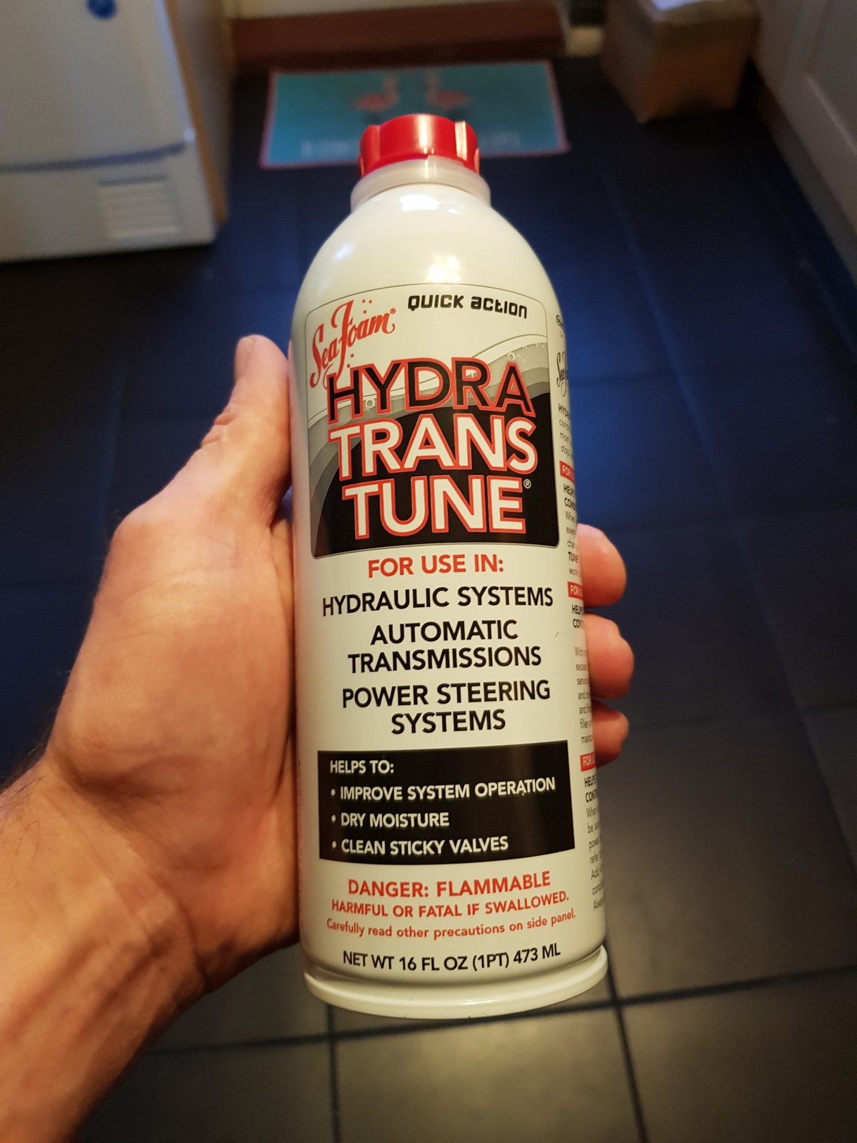

Well I'd ordered some snake oil to try and clean the valve body/ mechatronic unit (common fault and £1500 for it!).
Already resigned myself to either stripping it myself or farming it out..
My flushing oil was 5.5l twin clutch oil and 700ml of Seafoam Hydra Trans which I added tonight, new oil filter.
Warmed it up on the drive and still cluncking into gear and Transmission Limited Function kept popping up.
Went for a drive round the block and it sounded like gearbox was going to fall out/ harsh shifting, then lost all drive and it went mental. I genuinely thought at this point it was game over for the 'box!.
Restarted and limped it back onto the drive and had codes for 2 stuck solenoids now, worse than when I started..

I am truely amazed at what this Seafoam has done and I was ready to spend ££ getting it repaired (wife uses it for work).
Think I'll keep this oil in for 500/ 1000 miles and then flush it again for good measure.

Will be adding a bottle of this to every change from now on and go from 37000 mile intervals down to 20,000.

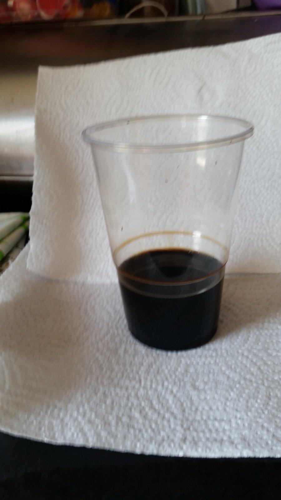

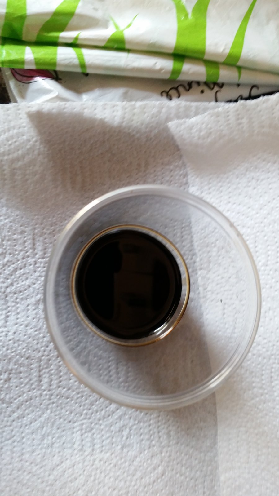

I did a gearbox service on ours just after I bought it, should have only been 13,000 miles old (full service history).
Didn't look like 13k old oil!.
