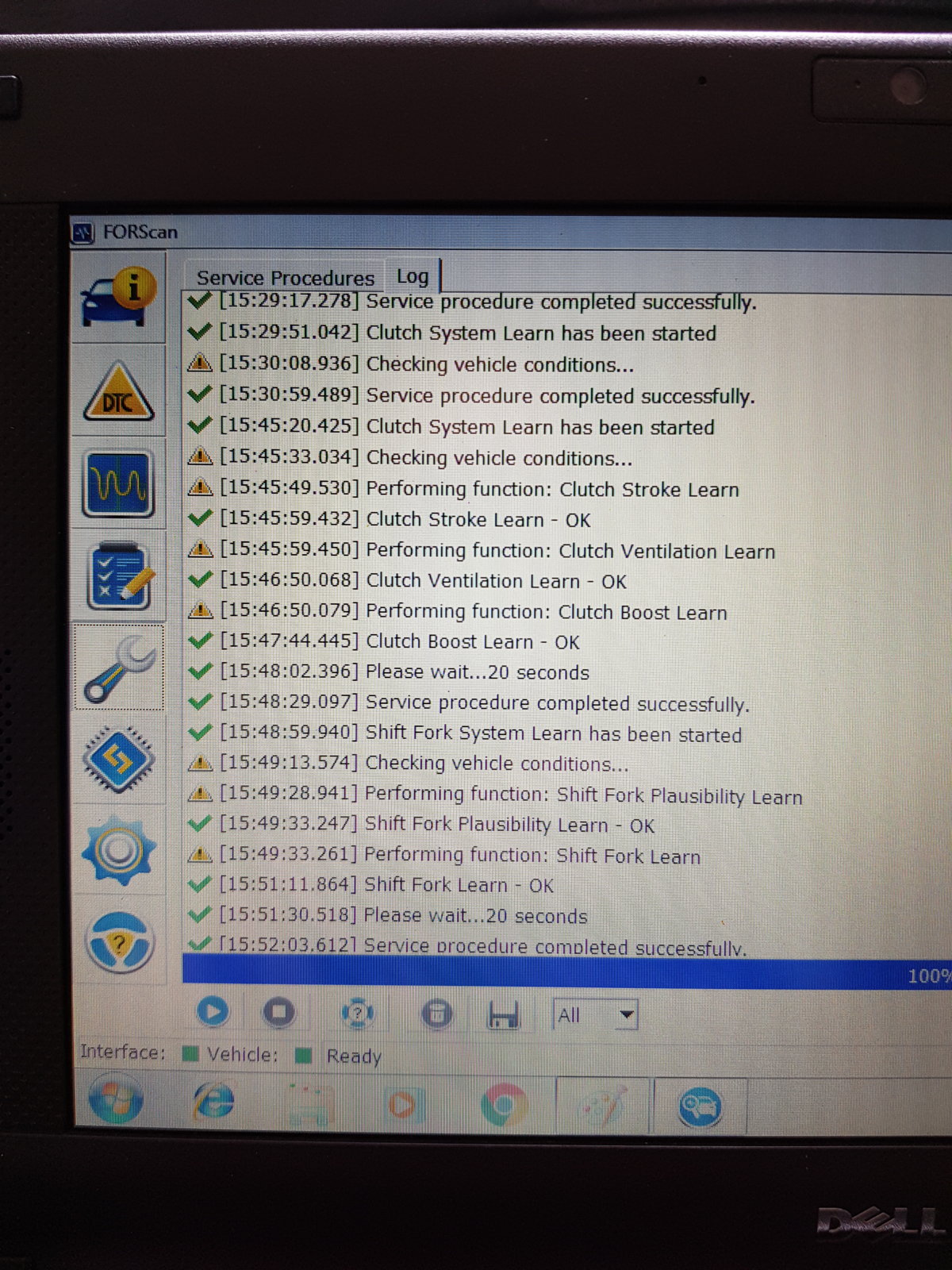

Car wise I did a Gearbox TCU reset, clutch and shift point relearn (with FORScan). I replaced the oil filter only as well xxxx. The TCU had not stored any error codes this time.
Drove the car and couldn't get it to fault.

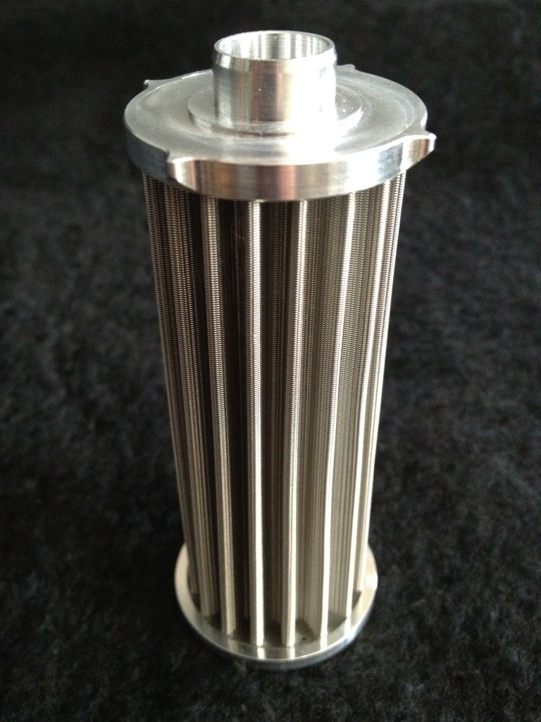

I've got a Stainless Mesh filter coming from Australia of all places, cost an arm and a let but I believe the paper/ poly gauze filters are causing an issue.
At least with the Stainless Mesh I can see exactly what it looks like, and its cleanable so filter for life (lol).

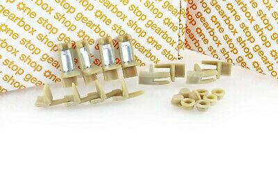

Pit a picture up of a new plastic spring guide kit as well for amusement..

That filter - is it a pre main filter unit or on its own? I would think you would be dealing with micron size particles and have never seen a washable oil one!

It's a 30 micron washable external filter.
There is a pre pump filter but that requires the gearbox casings split to replace it!. Shocking really.
